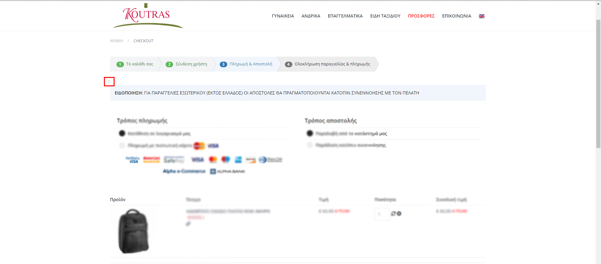

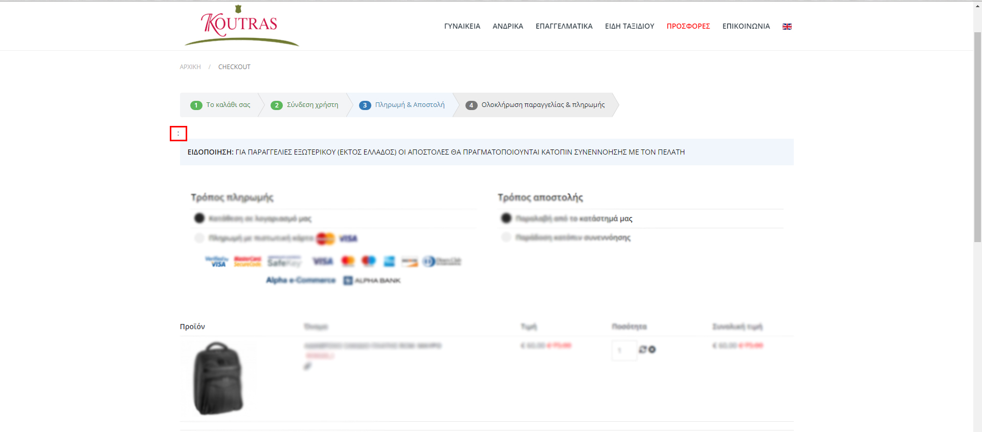

-- Joomla version -- : 3.9.27
Hi!
There is this symbol ":" in user custom field label, i removed the label with css but the symbol : is still there and i have no idea how to remove it too.
Thank you
