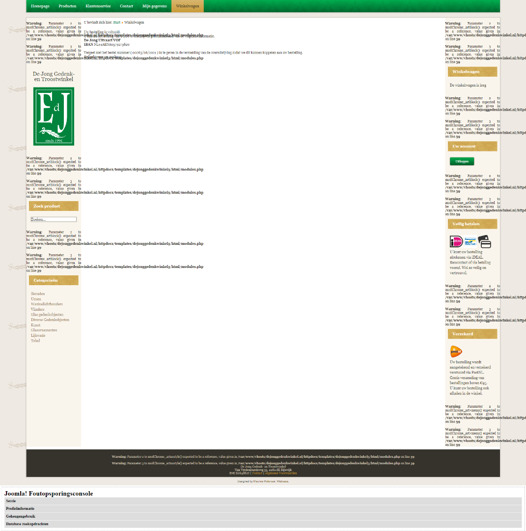

With error debug set to maximum I do see the same a warning within the module positions. Don't think this has something to do with the issue at hand.

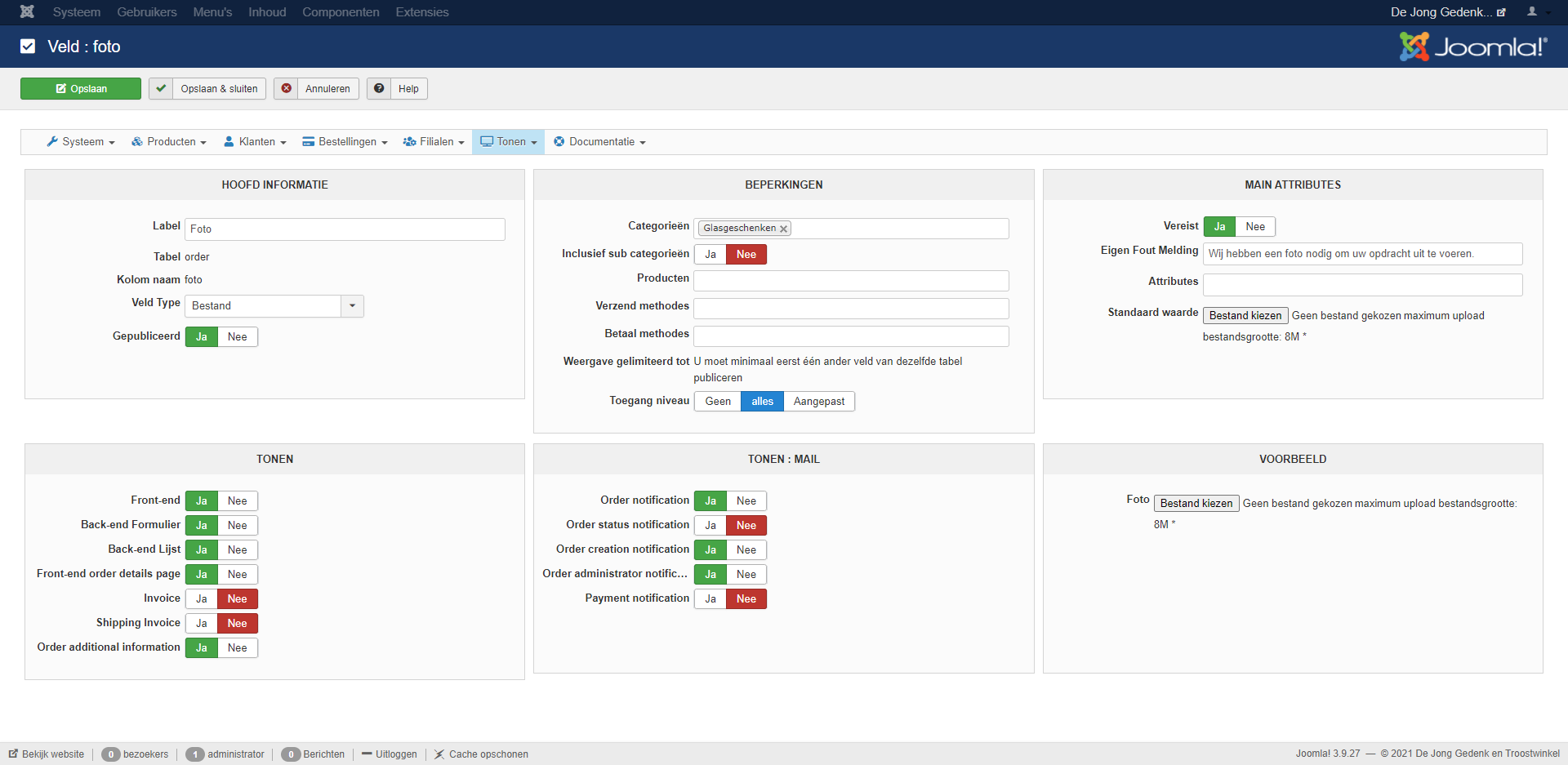

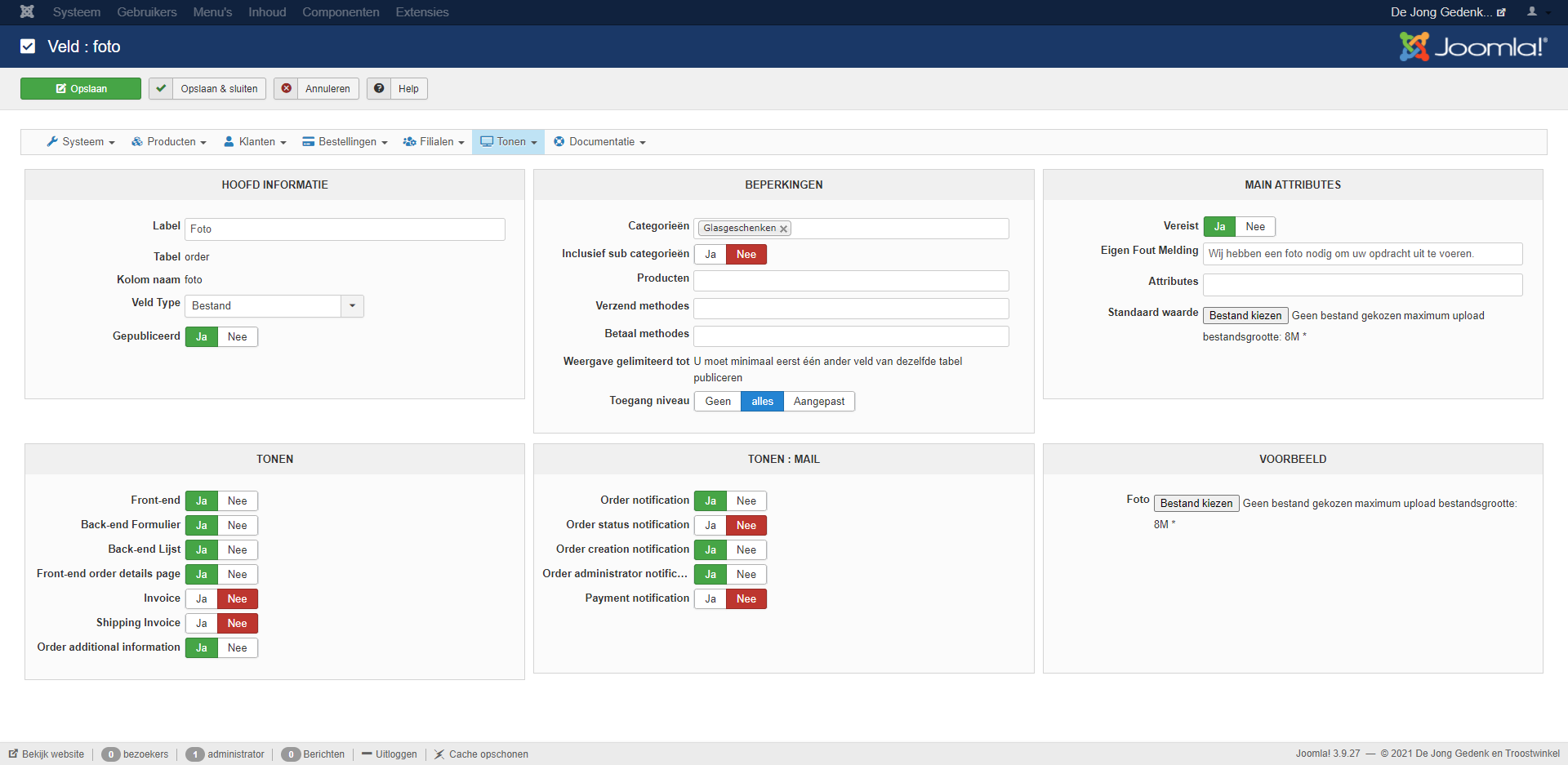

  1. Please see attachment: 1-order-custom-field-type-file.png

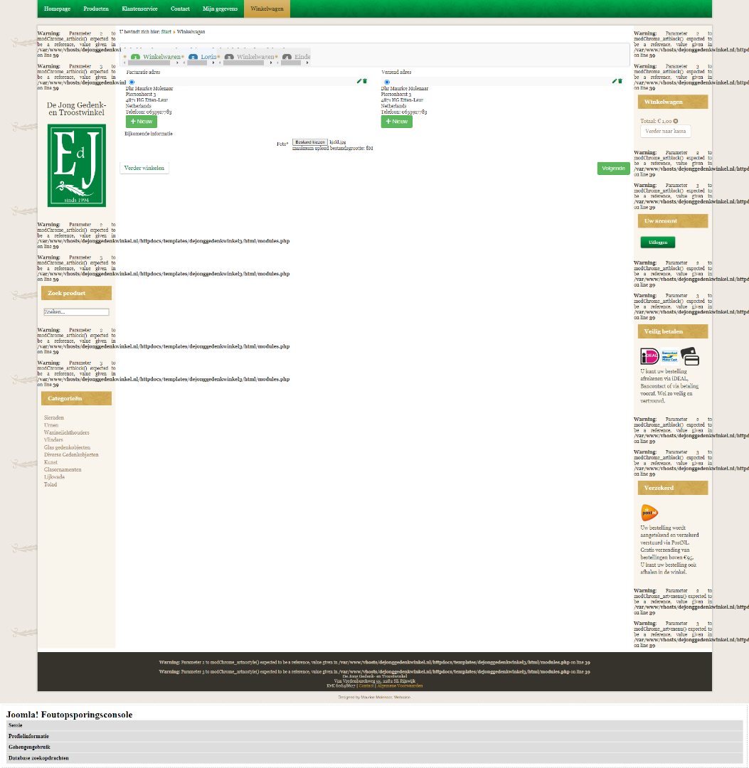

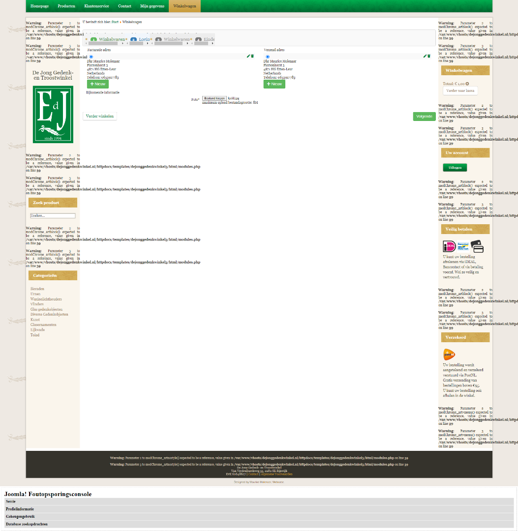

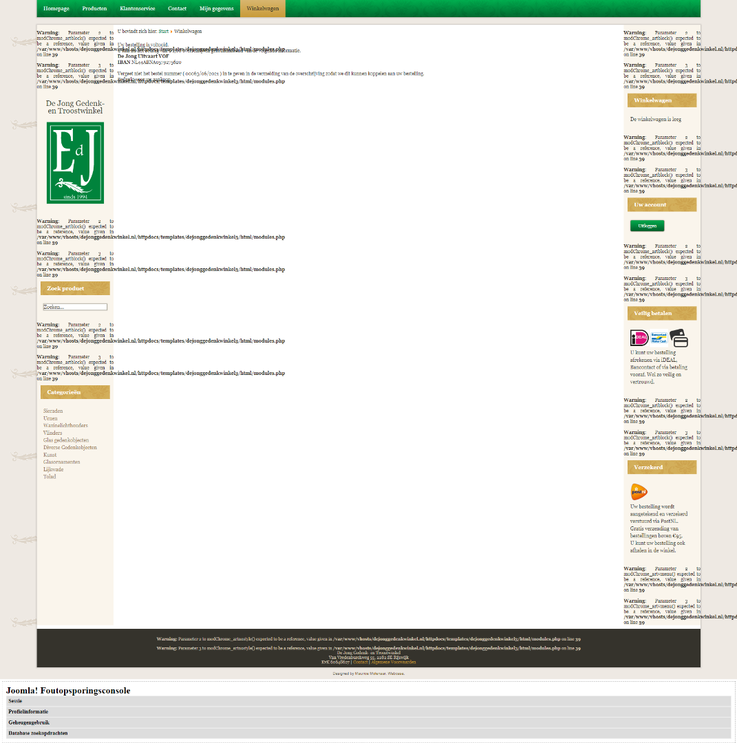

    A. place item in cart > then go to checkout > in checkout step 1, choose a file to attach to the order (attachment: checkout-step-1.png

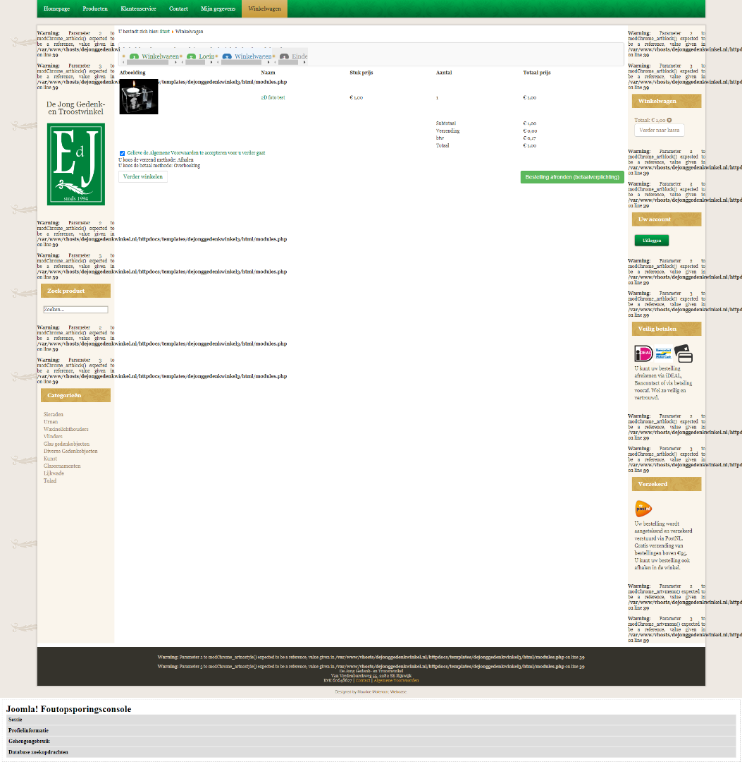

    B. Confirm the order (attachment: checkout-step-2.png)
    C. See the confirmation page (attachment: checkout-step-3-confirmation.png

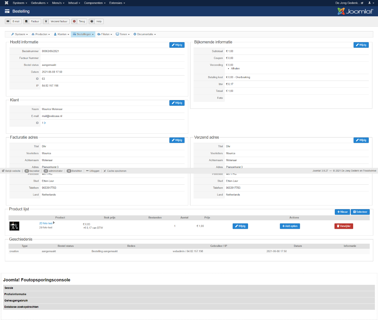

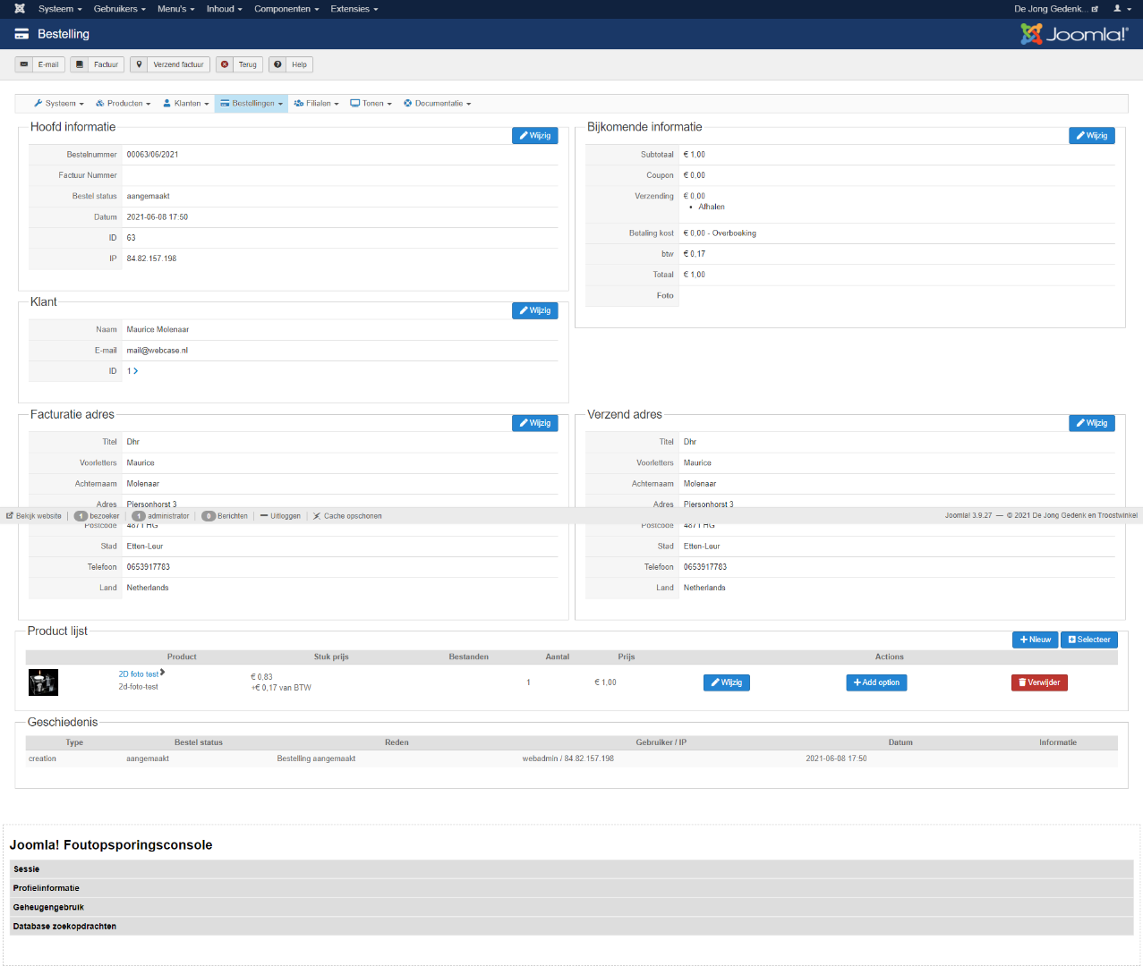

    D. When I inspect the order in Hikashop, there is no file present (attachment: order-without-file.png)
