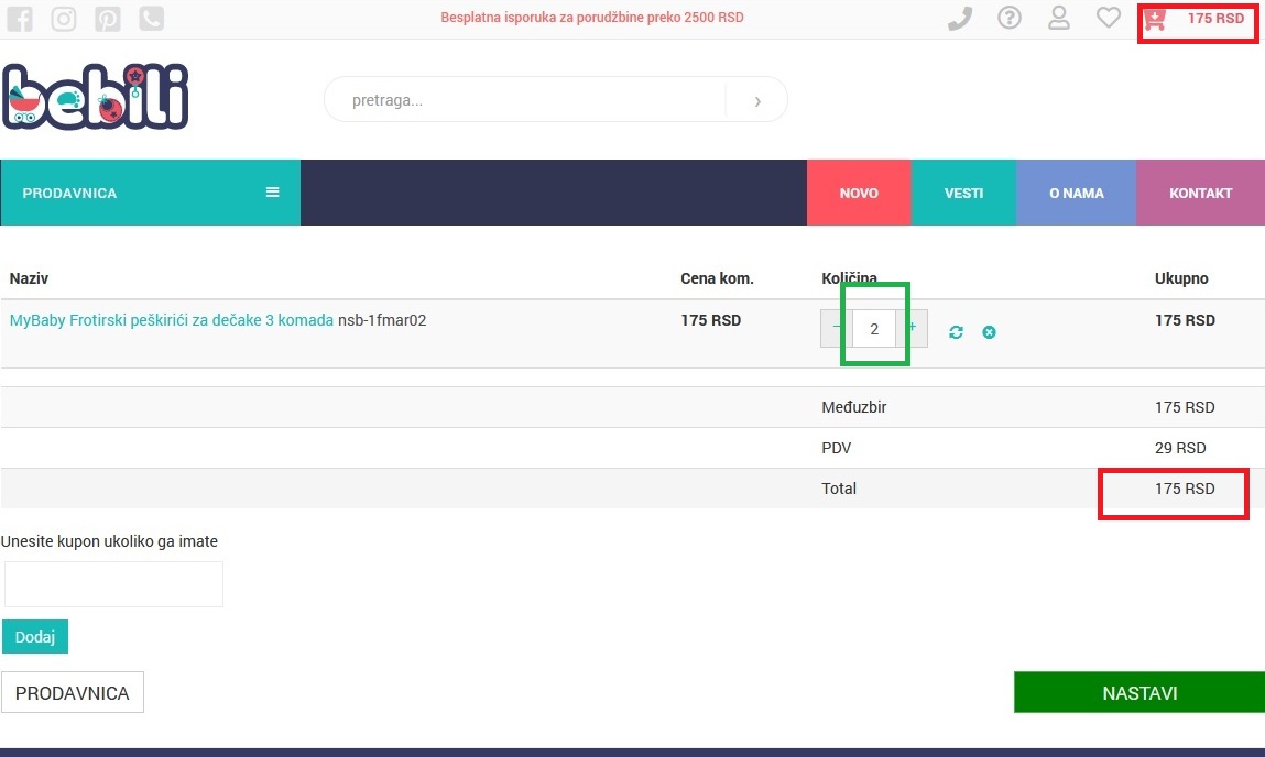

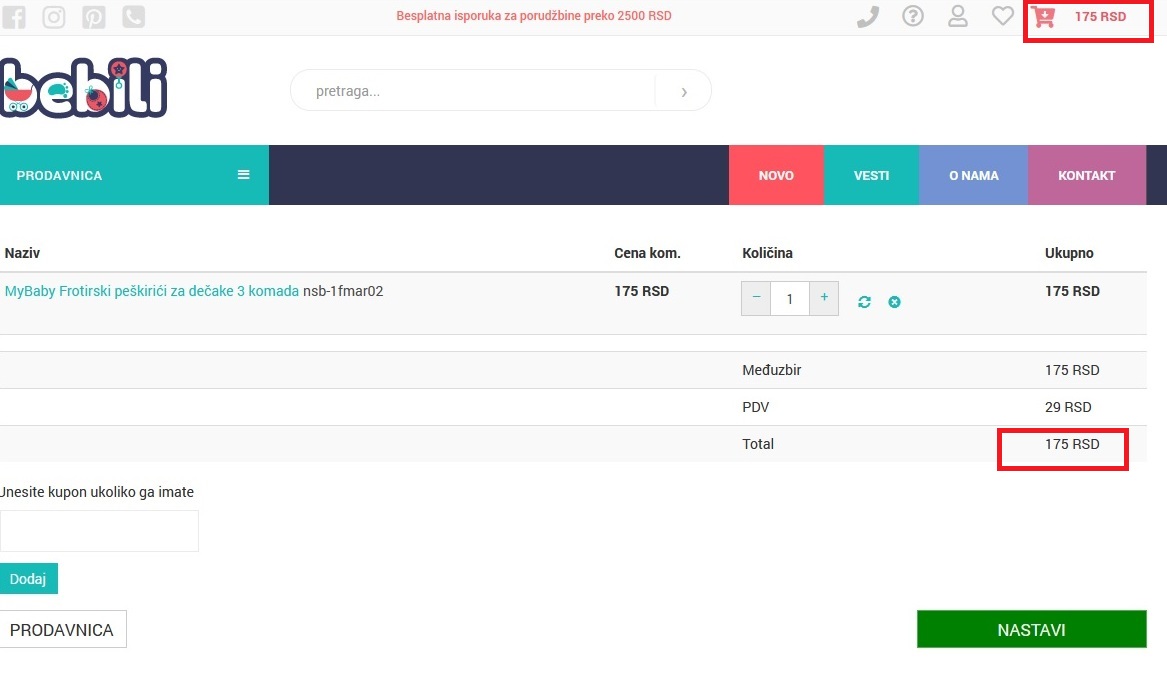

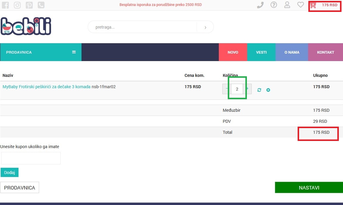

For example:
1. Adding MyBaby Frotirski peškirići za dečake 3 komada quantity 1 into cart
2. You can see picture called "Before" how it looks like. Amount in cart is 175RSD
3. Then, increasing quantity on 2. Amount in cart (in red rectangles) should be updated on 350RSD, but it isnt. I need to use refresh button or proceed button so cart can be updated. Check picture "after".
Totals in cart arent automaticly updated when u increase quantity with +/-. I removed overrides (check post before).
