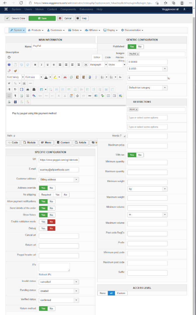

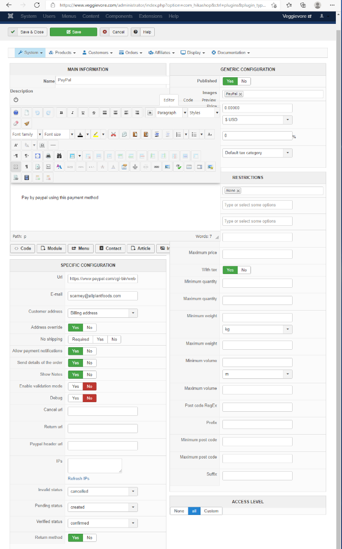

I have two methods to purchase. One is Braintree which is working. The other is PayPal which is not doing anything at all.
I am wondering if you might know why PayPal stopped working? Have there maybe been some changes to PayPal configurations?
Thanks for any pointers in the right direction.
Sean
Last edit: 4 years 11 months ago by scarney. Reason: Adding an image for the PayPal Configurations

Can you give us more information through some screenshots for example about what you exactly mean by "PayPal stopped working" as your payment method seems to be correctly configured ? Thank you.

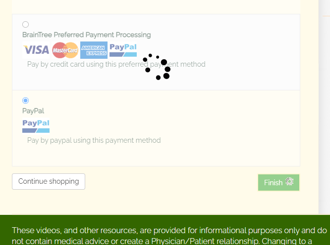

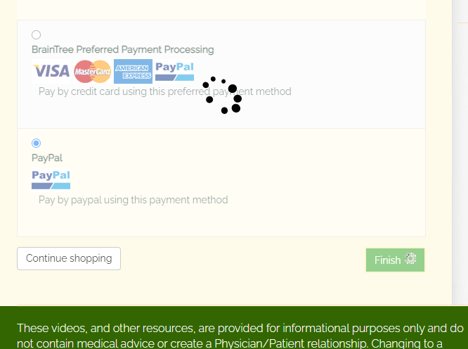

Thank you Mohammed. It is pretty hard to give you a screen shot that is meaningful because basically nothing happens. But, there is a slight display of a whirling icon that spins but does nothing. I have attached a little screen shot of that.
I hope this helps. Basically I try to check out and select the option for PayPal instead of the option for Braintree. The Braintree options is working properly.

So you mean that when you click on the radio button for the PayPal payment method it works fine. However, when you then click on the "finish" button, you get the whirling icon and it then redisplays the checkout page without any error message.
What if you disable the Braintree payment method ? Do you still have the issue with the PayPal payment method ?
If yes, then I don't know what it could be. I've never seen the PayPal plugin refusing the checkout completion anywhere. Maybe a custom plugin acting strange could be the reason ?
If no, then I suppose that it's linked to the Braintree payment plugin not accepting the order creation because its credit card form is not filled in even though it isn't selected as payment method, or something like that and so in that case, you'll probably have to check with the developer of the Braintree plugin.

You were correct. And your idea to disable the braintree plugin was the right solution. At that point PayPal started redirecting properly. I have submitted a ticket to the developers of the Braintree plugin and then are going to try to fix it.
