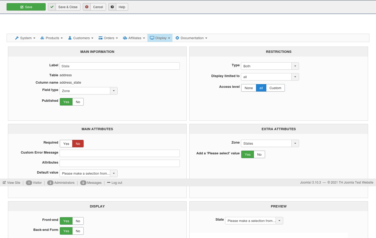

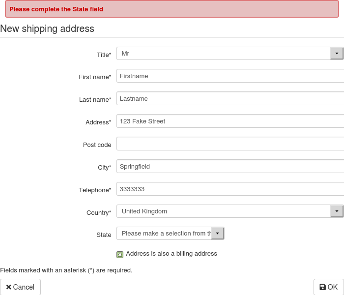

-- HikaShop version -- : 4.4.4
-- Joomla version -- : 3.10.3
Since version 4.4.3, I think, the state field has been mandatory on the checkout even when it is not set to required.

Thanks for the report.
I was able to reproduce the issue on my end.
It's because the "please select" choice is not properly taken into account.
Add the code:
if(!empty($field->field_options['pleaseselect'])) {
						$states[''] = '';
after the line:
$states = $countryType->load();
in the file administrator/components/com_hikashop/classes/field.php and it will fix the problem.
We'll add the fix on our end for the next version.
