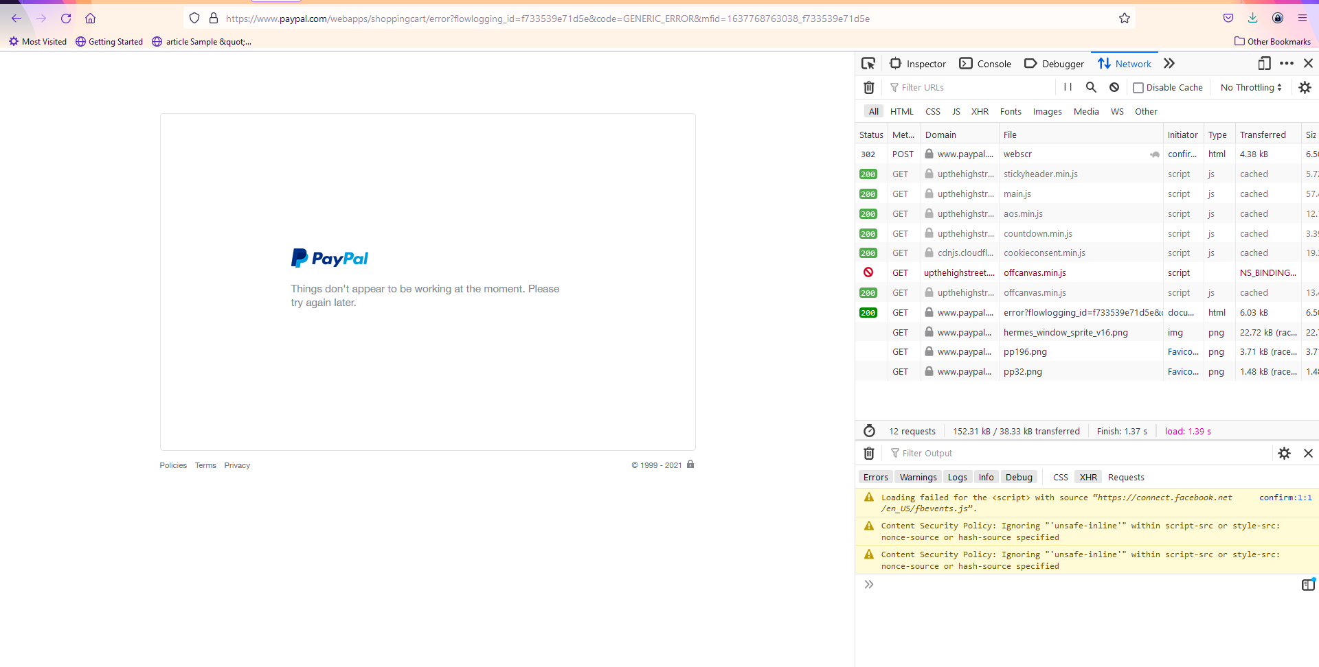

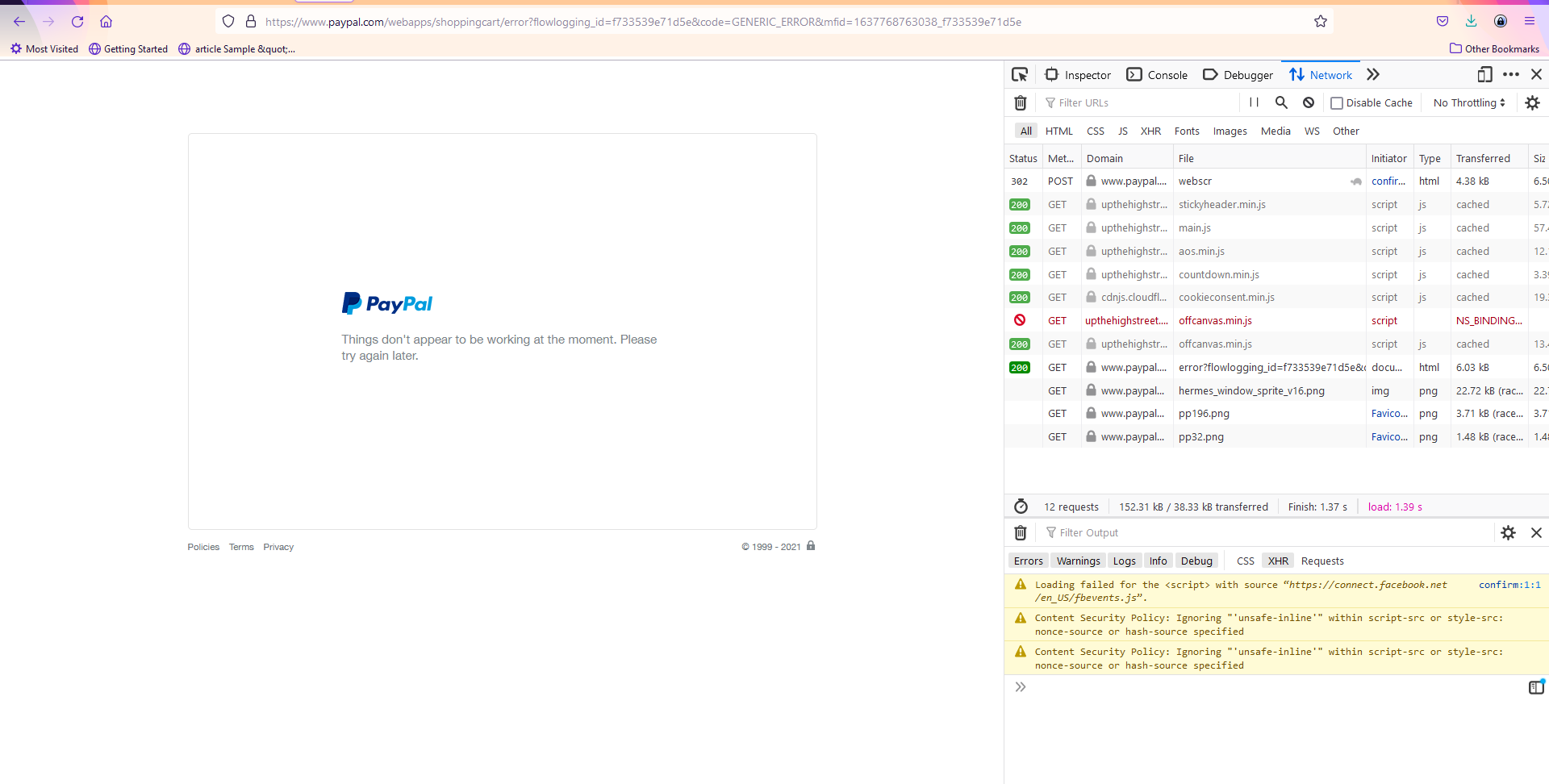

  • Posts: 16
4 years 9 months ago #337368
i have activated your account.
When you click on process payment(finish). When redirecting to paypal is where things are broken. You should be able to test now with the user you created.

  • Posts: 86212
  • Thank you received: 14221
4 years 9 months ago #337371
Thanks, I was able to login now.
However, I still couldn't finish the checkout.
I got an error with no shipping methods found:
i.imgur.com/Eu9vkQU.png
I'm not sure why as I've even tried using a real address.
Thanks for the screenshot. This is a generic error message saying that something is wrong with the data sent to PayPal. But it's hard to say why exactly just like that as PayPal doesn't provide details on the issue.
There are two things you can do:
- activate the "debug" setting of the PayPal payment method and try again.
Then, check the "payment log file" under the main tab of the HikaShop configuration. You'll have debug data displayed which will help us understand what's wrong as we'll know exactly what was sent to PayPal if you provide the logged data.
- contact PayPal's merchant tech support and ask them to check their logs for your merchant account so that they can tell you what is wrong with the data sent to PayPal. They'll be able to say directly what is the problem. But the hard part will be to get in touch with someone helpful on their end.
  • Posts: 16
4 years 9 months ago #337392
Your response has thrown up more questions than answers. I'll go through fixing the initial issue first though.
i can't find a log section. i have enabled the debug within the payment plugin.

  • Posts: 16
4 years 9 months ago #337794
Thank you for your help. i figured out the paypal issue. When sending certain variables to paypal. that would trigger the problem.
