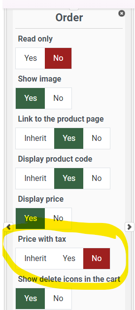

4 years 6 months ago #339861

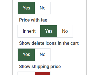

Yes, in the HikaShop configuration, under the Checkout tab, you have your checkout workflow.
There, you have the "cart" view settings. And among them you have the "Price with tax" which allows you to display these two prices either with taxes or without taxes.

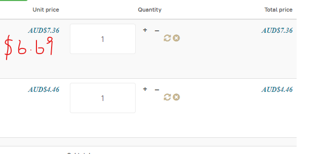

  • Posts: 135
  • Thank you received: 5
4 years 6 months ago #339879
Thank you, yes, yes I had the option turned on, that's why I came to you to see if there is another way!
So with it turned off I get the unit price.
When I turn it on, I get the Unit price with Tax, I want the unit price $6.69 and not $7.36 and the total Price $7.36 (incl Tax).
Does this make sense?
Mark

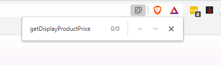

  • Posts: 135
4 years 6 months ago #339918
Nicolas,
This line "echo $this->getDisplayProductPrice($product, true);" is not in my checkout show_block_cart code?
Mark
  • Posts: 86212
  • Thank you received: 14220
4 years 6 months ago #339923
First, beware that your browser search might not be able to search inside the code editor.
So your screenshot doesn't prove that the line of code I'm talking about isn't in the view file.
Please check manually.
If you really don't have it, then it means that you have an old view override of show_block_cart on your website and you would have to delete the override to redo it with the latest version of the view file.
  • Posts: 135
4 years 6 months ago #339943
Nicolas,
The search function works fine and fines anything inside of the code editor.
This is a new installation of HikaShop Business and there have been no changes edits to any of the display files only have made custom fields.
I have attached the code of the show_block_cart.
So what now?
Mark

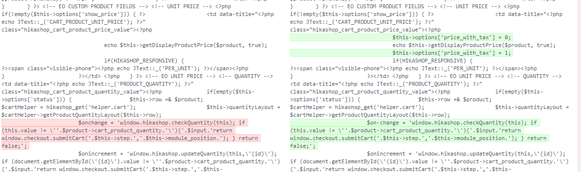

  • Posts: 86212
4 years 6 months ago #339955
I do see the line I'm talking about in the file you provided:
i.imgur.com/G4IcURg.png
The following user(s) said Thank You: markfell

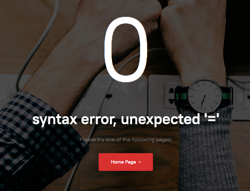

4 years 6 months ago #339972
Please accept my sincere apology for not looking through the file before sending it.
Ok I have modified the file, selected a product with tax to the shopping cart, gone to finalise my order and get a syntax issue.
Please see attached.
MSF
  • Posts: 86212
4 years 6 months ago #339980
The error is not with the code change I provided.
It's with the other line that has been changed.
As you can see in your first screenshot, the variable $onchange has been changed to $on-change and that's why PHP is giving you that error.
This is probably done automatically by a security extension you have installed on your website which does that to prevent potentially hacking attempts. So I would recommend you check with the support of that extension what can be done so that it doesn't interfer with that area of HikaShop. The simplest is to temporarily deactivate that extension when you're changing code in view overrides.
  • Posts: 135
4 years 6 months ago #339987
Thanks Nicolas,
Found it, RSFirewall does a check on updated php files :)
Great wonderful support as usual.
It works prefect now.

  • Posts: 86212

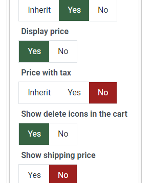

4 years 5 months ago #340382
Go in the HikaShop configuratoin, and under the Checkout tab, in the settings area of the "cart" view, turn off the "show taxed prices" setting.

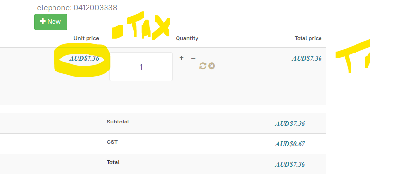

  • Posts: 135

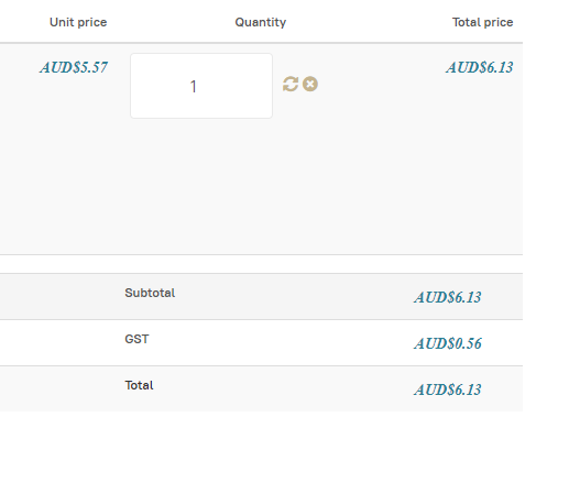

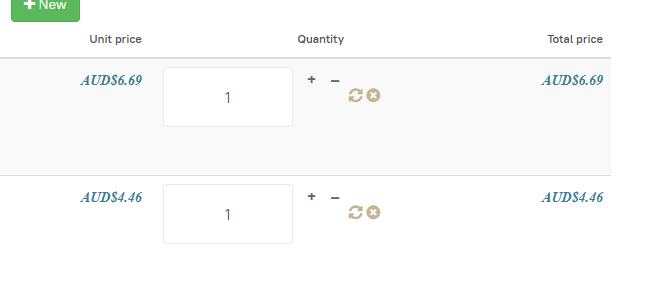

4 years 5 months ago #340476
Have set as suggested and still didnt work?
See attached
MSF
Last edit: 4 years 5 months ago by markfell. Reason: Missing image :)
  • Posts: 86212
4 years 5 months ago #340479
The unit price is without taxes while the total price is with taxes.
That's not possible by default so I suspect that you've made a view override for the show_block_cart view file via the menu Display>Views. And the reason the subtotal doesn't abid to that setting must be linked to that view override.
Try renaming the file templates/YOUR_TEMPLATE/html/com_hikashop/checkout/show_block_cart.php to somehting else via FTP in order to disable it and it should hopefully work.

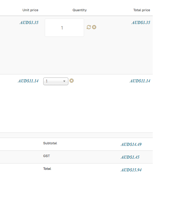

  • Posts: 135
4 years 5 months ago #340647
yes I had changed the show_block_cart as you had suggested, to
$this->options['price_with_tax'] = 0;
$this->options['price_with_tax'] = 1;
So I could see unit price for each product and then tax.
Now I get the subtotal, GST, and total correct but now the single product goes back to Unit Price Only.
See attached

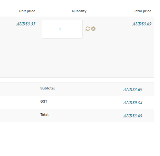

Last edit: 4 years 5 months ago by nicolas.
  • Posts: 86212
4 years 5 months ago #340657
Then, instead of having the "show taxed prices" setting turned on and the code I gave before to remove the tax on the price without taxes, you can have that setting turned off, and change the line:
echo $this->getDisplayProductPrice($product, false);
to:
in that same show_block_cart so that the product total price is with taxes.
  • Posts: 135
4 years 5 months ago #340731
Nicolas,
perfect as normal, code works perfectly.
M
