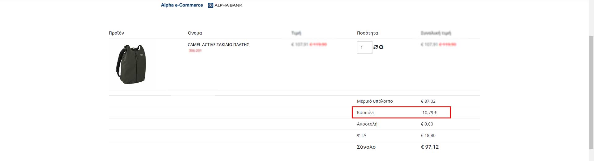

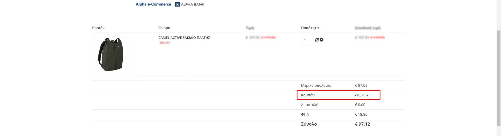

At checkout page the € symbol is displayed before the prices but at the coupon line is displayed after the price.
How can i change that so it's the same everywhere?

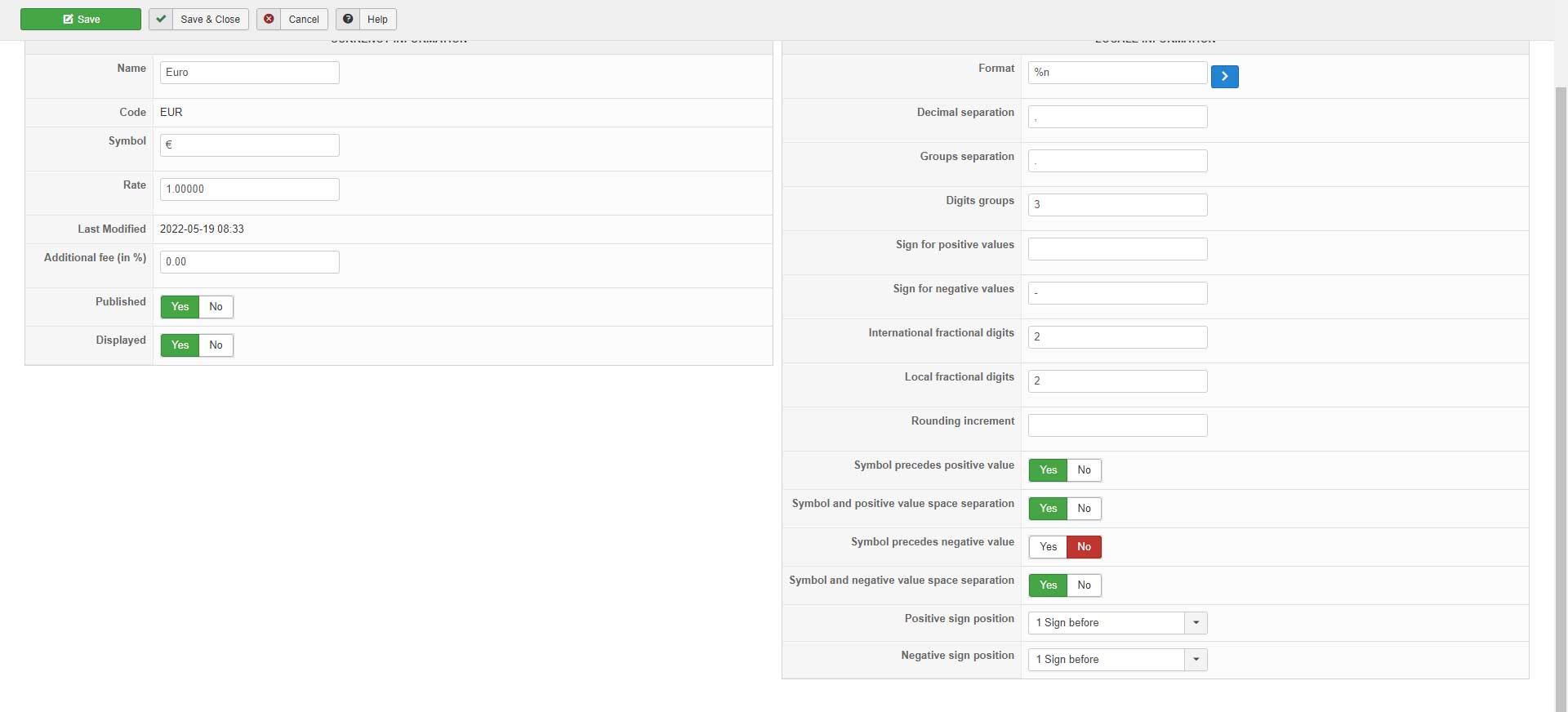

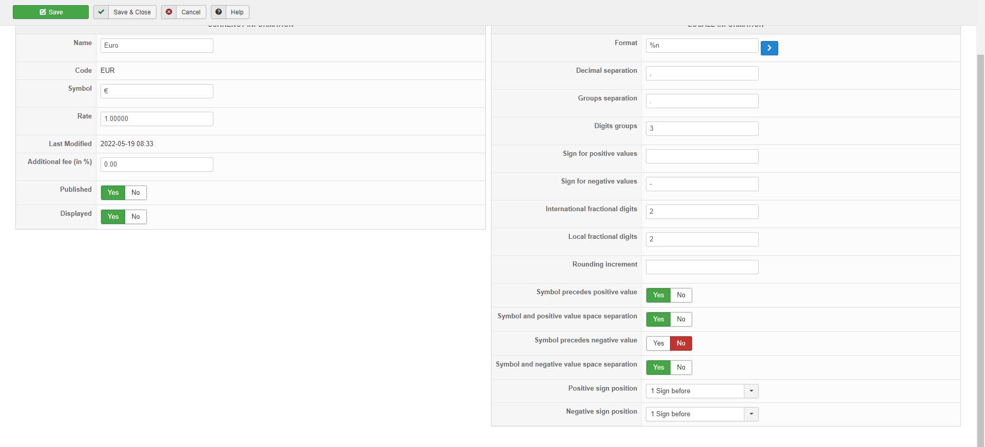

It's a problem with the settings of the Euro currency. So go in the menu System>Currencies and edit the Euro currency.
There, you normally want both "Positive sign position" and "Negative sign position" to have the same value which must not be the case on your website.

4 years 3 months ago #341903
They have the same value nicolas!
  • Posts: 86212
  • Thank you received: 14220
4 years 3 months ago #341904
My bad, it's the "symbol precedes negative value" setting you want to change.
Basically, if you want a consistent look between positive and negative values, then the settings for positive/negative should be set the same way.
