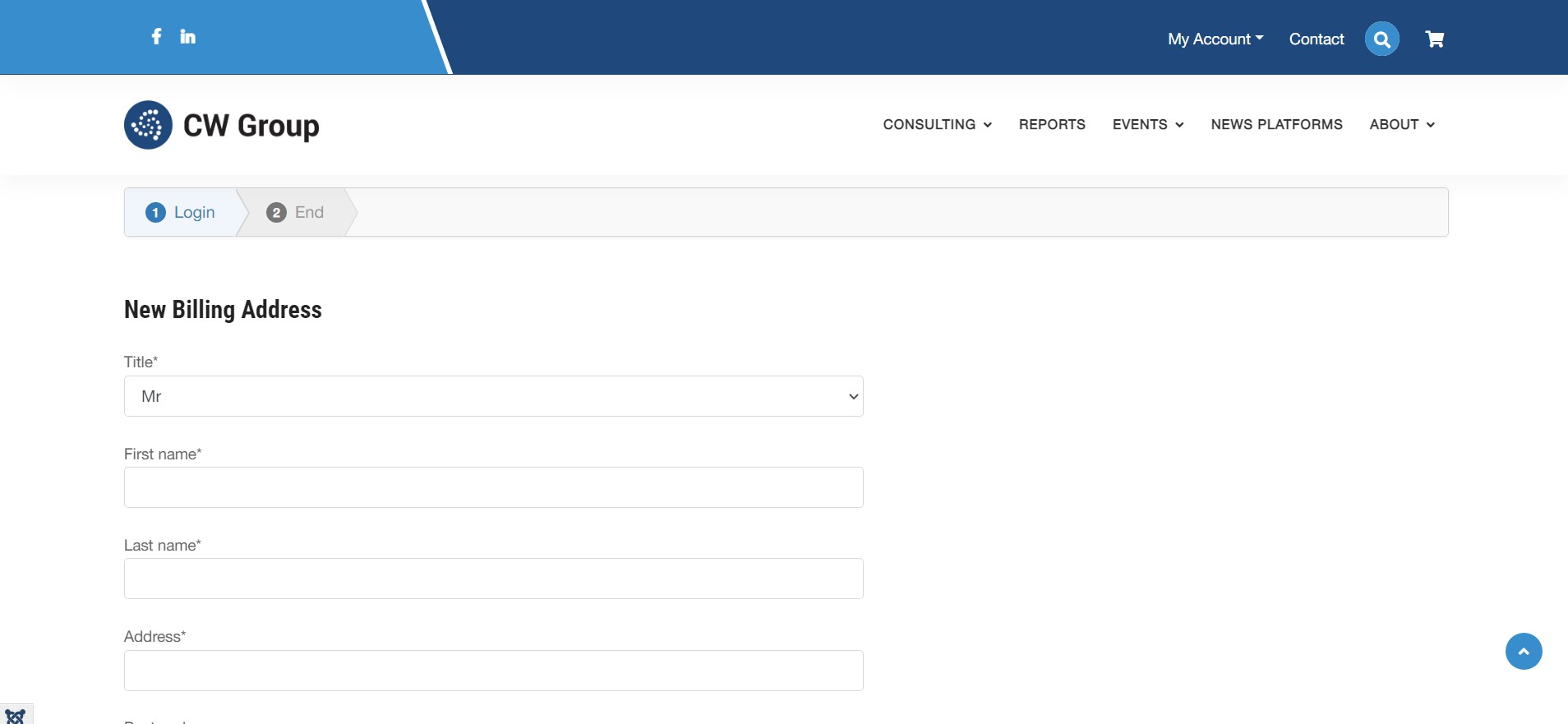

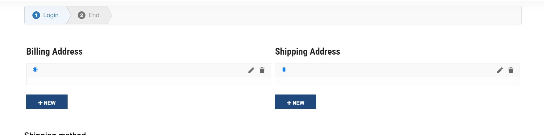

4 years 1 month ago - 4 years 1 month ago #343590 by robbed
1. Clicked into any product on the CW's site catalogue (chose a random one from Reports), added to cart.
2. Clicked proceed to checkout and was directed to this page: cwdev.alteweek.com/cw-group-report/checkout
3. Wrote all the data for the user and clicked on the button on the end of it that says 'OK'.
4. It immediately updated the Billing address and Shipping address to a blank selected space, still the same URL as above.

4 years 1 month ago #343766 by nicolas
I also had a look today. The address form now doesn't have any override and the HTML is similar to what we have on our end.
Also, when the data of the address was sent by the browser to the server that data was also correct.
And an address was created by HikaShop, but it didn't contain any data.
So that meant that the issue was during the saving of the address.
I directly thought it might come from a mass action or a custom plugin, but I couldn't find any mass action nor any custom plugin which could be related to this.
So I then checked the custom address fields and they looked fine in the backend.
Still I went and resaved them once just to make sure that the settings I thought in the backend really corresponded to what the checkout address saving system was seeing. And then I had the address saving working on the checkout.
So I conclude that there must have been some issue with the data of the custom address fields in the backend and saving them once fixed the problem.
