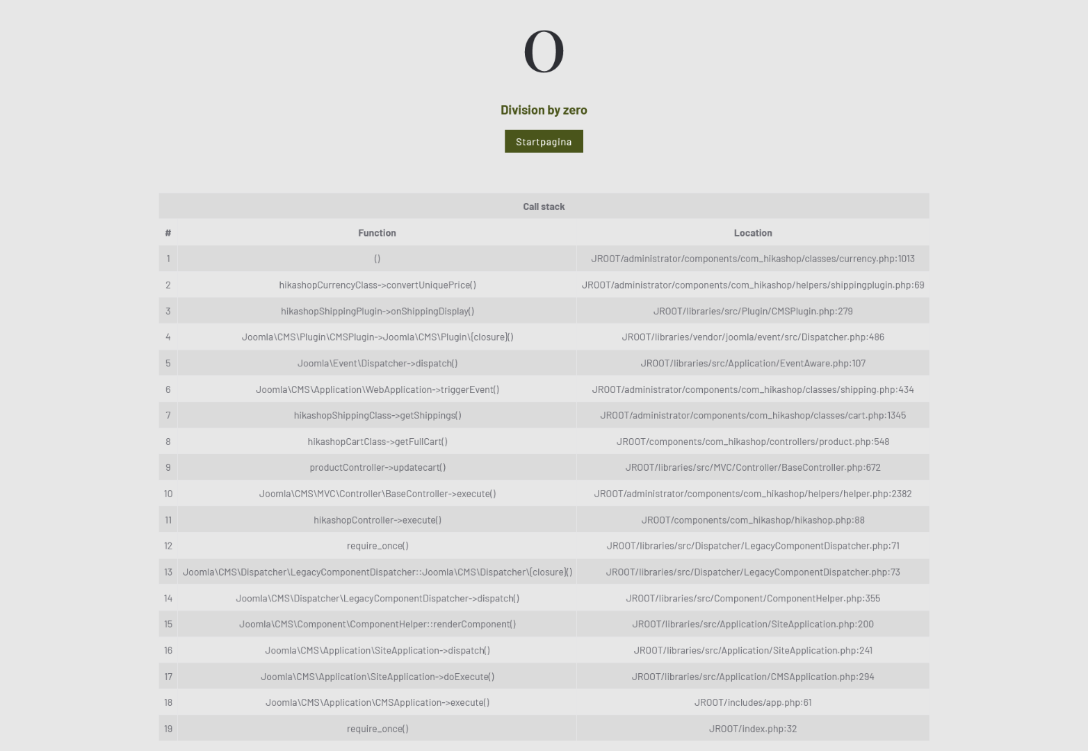

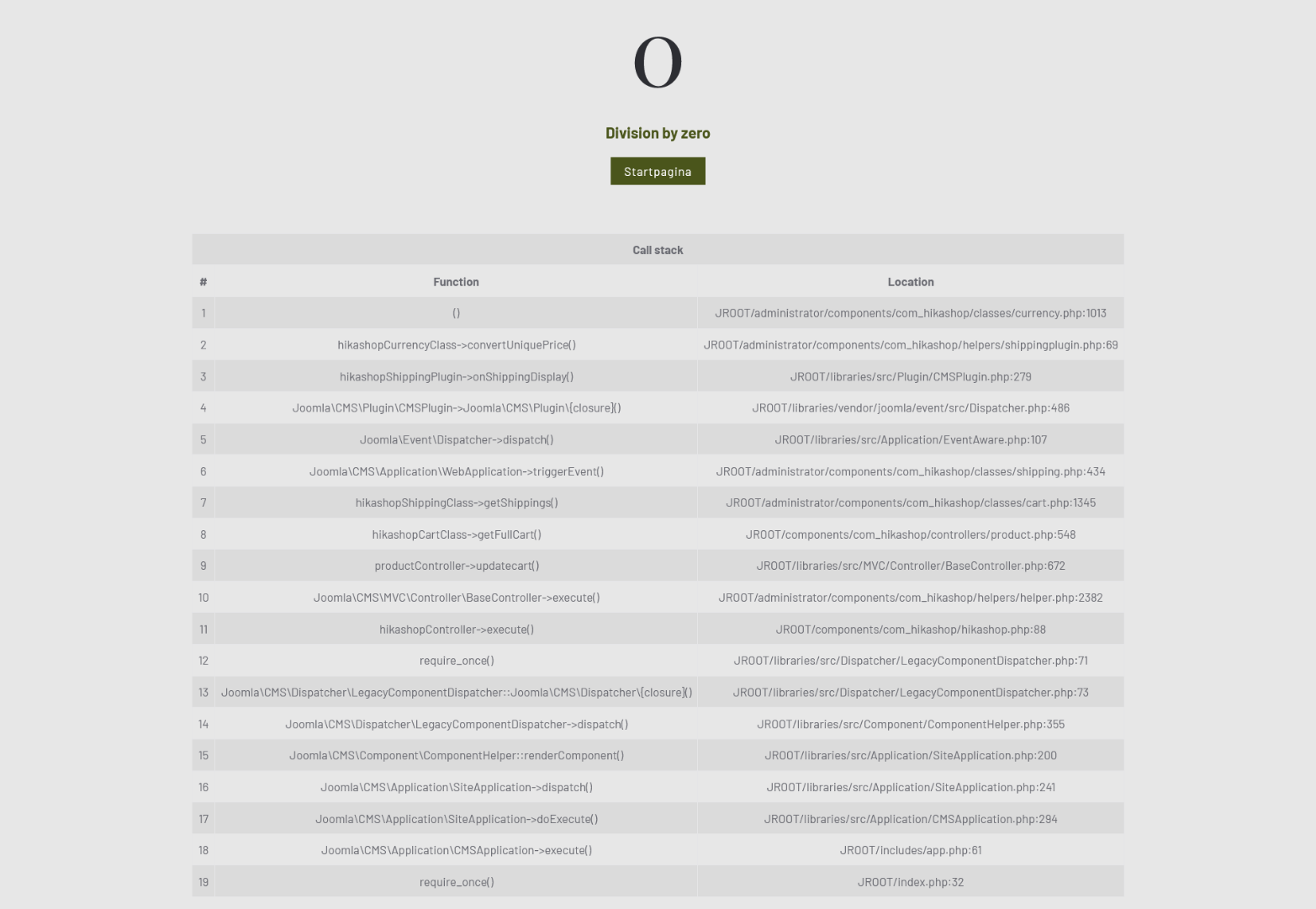

I also updated to the 4.2.1 and used the latest build of HikaShop 4.6.1 but I didn't get the error when trying to reproduce.
Could you please activate the "debug system" setting of the Joomla configuration and try again ? Then, please provide the full error message's screenshot.

I've turned every logging on and can see this in the logs :
2022-09-01T18:38:34+00:00 CRITICAL 77.63.33.55 error Uncaught Throwable of type DivisionByZeroError thrown with message "Division by zero". Stack trace: #0 [ROOT]/administrator/components/com_hikashop/helpers/shippingplugin.php(69): hikashopCurrencyClass->convertUniquePrice()
#1 [ROOT]/libraries/src/Plugin/CMSPlugin.php(279): hikashopShippingPlugin->onShippingDisplay()
#2 [ROOT]/libraries/vendor/joomla/event/src/Dispatcher.php(486): Joomla\CMS\Plugin\CMSPlugin->Joomla\CMS\Plugin\{closure}()
#3 [ROOT]/libraries/src/Application/EventAware.php(107): Joomla\Event\Dispatcher->dispatch()
#4 [ROOT]/administrator/components/com_hikashop/classes/shipping.php(434): Joomla\CMS\Application\WebApplication->triggerEvent()
#5 [ROOT]/administrator/components/com_hikashop/classes/cart.php(1345): hikashopShippingClass->getShippings()
#6 [ROOT]/components/com_hikashop/controllers/product.php(548): hikashopCartClass->getFullCart()
#7 [ROOT]/libraries/src/MVC/Controller/BaseController.php(672): productController->updatecart()
#8 [ROOT]/administrator/components/com_hikashop/helpers/helper.php(2382): Joomla\CMS\MVC\Controller\BaseController->execute()
#9 [ROOT]/components/com_hikashop/hikashop.php(88): hikashopController->execute()
#10 [ROOT]/libraries/src/Dispatcher/LegacyComponentDispatcher.php(71): require_once('/home/swanndev/...')
#11 [ROOT]/libraries/src/Dispatcher/LegacyComponentDispatcher.php(73): Joomla\CMS\Dispatcher\LegacyComponentDispatcher::Joomla\CMS\Dispatcher\{closure}()
#12 [ROOT]/libraries/src/Component/ComponentHelper.php(355): Joomla\CMS\Dispatcher\LegacyComponentDispatcher->dispatch()
#13 [ROOT]/libraries/src/Application/SiteApplication.php(200): Joomla\CMS\Component\ComponentHelper::renderComponent()
#14 [ROOT]/libraries/src/Application/SiteApplication.php(241): Joomla\CMS\Application\SiteApplication->dispatch()
#15 [ROOT]/libraries/src/Application/CMSApplication.php(294): Joomla\CMS\Application\SiteApplication->doExecute()
#16 [ROOT]/includes/app.php(61): Joomla\CMS\Application\CMSApplication->execute()
#17 [ROOT]/index.php(32): require_once('/home/swanndev/...')
#18 {main}
And what I see it something that could be related to shipping?
I hope this is useful.
