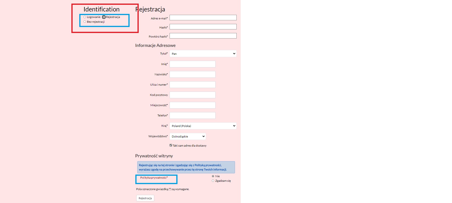

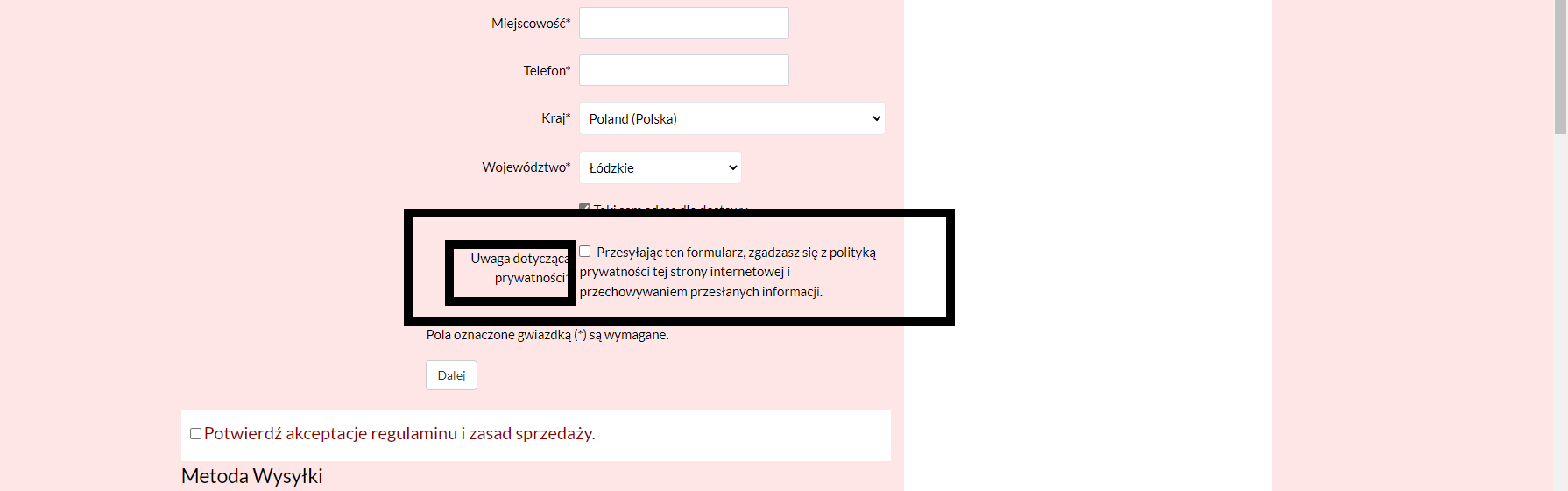

When there is checkout, when I switch to register, a checkbox and a link to the privacy policy will appear.
When I want to shop as a guest, a checkbox to check appears, but the text with the privacy policy is not linked.
The guest user cannot read the policy before checking the checkbox

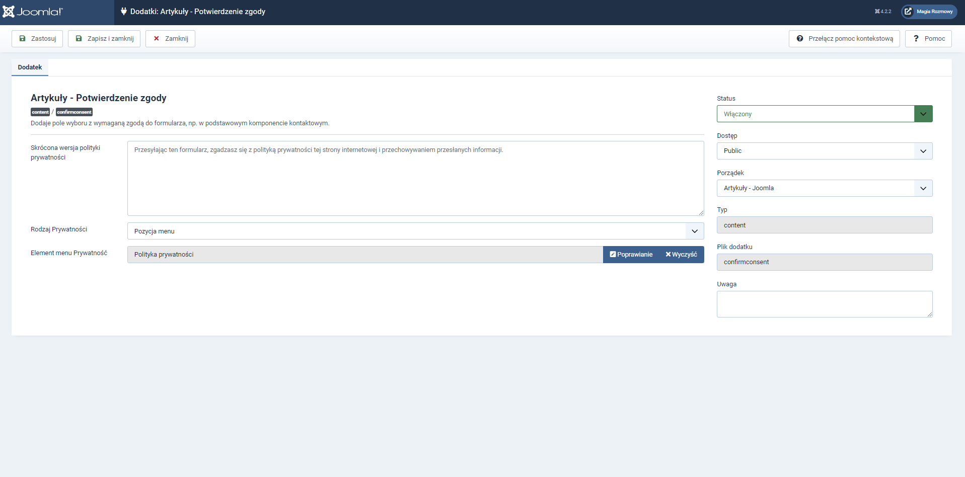

In the settings of the "Content - Confirm Consent" plugin of Joomla, you need to select your privacy article in the corresponding setting.

This article is already selected in the plugin . It is displayed in the contact form.
In the store, the policy is also displayed if the customer chooses the option of shopping with registration.
When we select the Guest option, the text remains inactive
And that's what I mean. I would like both - Guest and Registered policy to be linked

Could you provide a screenshot of the settings of your "Content - Confirm Consent" plugin ?
Because besides that I don't see a reason why it wouldn't work.

3 years 10 months ago #344740
You need to use the "article" mode, not the "menu" mode, which is not supported.
For the registration form, you're using the "article" mode and that's why you get the link and not on the guest form.
