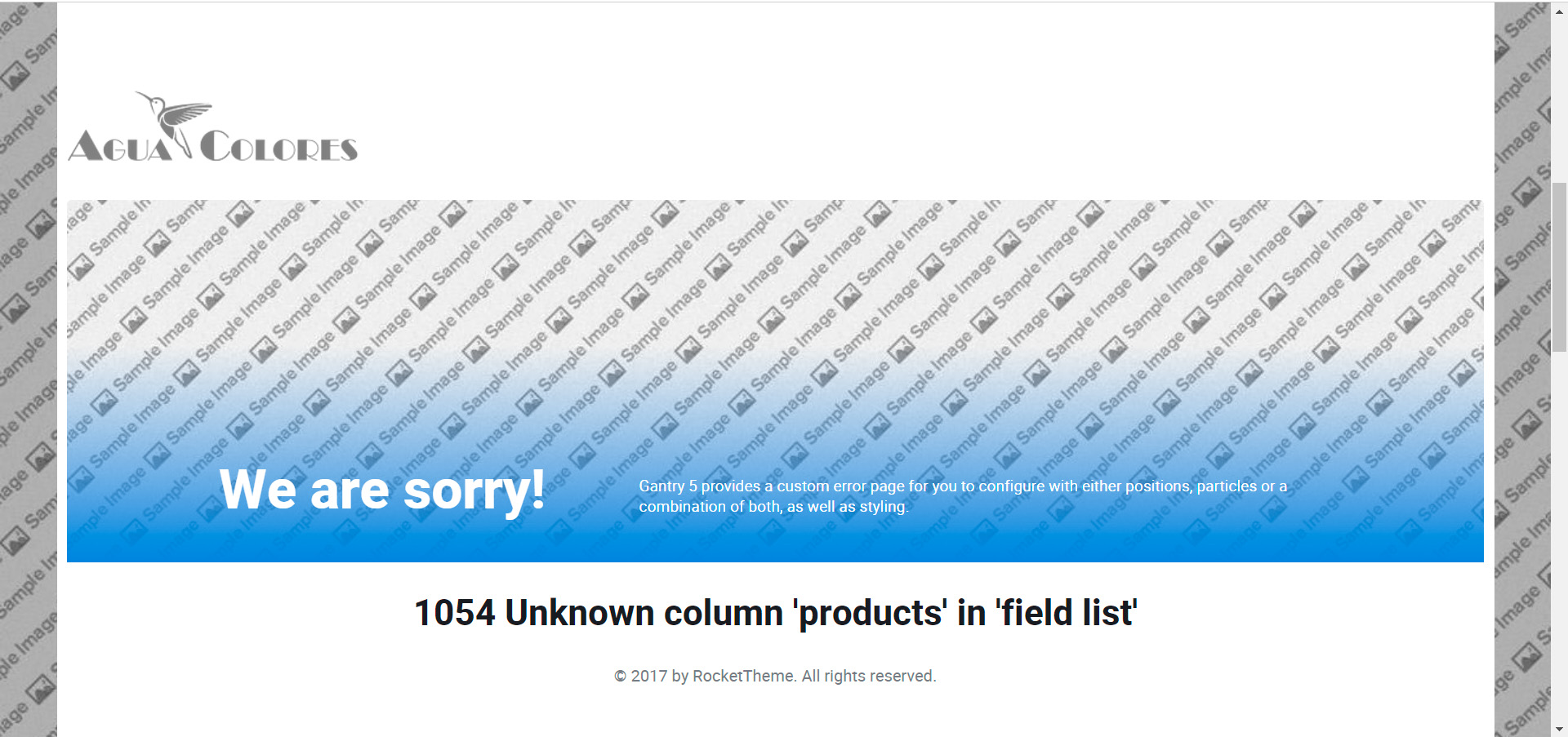

I can't add or remove articles from checkout list by + or - button ( aguacolores.com/index.php/es/carro/checkout/cid-2 ). Shows a default error page. Recently I installed this plugin by Obsidev "obsidev_coupon-free-product.zip" and when I disable the plugin it works fine. Please can you provide a solution?

  • Posts: 37
3 years 10 months ago #344772
Did turn on the debug mode and generated the same problem. At the bottom of the website are the results.

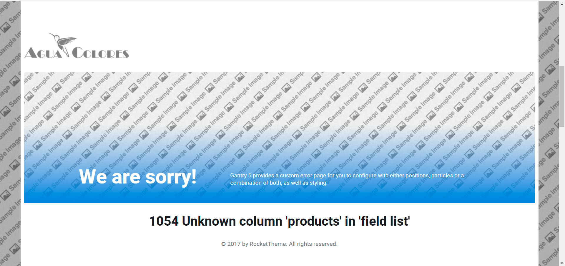

After pressing the "completar la compra" button it will show the next page ( aguacolores.com/index.php/es/carro/checkout ) Then after pressing the "siguiente" button it will show this page( aguacolores.com/index.php/es/carro/checkout/cid-2 ). When you change now the quantity by the + and - signs, the error page will popup.

Great, I was now able to get the full error message:
i.imgur.com/D4qjEFx.png
So the error comes from the Falang database driver.
Do you have a recent version of Falang ?
the "products" key of the error message, is an attribute of the object being saved. However, that attribute is an array. Normally, this is ignored by Joomla's updateObject function but since it goes through Falang's driver I don't know why it doesn't ignore it too.
