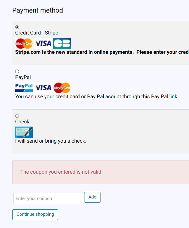

Problem with coupon
Hello - A few days ago I installed the multicoupon discount extension on my hikashop site.
I have been receiving erratic behaviour.
After installing the coupon, it shows on the shipping pages and works - but after a few hrs or next day it will not work - coupon text shows, but you get an error = "The coupon you entered is not valid". Last time this happened I deleted it and made a new coupon with a different code and it worked for a few days. I also noted that it could not be deleted from the checkout page using the delete button. Also, it stayed on (in chrome) and a happy customer received the discount without even entering the code.

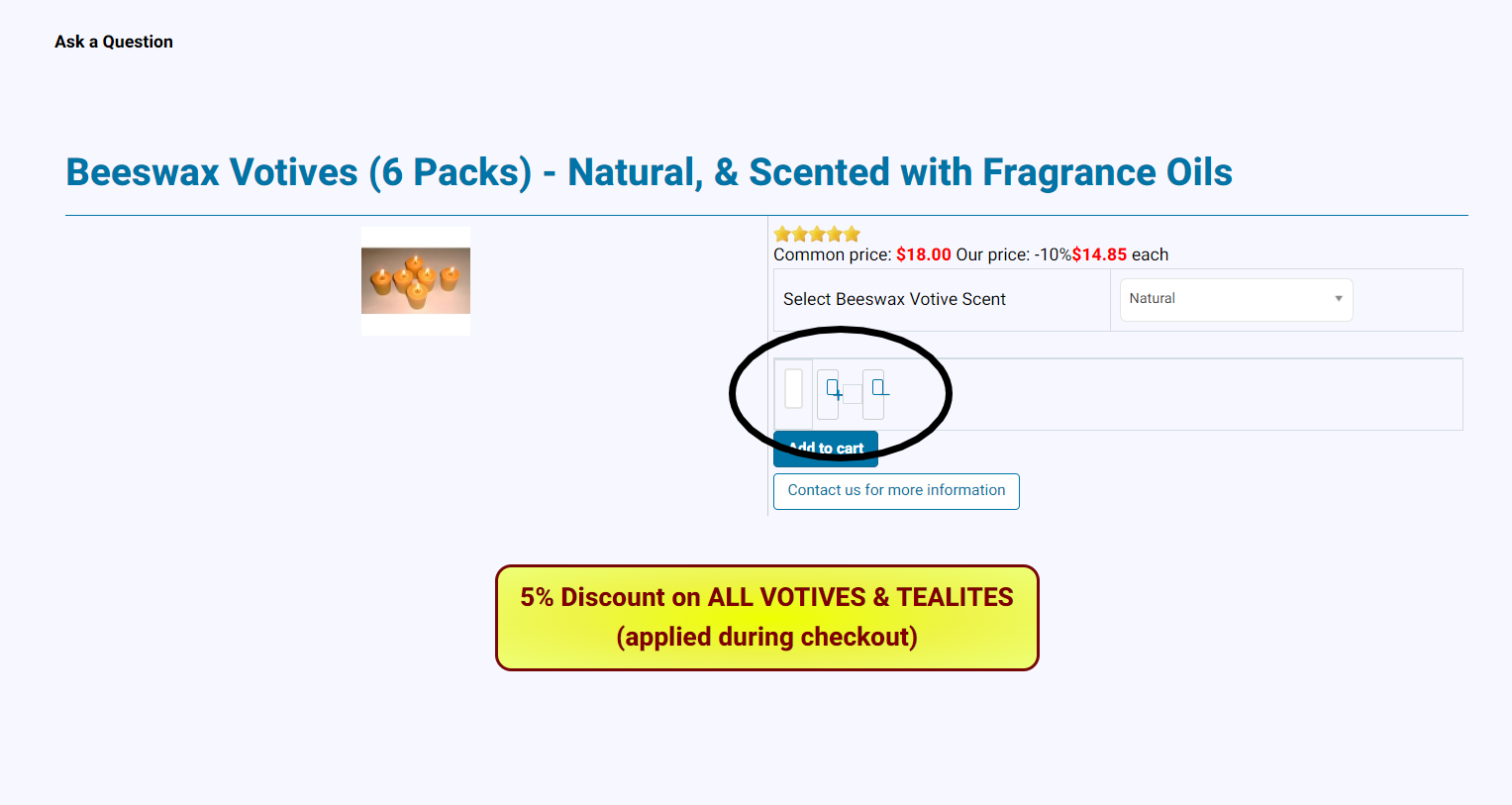

One other question - what is the the 3 empty boxes - I probably had them before but don't remember - I just upgraded to new hikashop.
  • Posts: 86212
  • Thank you received: 14220
3 years 9 months ago #347524
These are the quantity input and the + and - buttons. They display like this because of the template CSS.
A quick solution is to change the "quantity input method" setting of the HikaShop configuration to a layout which works better with your template.

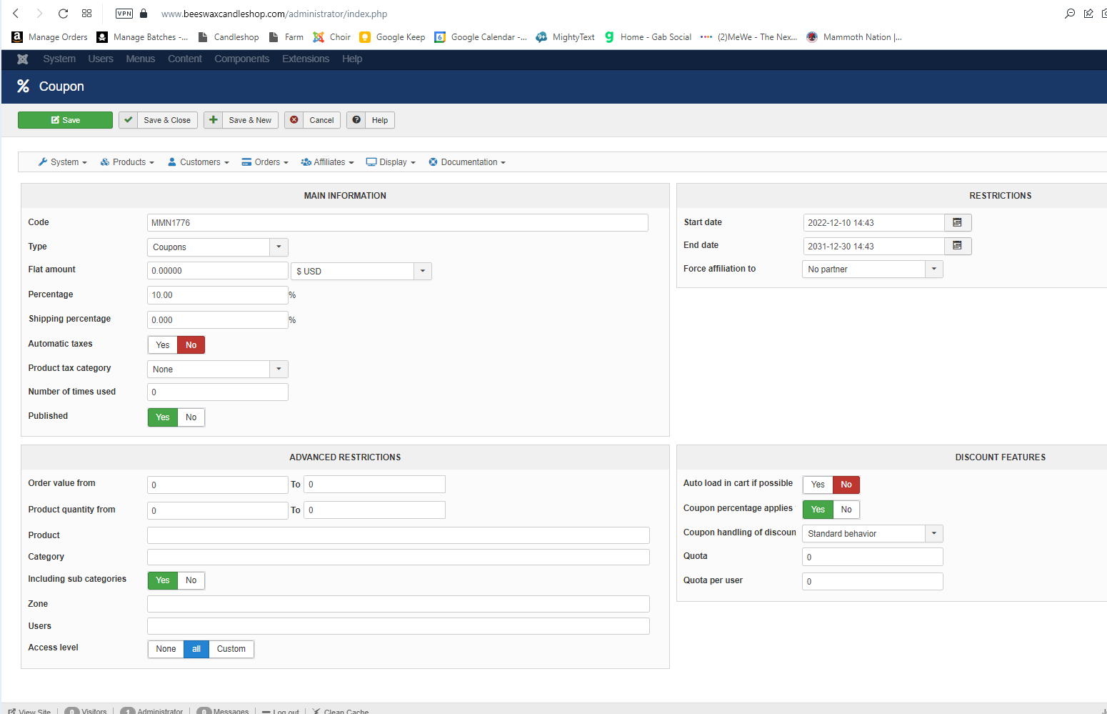

We can look into the situation with the multicoupon system but we would need some instructions to be able to reproduce the problem consistantly. Also, if you could provide screenshots of the settings of the coupons involved in the issue, it would be great so that we get a better understanding on the situation which is a problem.
