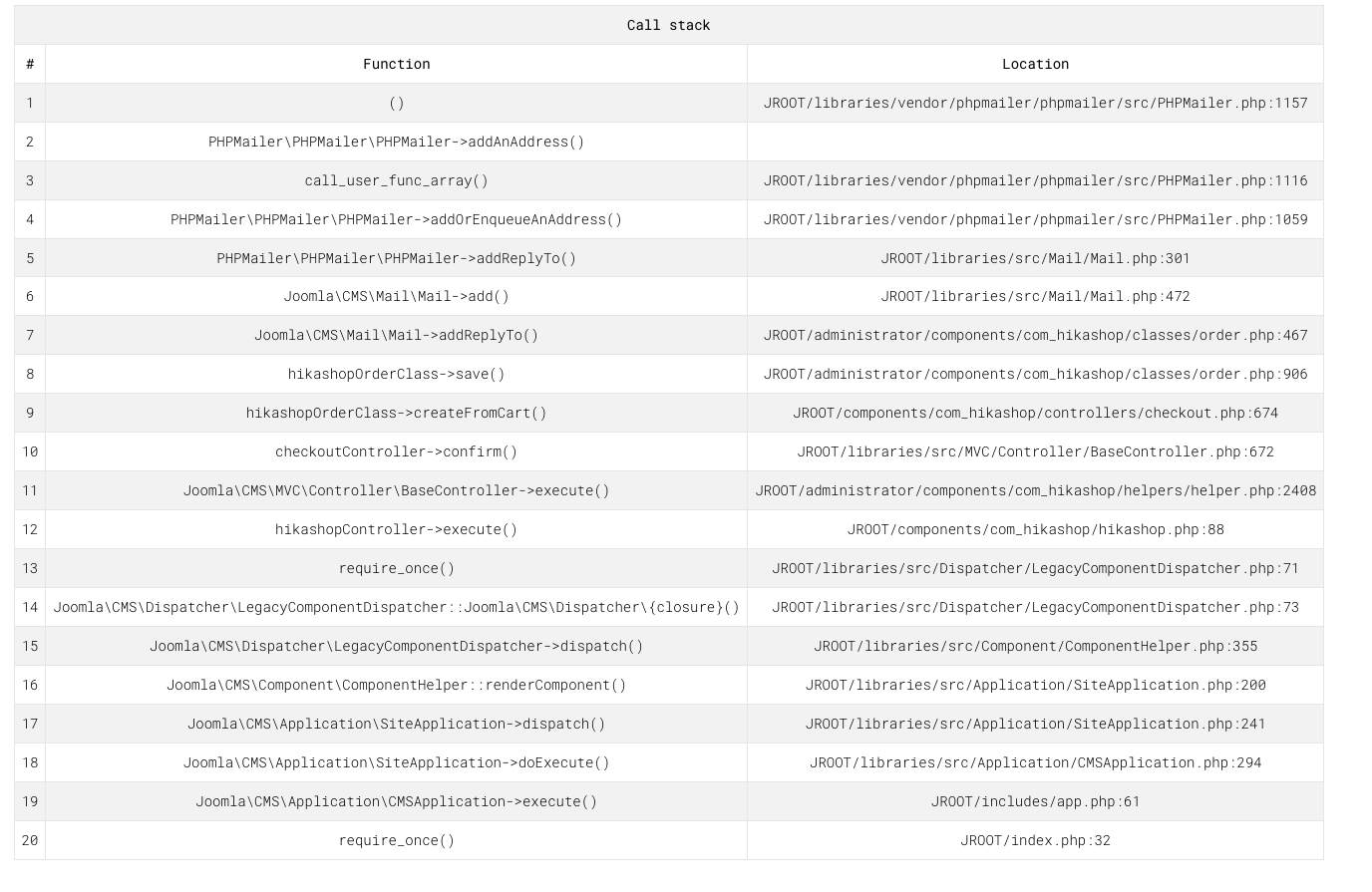

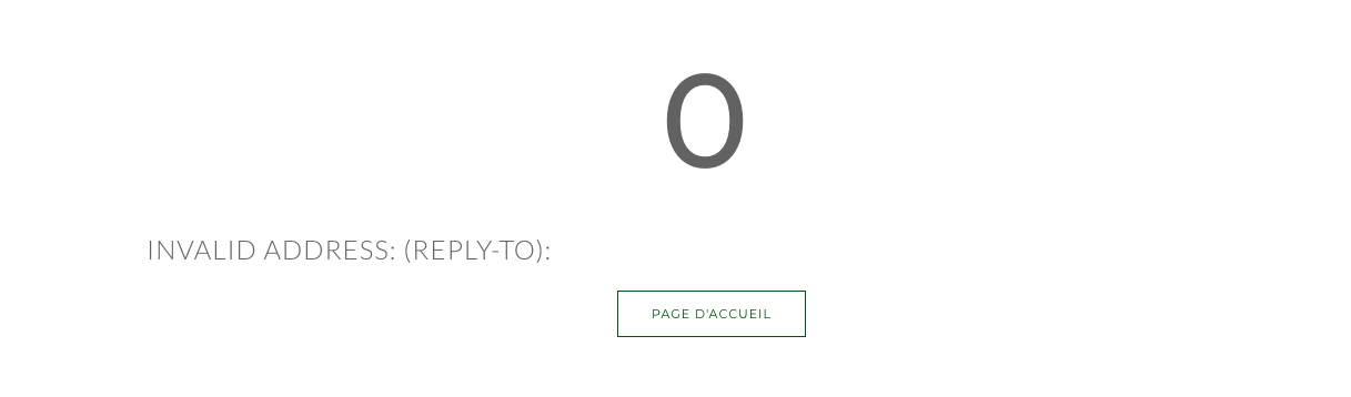

  • Posts: 6
3 years 7 months ago #348936
Bonjour, ci-joint les captures d'écrans. Merci

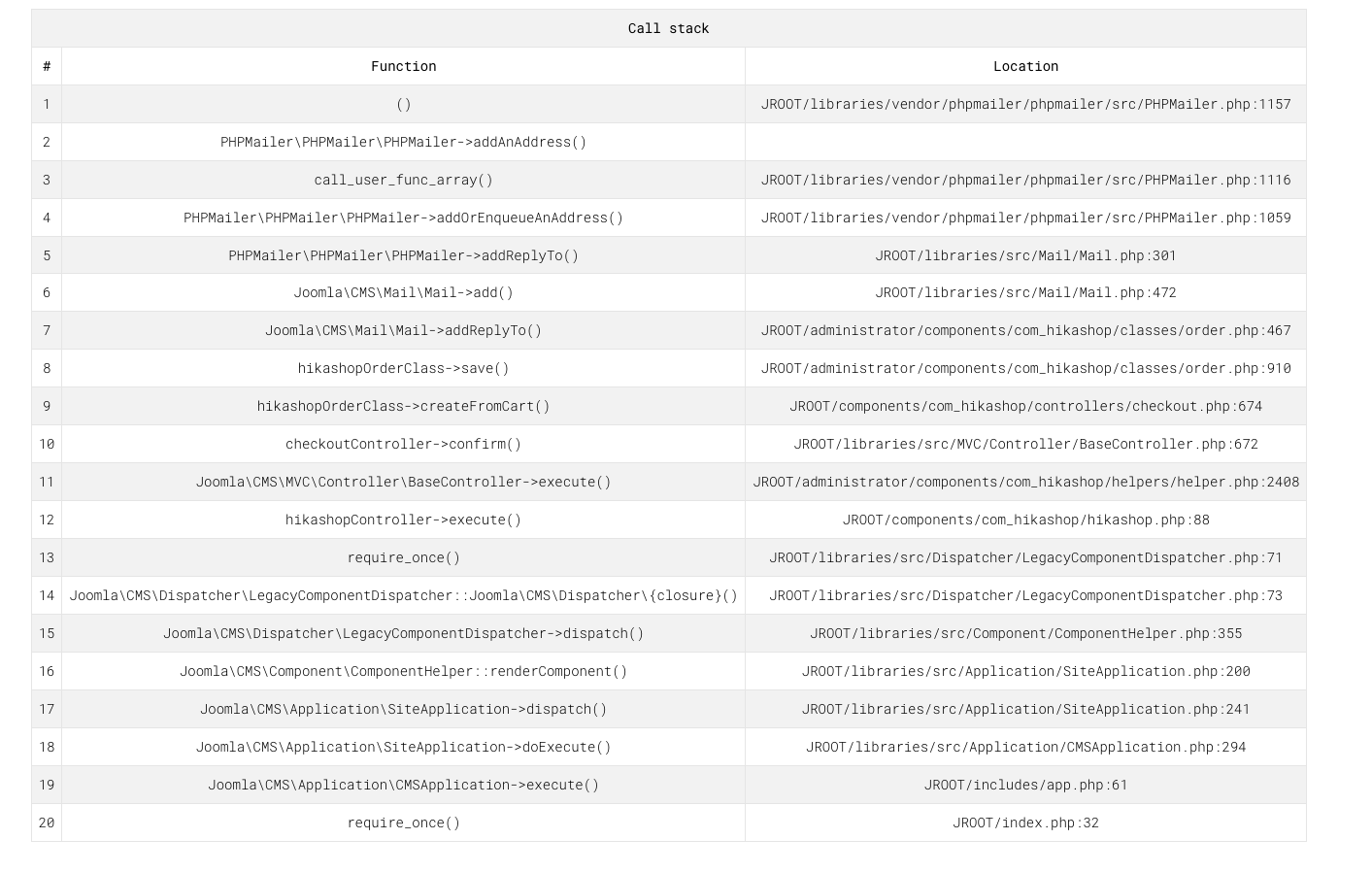

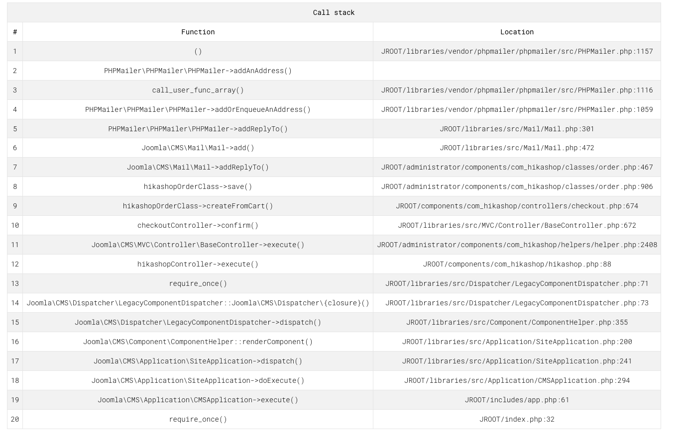

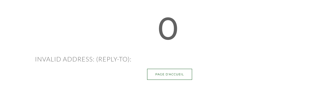

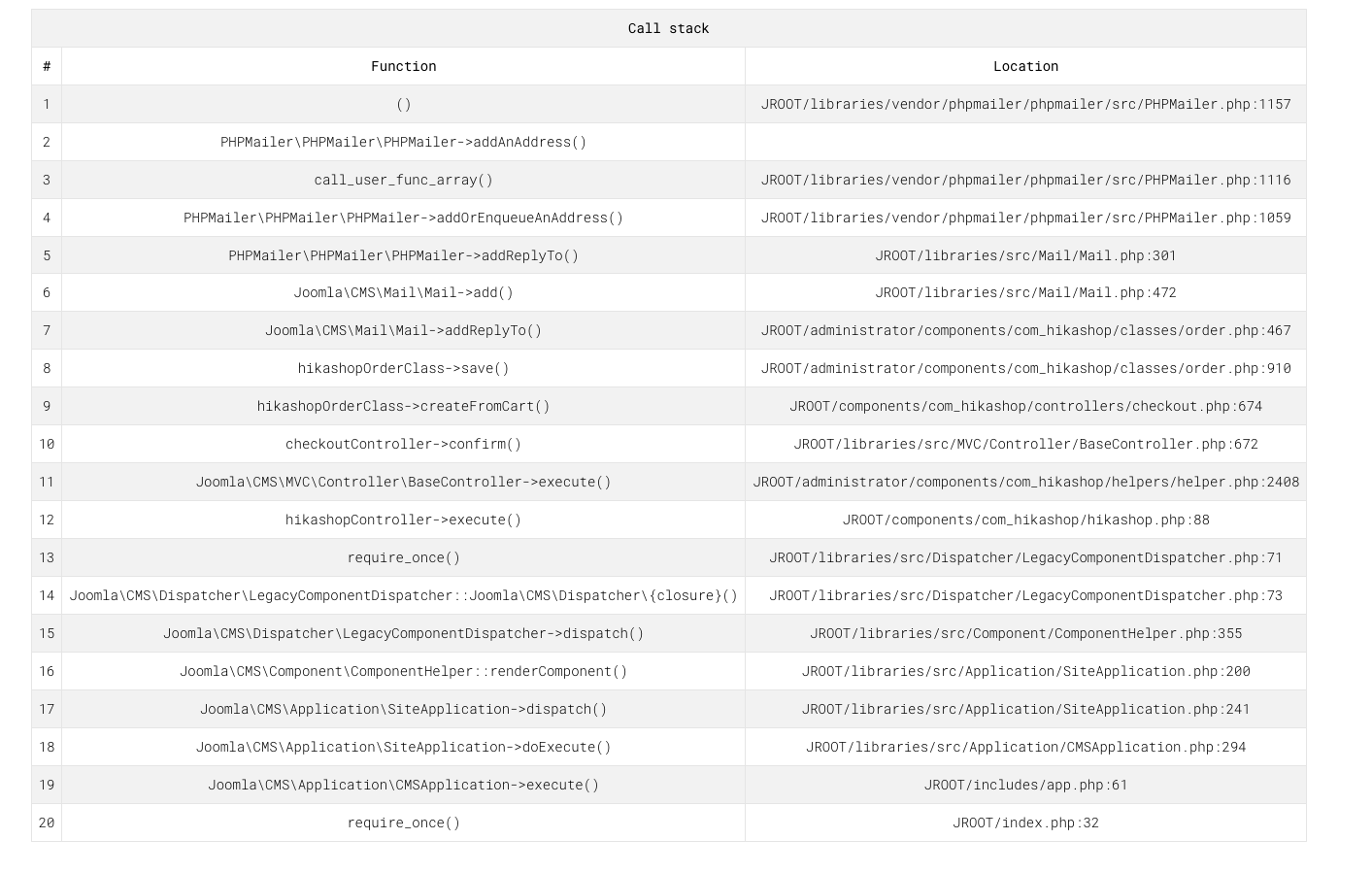

  • Posts: 6
3 years 7 months ago #349108
Bonjour, voici la capture, Merci
  • Posts: 86212
  • Thank you received: 14220
3 years 7 months ago #349117
