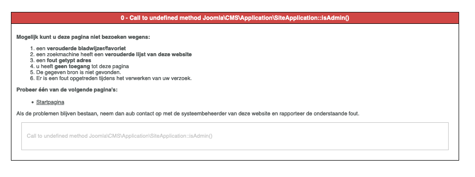

While still fixing everything after migrating to joomla 4 (everything seems up to date now), I ran into an error while testing to order something on the site.
I get "0 - Call to undefined method Joomla\CMS\Application\SiteApplication::isAdmin()"
I tried some things, thought it might have to do with SEF or something, but that doesn't seem to be it.
I added an attachement of the error

3 years 6 months ago #350105
This error usually comes from old email overrides.
For example:
www.hikashop.com/forum/product-category-...-isadmin/349811.html
The best would be to first activate the "debug" setting of the Joomla configuration and reproduce the error.
You'll get a more detailed error page, with the file path where the error happens, like posted by @StudioPrzyLesie on the other thread. And you'll see it will probably point at an email preload override.
So you'll have to go in the menu System>Emails to delete the override and potentially redo your modifications on the new version of the preload.
