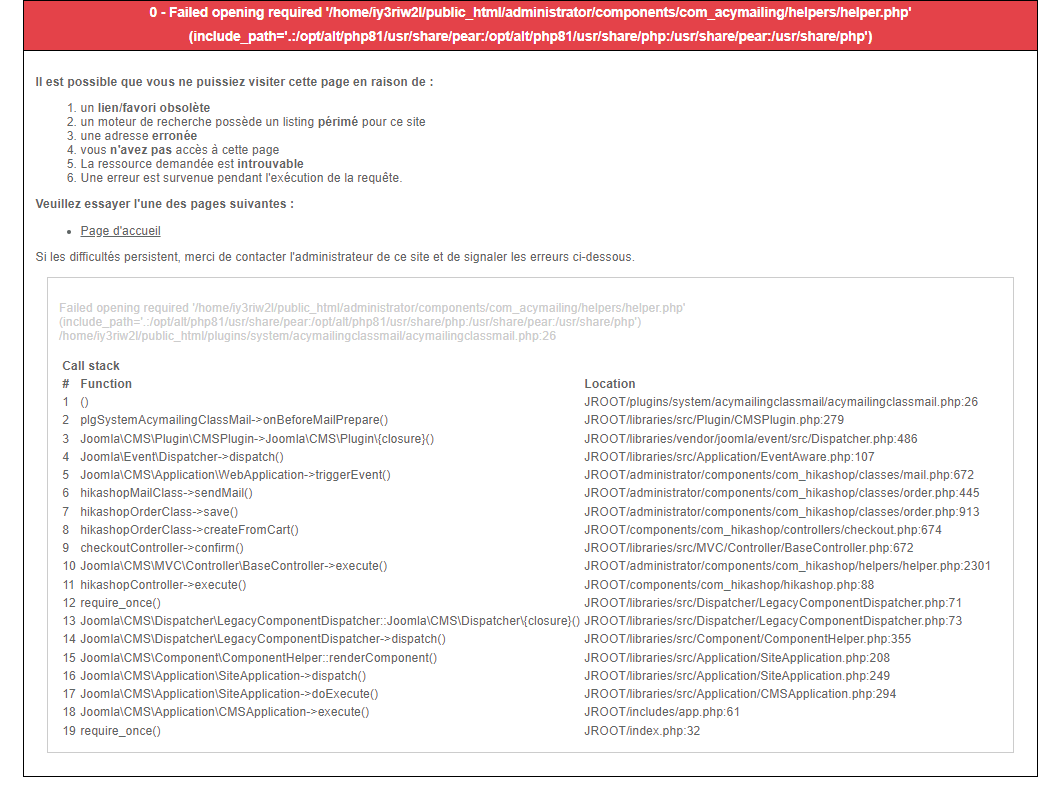

3 years 5 months ago #350952
Hi NIcolas,
Here is the full report attached to this message. If it helps.
Thanks for you quick answer.

You have a plugin called acymailingclassmail in the "system" group of plugins. This plugin of AcyMailing allowed AcyMailing to override the HikaShop emails.
The error message says that this plugin is not finding AcyMailing on your website.
So either deactivate this plugin our install AcyMailing and it should work.
For further support on this issue, you'll have to contact the AcyMailing support as they are the ones who developed this plugin and we actually never looked into it.
