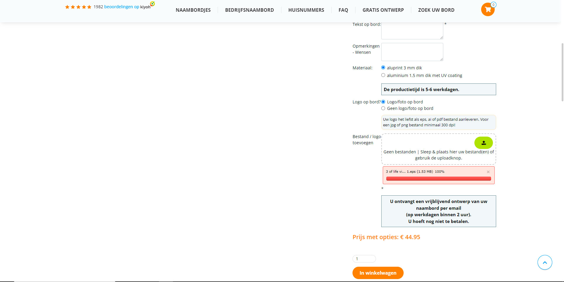

3 years 2 months ago - 3 years 2 months ago #354455 by jouwnaambord.nl
After clearing all cache it worked fine. Don't know why, but now the upload error is back again. See screenshot.
f.e. on jouwnaambord.nl/bedrijfsnaambord-wit-aluminium-15-x-20-cm
I made the modifications again to the upload.php
Last edit: 3 years 2 months ago by jouwnaambord.nl.
