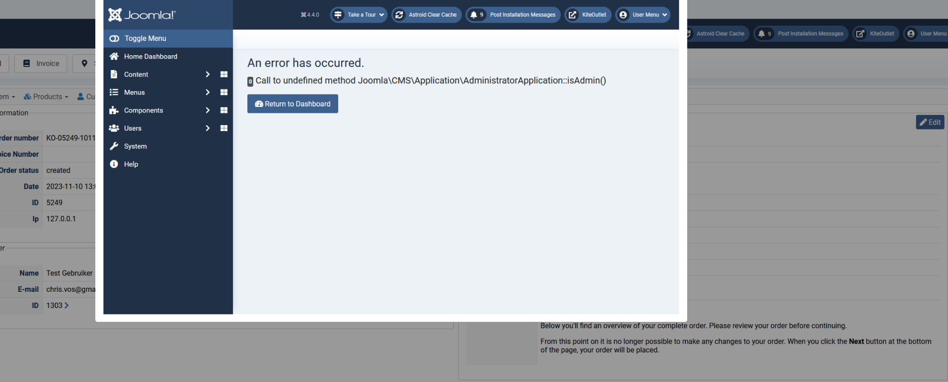

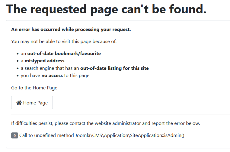

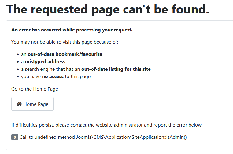

I am in the process of (finally) updating a clients website to Joomla 4. I have made a local (Xampp) clone of the live website and thought I had everything working smoothly. However when I try to place an order though the shop, after hitting the 'finish' button to finalize the order, I get a blank screen with the error message: 0 Call to undefined method Joomla\CMS\Application\SiteApplication::isAdmin() (See attached screenshot)

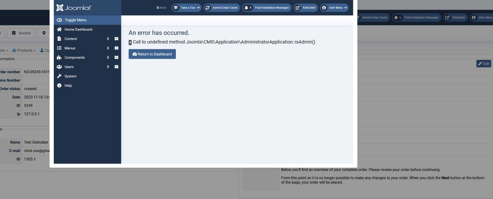

In the administrator back-end of the site I can see that the order has been registered, however I do not receive a confirmation e-mail of this order. When I try to edit the order in the back-end and want to send the customer a notification of the changes, I receive this same error message. (See attached screenshot). Because of this, I think this error message may have something to do with the sending of e-mails from the webshop.
