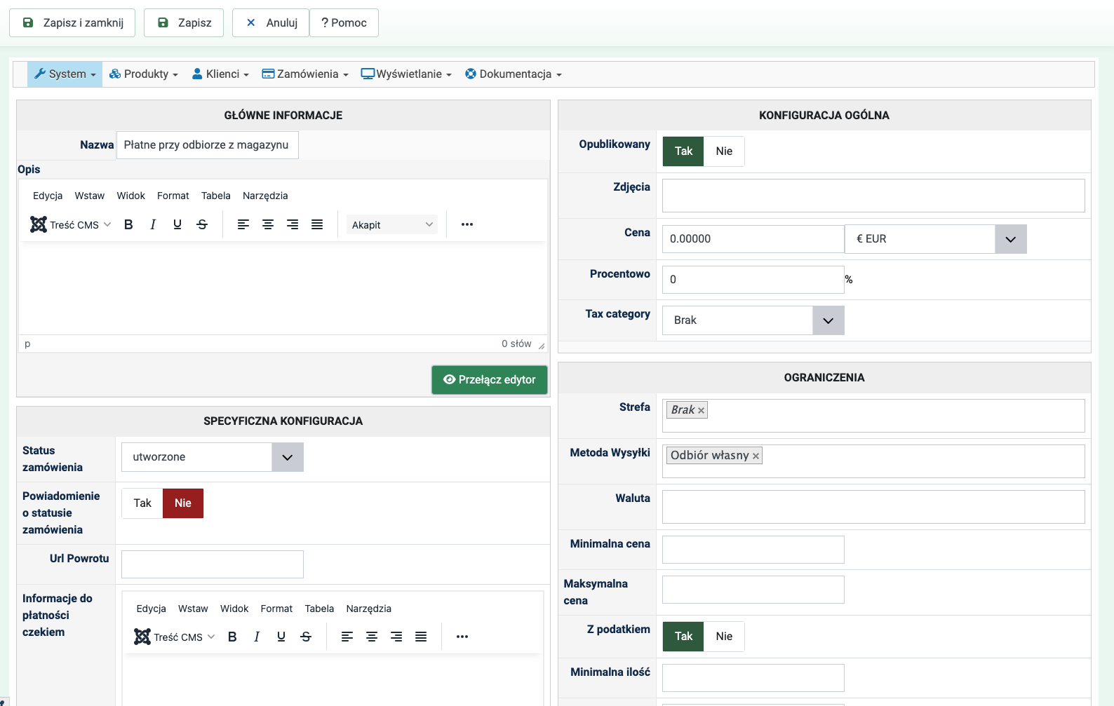

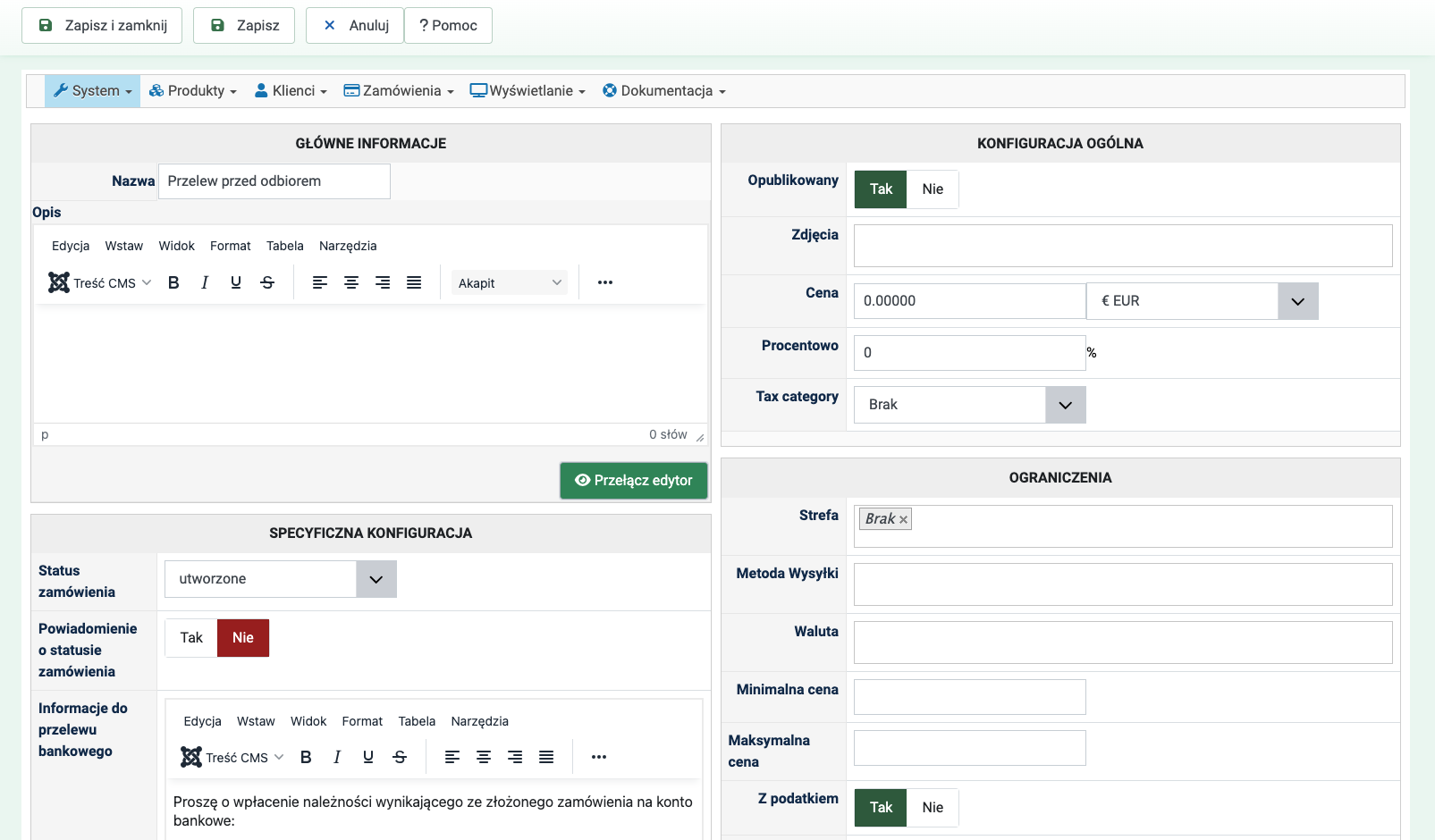

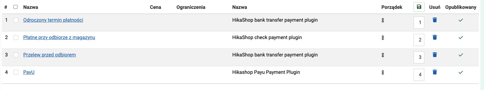

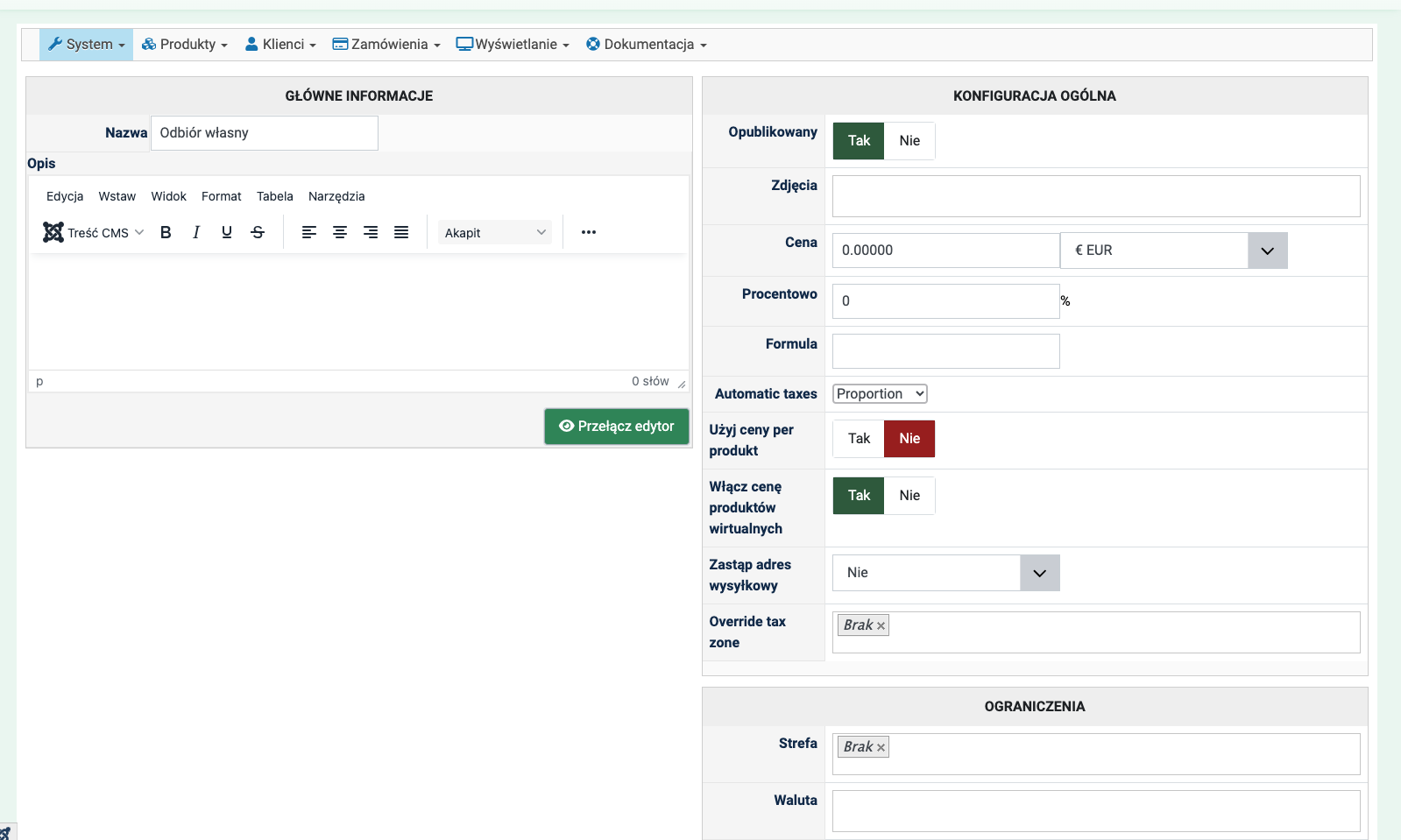

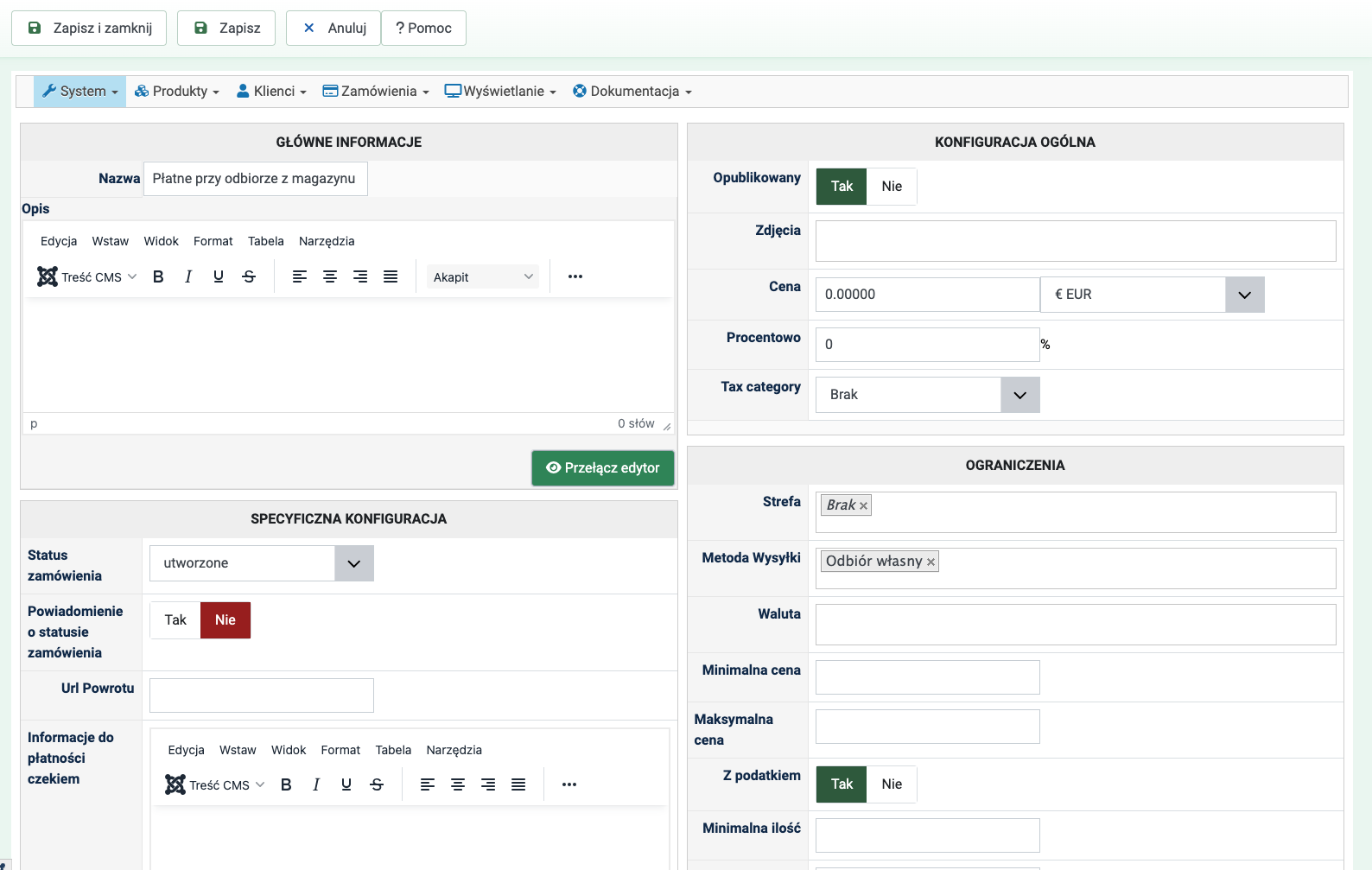

2 years 9 months ago #357075
Did you meant that, you want to restrict the use of certain shipping methods to certain payment methods?
Have you set up configurations in this sense and can you provide screenshots of these relative configurations?
awaiting your confirmation & settings elements.
Last edit: 2 years 9 months ago by Philip.
  • Posts: 196
  • Thank you received: 15

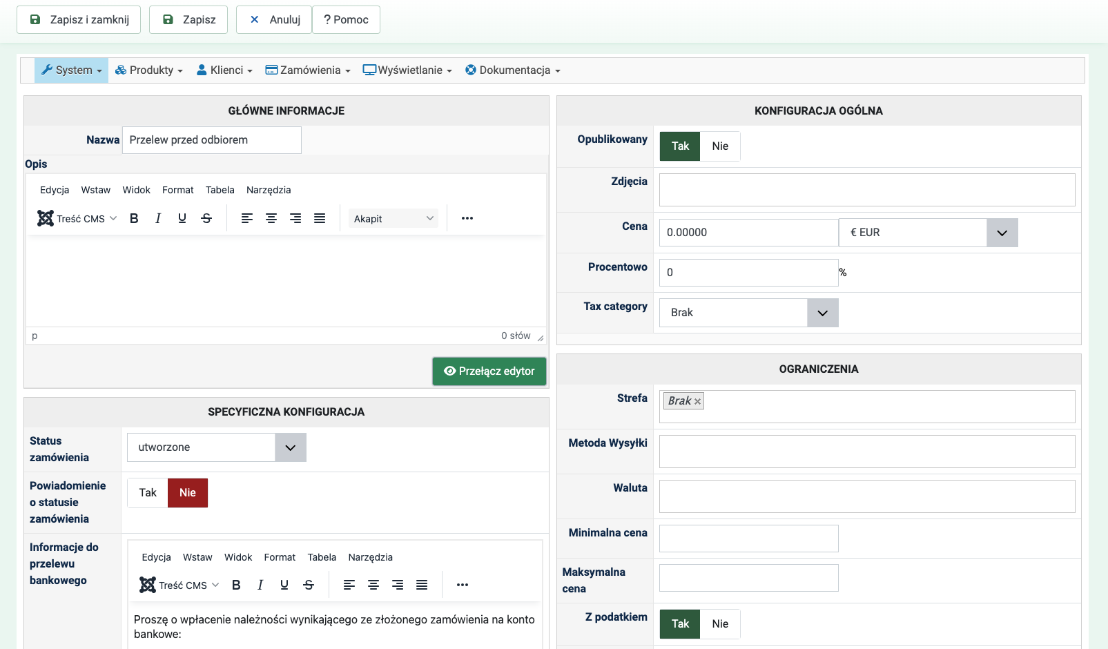

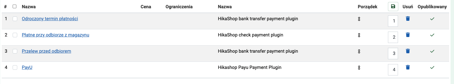

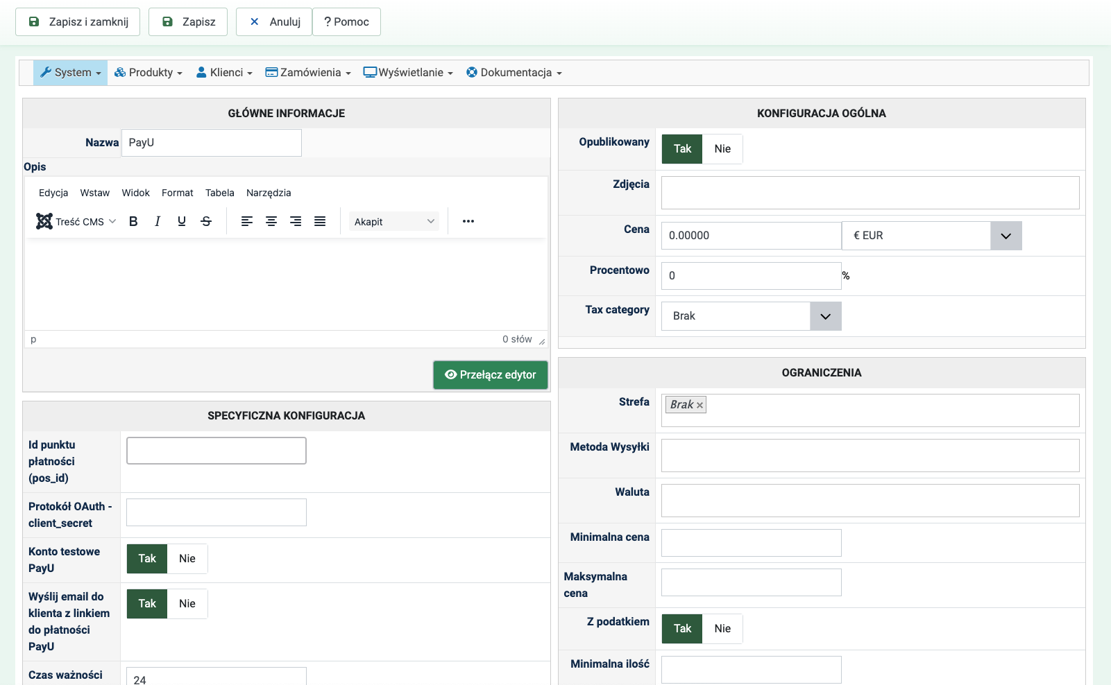

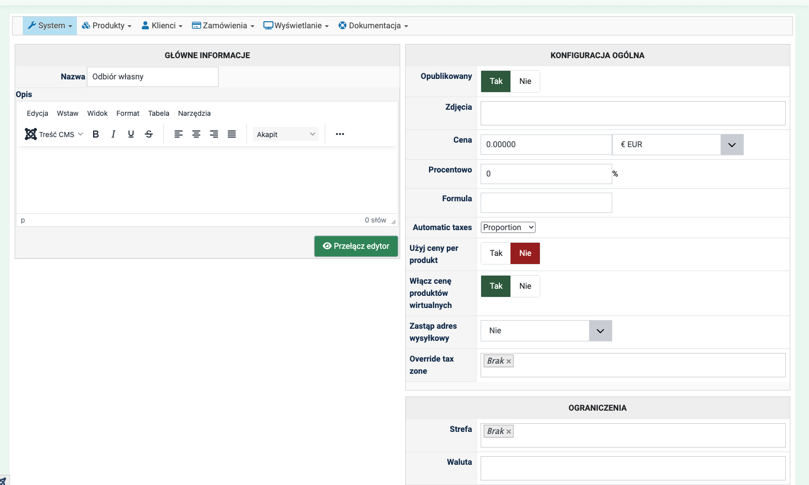

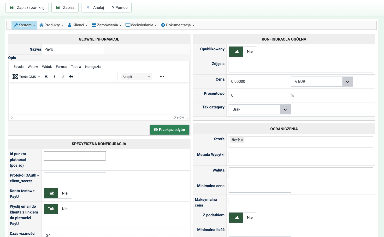

2 years 9 months ago #357080
configuration:
Last edit: 2 years 9 months ago by StudioPrzyLesie.
