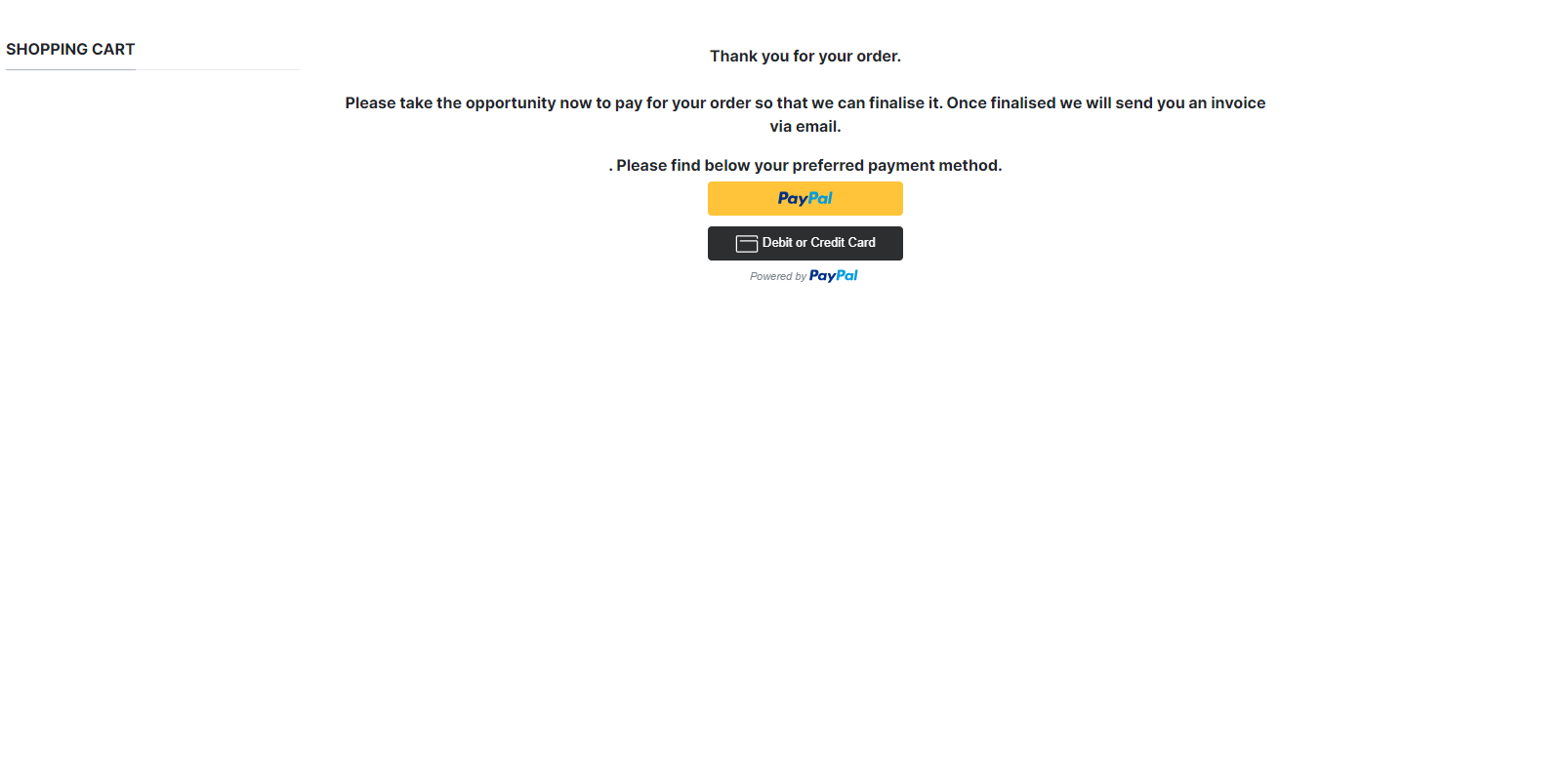

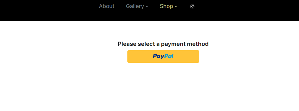

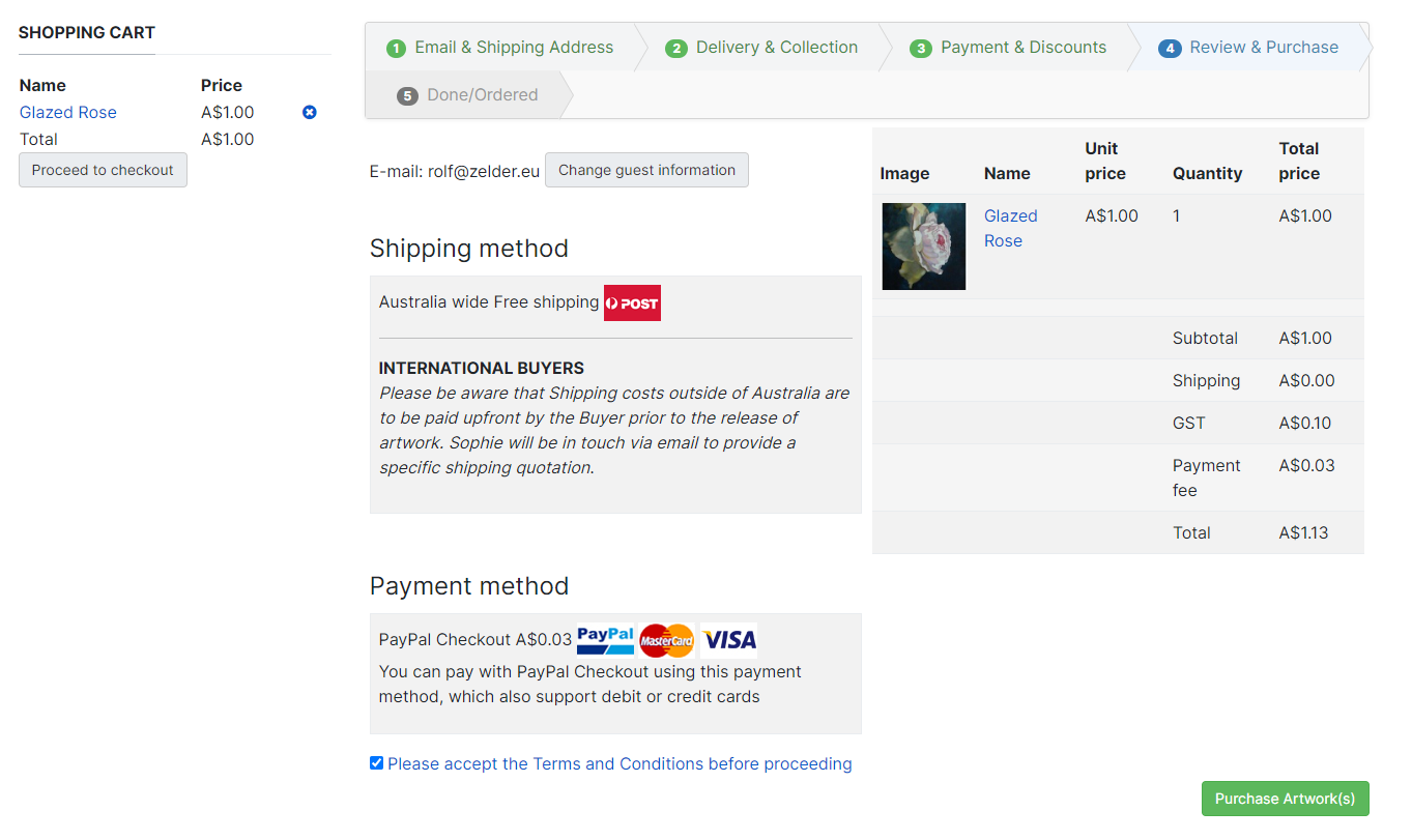

See below my first screenshot. I'm on step 4 where the customer can review the order before he submits/purchases the order.
The second screenshot shows you the page after the submission/creation of the order.
What I would have expected that the progress bar is still at the top showing done ordered with the paypal button showing so that the customer can pay for the order. Or even better an additional step in the progress before 'done ordered' where the customer has the opportunity to pay for the order.
I hope that makes more sense now.
First screenshot:
Second screenshot:

Ok, I see what you mean. We decided not to display the progress bar on the last page as usually payment plugins will just do a redirect on this page and we thought it might be confusing for the customer to see that he is on the "end" page of the progress bar while the payment still has to be made.
There is no easy way for us to make that possible.
However, as a customization, you can edit the view file checkout / end and add at the top the HTML you get for the progress bar on the previous step if you right click on it and click on "inspect element". In the inspector tool, you can right click on the HTML of the progress bar and copy the HTML.
www.makeuseof.com/copy-websites-code-chrome-firefox-edge/

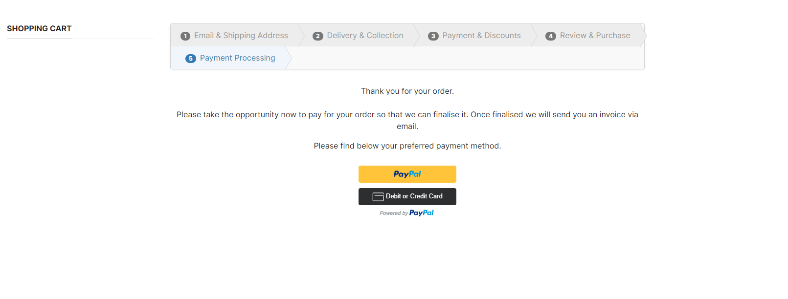

Thank you for your suggestion. That could work. Thanks again for all your responses. Much appreciated
  • Posts: 9
2 years 5 months ago #358458
All good now. I was able to add the progress bar to the top of the page copying the HTML code from the previous page.
Thanks for the help during the last couple of days. Much appreciated.
