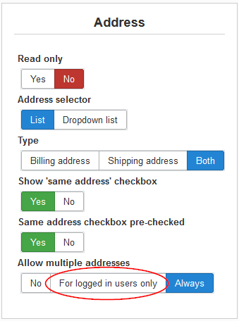

The Address step in the checkout process has a switch for "Allow multiple addresses" with 3 options.
  1. NO
  2. Logged in users only
  3. Always
I had this set to (2) but after going from 5.0.3 to 5.0.4 this option seems not to work any more and has the same effect as (1) "NO".
By setting it to (3) "Always" I can now select addresses again if multiple addresses were entered for an account.
A correction has no rush, but is appreciated nevertheless :-)

2 years 5 months ago #360470
I'm not able to reproduce the problem on my end.
Also, we didn't change anything in that area between the 5.0.3 and the 5.0.4.
I'm thinking you might have been testing while checking out as a guest and not a logged in user.
Could you please double check ?

2 years 5 months ago #360478
Thanks Nicolas,
Good to hear you could not reproduce, so it's probably something on my end.
I'm positive about my findings, but it was in my staging environment.
I will investigate further, check overrides and other possible factors involved.
Will keep you posted.
Cheers,
André
