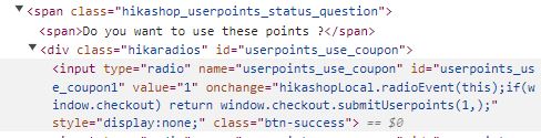

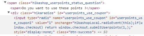

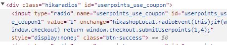

I parsed the html and found that there is no second parameter in submitUserpoints
Afterwards I found a solution.

I already pass the first parameter of the submitUserpoints JS function to the onCheckoutStepDisplay event through the $view object parameter. So I'll also add the position parameter in there.
It's actually something we already do for default views ( checkout / show_block_* ) so it will make it more consistant with the rest of the system and will completely bypass the problem of parameters default values.
