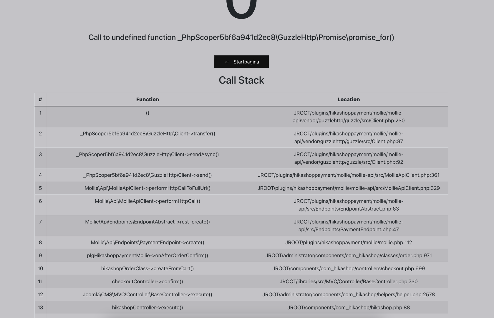

1 year 7 months ago #365507
Hi, I got the same error after upgrading (re-installing) my website from joomla 3 to 5
Using Hikashop 5 (latest update done today)
Ideal plugin works ok in the Joomla 3 site, but installing it on the new joomla 5 I get this error, I'm using the same settings as in cmo
Did the error log but... I don't have a clue where to find the solution, can you guide me?

1 year 7 months ago #365508
This is not the same error.
Yours looks like a problem with the Mollie payment plugin. Are you using the latest version ?
Maybe the old version of the plugin is not compatible with Joomla 5 ?
Did you try to download the latest version install package and installed it on the website ?
If you have the problem with the latest version, I would recommend contacting the developer of that plugin, SkySpider, so that they can look into it:
skyspider.com.au/#contact

1 year 7 months ago #365523
Thanks for your prompt response.
I purchased the last version and everything works as designed :-)
