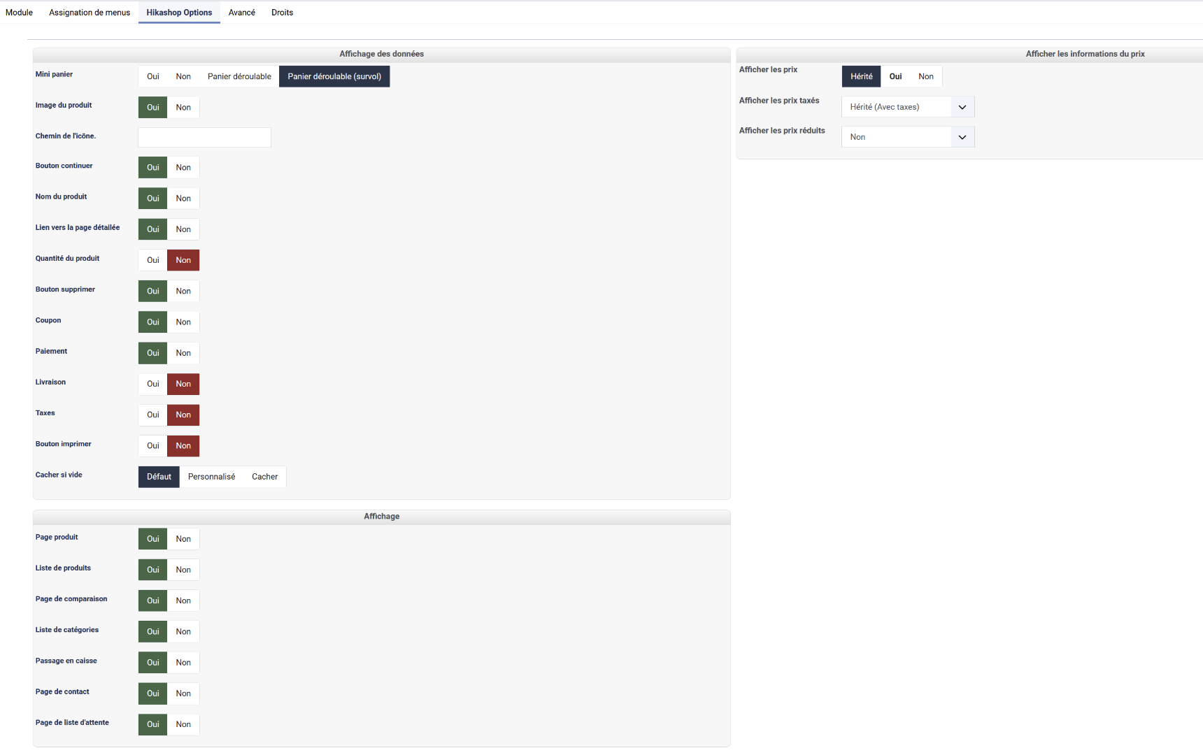

Could you provide a screenshot of the settings of your cart module ? I'm thinking that the coupon value missing from the cart module display is a specific combination of settings leading to this.

Switch the currency to euros using the module however, and suddenly the full price is displayed (93,16 €) but refresh the page and the coupon will be applied and the cart module will show the discounted price in euros.
I have attached a screenshot of my hikashop cart module options as requested.
