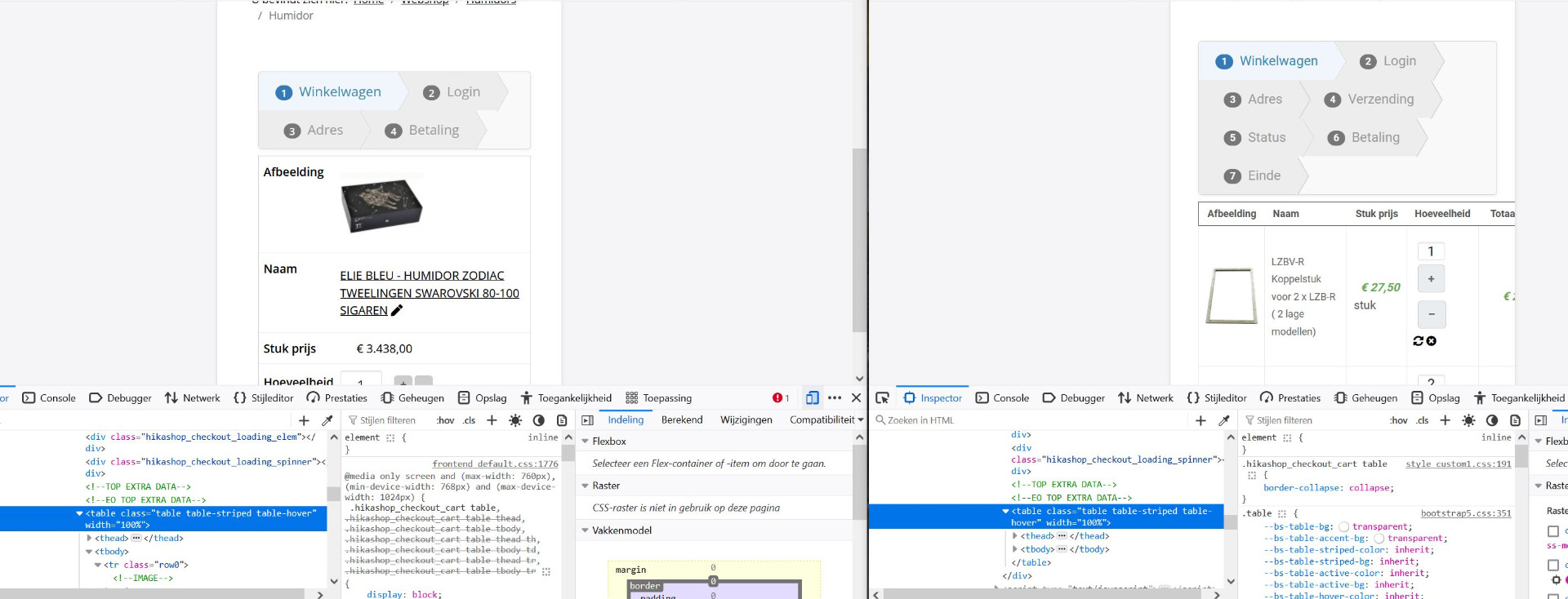

1 year 11 months ago #362521
I have another site with the same template, but there it goes well. See attachment, on the left the good one (is a another site).
I see in the firebug, see attachment, that the good site loads frontend_default.css, but the bad site is not. Is this a configuration in Hikashop (the css file is there on the same location, i checked).
Regards Michel
1 year 11 months ago #362522
There are a good chance that the style_custom is linked to your current issue, process a test without it :
Note that the style file is very old and no longer evolves, therefore potentially causing problems as here.
So, the best thing for you is probably to make a comparison (with by example with Winmerge) with a default style file to possibly recover the custom commands that your site may still need (since it is a custom version).
Last edit: 1 year 11 months ago by Philip.
The following user(s) said Thank You: zegenrijk
  • Posts: 22
  • Hikashop Business Hikashop Essential
1 year 11 months ago #362538
That's solved it, thank you, you can close this ticket.
