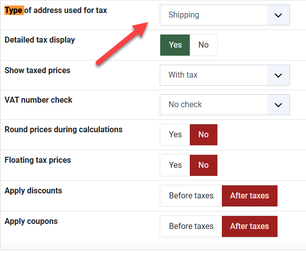

  • Posts: 233
  • Thank you received: 13
1 year 1 month ago #367325
thank you
i have set that setting to shipping but still is the same situation. payment method dosnt reloads
