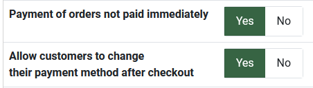

With the payment method PayPal Checkout in Sandbox mode, I tried to pay for an order in the "created" status using the "Pay now" function. However, I only received the following message:
"Payment of orders not paid immediately is not available on this website. Please contact the website administrator if you have any question."
Here are my configurations:
Is there something else I have to ajust?
Thank you!
  • Posts: 86212
  • Thank you received: 14219
1 year 3 months ago #367611
There are only two cases where this could happen:
- If you've turned off the "payment of orders not paid immediately" setting
- If you have this setting turned on, and you then downgraded your HikaShop to the Starter edition. In that case, the feature will be disabled as it is only available in commercial editions of HikaShop even if you had that setting turned on and even if you use a payment link generated when the commercial edition was installed.
It's likely you're in that second case after installing the Starter edition install package instead of the Business edition install package.
Install the latest version's Business edition and it will work again.

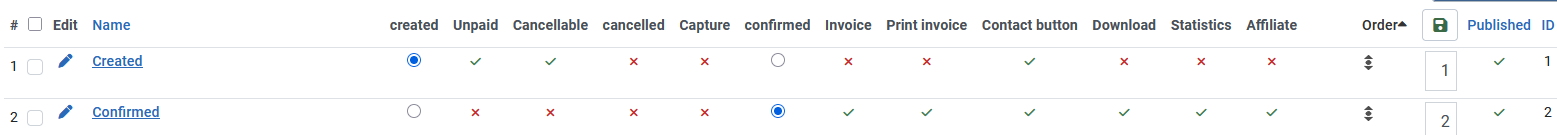

  • Posts: 9
1 year 3 months ago #367620
Here is the entry in the database
and with this value it does not work.
With $level = 1 this line
if($config->get($config->get('level'),0) >= $level) return true
returns true and then the message gets enqueued.
So I changed the level to 3 and then the Pay now function works!
