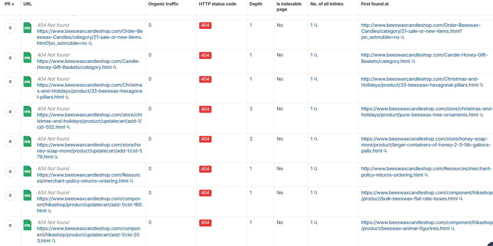

Hello - I am having a big problem with SEO on my site - Our page rank is down to 1. I have been working with ahrefs.com and google analytics to improve things.
It looks like a lot of my issues come from my hikashop program (see attached image) I must have some settings wrong. Are there some guidelines or directions I can use to improve the site?
Some of the pages in the image are pointing to checkout pages that should have been automatically removed.
Some of my friends are urging me to abandon Joomla/hikashop and use something like SHOP.COM. (I really do not want to go that direction)

6 months 2 weeks ago #369798
I tried several of the URLs noted with the error 404 on your screenshot, and they don't return a 404.
For example, the URL:
beeswaxcandleshop.com/store/christmas-an...t/add-1/cid-502.html
It works just fine and redirects to the checkout with the product in the cart if I open it with my browser. If it were really returning a 404 error, you would get an error page when opening the URL with your browser.
So, either your website was down when the tool you're using looked at these URLs, or your web server is blocking that tool from accessing the URLs.
It could for example be some strong configuration of your htaccess which would block crawlers from accessing the website, leading to the pagerank being downgraded even though everything is fine on the website.
So, from what I can see, the problem is not with HikaShop or Joomla, but the way the server / website is setup.

6 months 2 weeks ago #369837
The htaccess looks ok.
Regarding the CSV file, I tried many URLs listed in that CSV file and not once did I get a 404 error.
As far as I understand, what is in that CSV file is either outdated and flat out incorrect.
Now, I did find a problem on your website. It seems you have a caching issue on your pages.
The caching is too agressive which leads to the checkout pages being cached when they should not, which means that you can see the cart of someone else or another state of your cart when access the checkout based on the URL used.
This is a problem and this might be why the checkout pages get incorrectly indexed.
You should disable page caching on your website. Or at least configure it in a less agressive way.
This could be why you get SEO issues on your website as crawlers might see things which are old generated pages instead of the current version of pages which apply to them.
