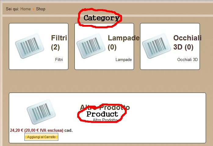

Good morning to all
I can not remove the products below the list of categories .....
I wish that I appeared on the page only the categories, but I can not remove the products ........
I tried in every way but I did not succeed ..... give me a hand please ....
Thanks a lot.
Fabio

12 years 10 months ago #122465
I'm sorry for the delay in the reply, but I was away on business. I attach a screen shot, because the site is off-line. On the page, I want see only the icons of the product categories (which, by clicking on it, open the pages with the products of those categories), and not the products below ..... I tried (I think) in all manners, but I did not succeed. Pay no attention to graphics, is still to be done .... :blush:
Thank you very much for your interest. Fabio

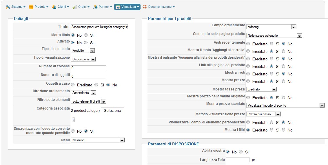

  • Posts: 4
12 years 10 months ago #122478
Yes .... this is strange, even though I have everything turned off, the products remain under. attaching one screen shot.
Thanks for your interest.Fabio
  • Posts: 64
  • Thank you received: 5
12 years 10 months ago #122499
Did you check: Configuration>Display>Main Module Standard Options>Visible Modules in Main area?
  • Posts: 85860
  • Thank you received: 14106
12 years 10 months ago #122601
It could also be that your products are attached to the main category. Please check on that too.
