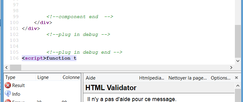

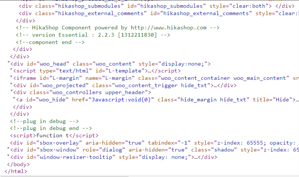

2 some code appear in the end of the page
i really don't know how this occur

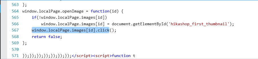

1-- Since hikashop don't use jquery and osm use it , i have a look to hikashop.js and i try to change
function stopPropagation() { this.cancelBubble = true; }
to
function stopPropagation() { this.cancelBubble = false; }
and it is working now !!!
I think this code is refer to how event is capture by DOM hiearchy function .
Is it safe to do the change i make in this javascript code ?
2-- the end of the file is truncate
</body></html> seem remove refer to my index.php code !!
<script > content is truncated
Regard's
http://www.javascripter.net/faq/canceleventbubbling.htm
http://javascript.info/tutorial/bubbling-and-capturing
Last edit: 12 years 7 months ago by lionel75.
