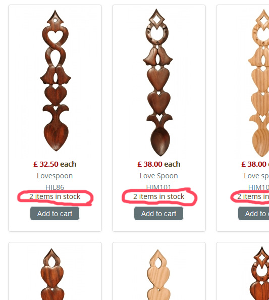

  • Posts: 114
12 years 4 months ago #153071
the red area in the pic... how to remove fromview please thanks
12 years 4 months ago #153083
Using this kind of CSS code will probably do the job :
.hikashop_container .hikashop_product_stock_count {
display: none;

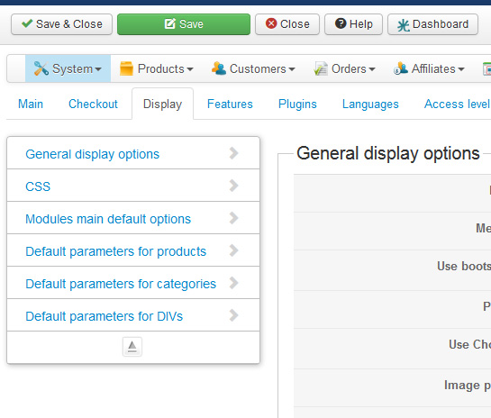

12 years 4 months ago #153260
As it's said on the documentation :
All these CSS modifications can be done via the CSS edition interface in the Display tab of the configuration ("Hikashop->System->Configuration->Display"):
  • Posts: 114
12 years 4 months ago #153731
where!?!??!
sorry but i dont get it
