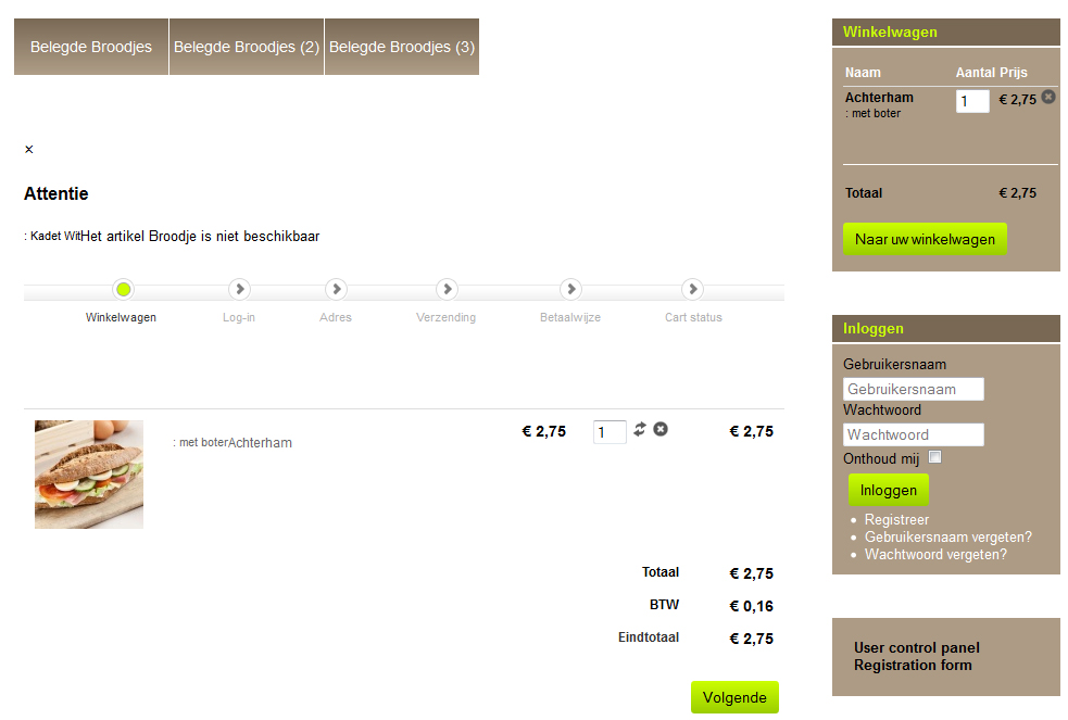

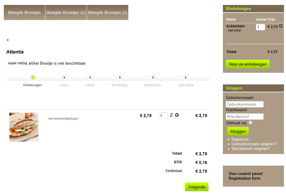

-- Error-message(debug-mod must be tuned on) -- : (in dutch) Het artikel Broodje: Kadet Wit is niet beschikbaar
For a webshop selling sandwiches, i made variants of bread the customer can order.
Kadet white
kadet brown
Multicorn (+0,50)
So when a customer orders a sandwich with cheese, they can choose on what type of bread they want it.
The problem:
Some variants are with no price (kadet white). But when you add the article with kadet white to the cart and proceed in the ordering process, an error occurs. (in dutch) Het artikel Broodje: Kadet Wit is niet beschikbaar (engish, the article is not available?)
The variants with a price (like multicorn) works ok!
My client doenst want a price on the kadet. In theorie u can make the product € 0,10 cheaper, and add a variant of € 0,10. But my client doenst want that.
Can you help me out? Why is it obliged to have a price?

12 years 4 months ago #146457

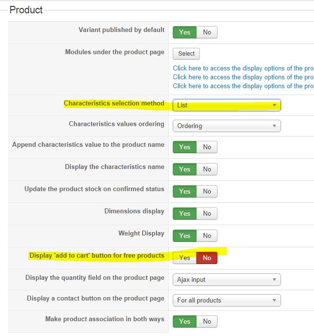

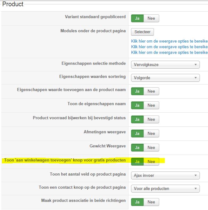

It's probably doing that because you turned off the option "display add to cart button for free products" in the configuration of HikaShop.
The following user(s) said Thank You: plaag666
  • Posts: 37
  • Thank you received: 4
12 years 4 months ago #146474
Excellent, i changed the option to yes, and works fine.
Thanks!!

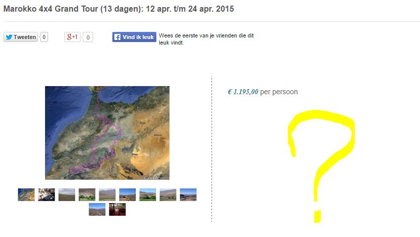

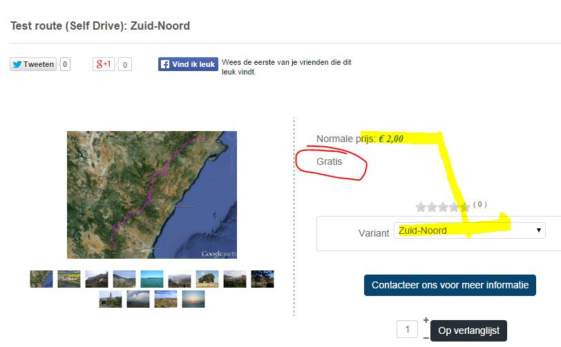

Hoped I could solve this issue just by switching on the Free product button.... But no, it didn't work for me.
I created 1 set with 3 variants, and left everything to default. On the product the variants appeared, but vanish when I select a variant.
I fiddled with the prices and other properties of the variants, but no luck.
What's next?
Thanks, Eric

  • graveltravel
11 years 10 months ago #169831
I did a lot of fiddling with the variants. But no way that I managed to get it working. I removed and added the variant, added and removed mrsp and other prices, tried all possible combinations. Added additional properties to variants, changed from physical to virtual products, and vice versa. Turned on Free products' button.... But whatever I do, it simply won't work. The cart button keeps disappearing when a variant is selected.
I did remove some of the Views a couple of weeks ago. But I guess that has nothing to do with viewing buttons when selecting another variant.
So, a friendly but urgent request to have a look at this issue!
Thanks, Eric

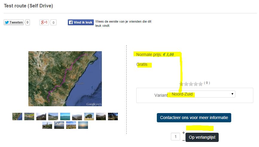

  • graveltravel
11 years 10 months ago #169839

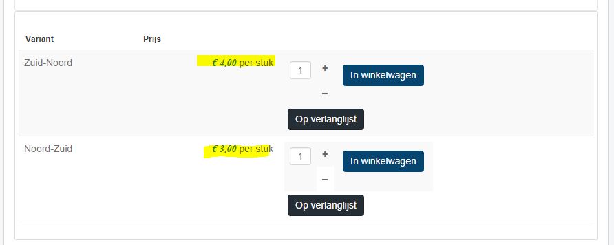

More fiddling, my conclusion: there is something seriously wrong with the variants. I did the following simple test:
I created the following product with 2 variants:
Main product: mrsp 1 euro
Variant 1-1: mrsp 2 euro
Variant 1-2: mrsp 3 euro (default variant)
In the shop I selected the product, and saw the following:
The Normal Price is taken from the default variant, 3 euro's. That is incorrect, should be the mrsp price of 1 euro coming from the main product. The second price says Free (gratis), that is also incorrect because the price is 3 euro's for variant 2 which is the default. And where is my cart button? Also not good! See image below.
Attachment not found
If I select Variant 2 the price changes to 2 euro, Which is correct. But the cart button still does not appears, and the sales price of the product remains Gratis (free), incorrect.
Using the Pricing tables of the products and variants gives more less the same results. I did found a combinated use of mrsp and price table that gave the correct price on screen, enabled the cart button, but resulted in a 0 euro product in the cart. Which was also incorrect.
Guys, have a look, this is really not how it should work. Or give me clear instructions to solve this.
Awaiting your professional reply, Eric ;-)
  • graveltravel
11 years 10 months ago #169849
Just did another combination that failed ;-( I removed the mrsp prices from the main and variants, and stored the prices in the price table. The Free (gratis) is not there anymore and the prices seem to be okay. But when selecting another variant the cart buttons are removed. Not funny ;-)

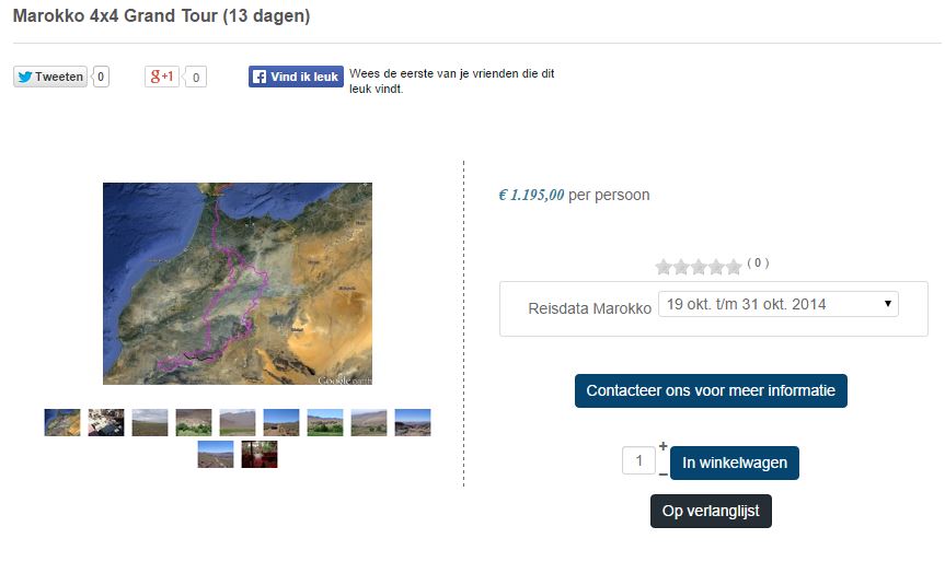

If I choose List as layout for the variants it works.The Dropdown, Table and Radio Button are all having the same problem. And finally the Dropdown and Table have the same layout, what shouldn't be the case.
So, I believe that the script behind the on-change event on the Dropdown and Radio Button is not okay.
Kind regards, Eric

11 years 10 months ago #169975
Thanks for your reply :-)
I did not make any changes to the HTML wahtsoever. So, this can't be causing the problem.
To avoid problems I've temporarely chosen the 'list' layout for variants. It works, but is not what I want :-) The list with variants is shown below the product descriptrion. I'll set it back to dropdown so you can see the result yourself. The link I've send you does have variants. So does the other products under Reizen/Groepsreizen (= Travel/Group Travel). The variants are the scheduled periods.
I did send your credentials a few weeks ago. If you need them again to logon just let me know ;-)
shop.graveltravel.nl/product-groepen-4x4...akantie-marokko.html
Kind regards, Eric
