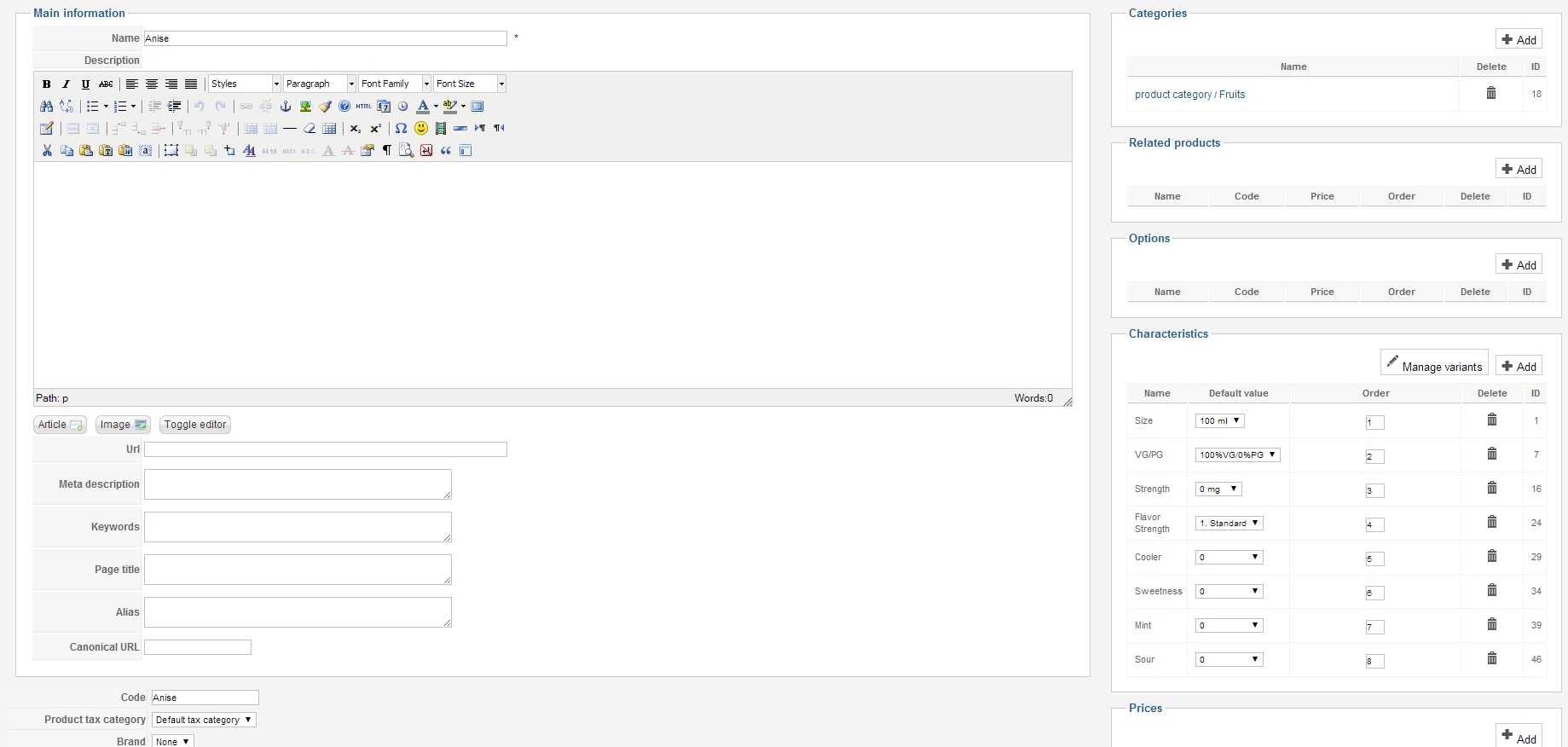

Could you do a screenshot of the options of your product so that we can see how you configured it ?
Did you modify any code in HikaShop ?

12 years 4 months ago #147925
The problem is probably coming from the fact that you have too much characteristics.
For example, if you have 3 characteristics with 10 values each, that's 10*10*10=1000 possibilities. That's already too much.
You should indeed transform some characteristics into custom fields ( www.hikashop.com/en/support/documentatio...p-field-listing.html ) or options ( www.hikashop.com/en/support/documentatio...ct-form.html#options ) so that it becomes more manageable for your server.
Characteristics should only be used when you want to change some of the information on the products (the stock, the price, the image, etc). For choices which do not affect any of that custom fields of the table "item" are the way to go.

  • Posts: 16
12 years 3 months ago #150383
I have EXACTLY this same problem, except I already have options and no characteristics for the products themselves. (the options have)
I added my second product and suddenly POOF. Error 500.
[Tue Apr 01 01:04:26 2014] [warn] [client 84.80.63.27] mod_fcgid: stderr: PHP Fatal error: Allowed memory size of 67108864 bytes exhausted (tried to allocate 71 bytes) in ..libraries/joomla/language/latin_transliterate.php on line 156, referer: www.dampsmaken.nl/administrator/index.ph...roduct&task=edit&cid []=81
[Tue Apr 01 01:08:56 2014] [warn] [client 84.80.63.27] mod_fcgid: stderr: PHP Fatal error: Allowed memory size of 67108864 bytes exhausted (tried to allocate 71 bytes) in ..libraries/joomla/language/latin_transliterate.php on line 156, referer: www.dampsmaken.nl/administrator/index.ph...=product&filter_id=2
I can't delete the item, i can add other items and delete them, just not this one item. I have deleted its options, images, settings, and tekst but i cant save my changes anymore. im stuck with just this product not working and causing FATAL ERRORS.
I have 6 options, those options all have characteristics so they are grouped. My products themselves just have the options, no characteristics for themselves. Is this still a problem ? If so, i might need a refund ;(
Is there a way i can sanitise the database or something else i can do ? I think my db is messed up.
