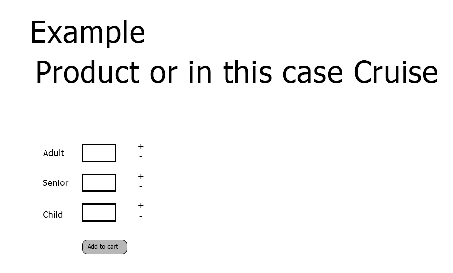

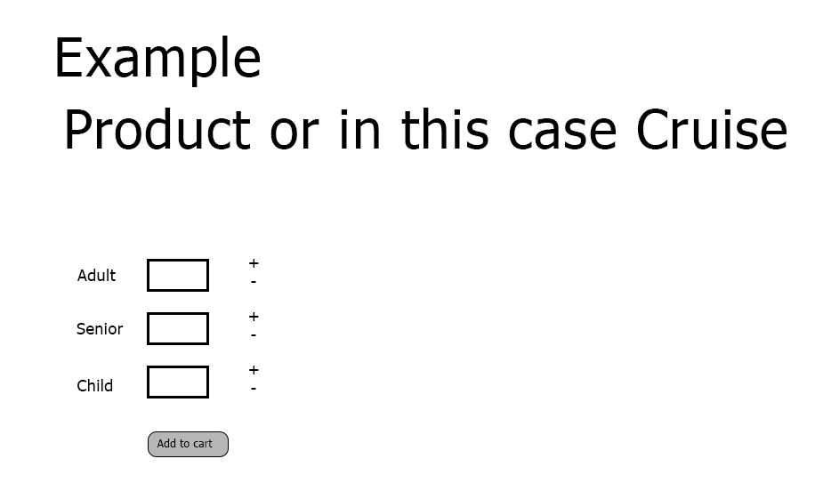

12 years 5 months ago #150365
Afternoon Nicolas,
I tried your suggestion and it did not work like I thought it would. I have attached a small file with an example of what I would like HikaShop to do.
Thanks for your help. If you would like to go into the website please let me know so that I can give you the correct information.

That is closer but do I need to have three "add to cart" buttons? I would prefer that I select number of adults, seniors, children then add to cart. Since once you hit add to cart it takes you out of the product, and now the customer has to return to do another age group.
