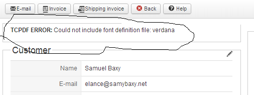

We're facing an issue with the attached document to the confirmation email. Whenever the productClass = hikashop_get('class.product'); through is called in, it loads well
But when productClass->get ($ product_id) is called the plugins breaks and print a pdf error failing to include the verdana font file
Do you have any idea why we're facing this issue and anyway to solve it ? Thanks.

Could you give us the error message, or a screenshot of the error ?
Any line indicated ?

Now when this segment of code is run
$productClass = hikashop_get('class.product');
		$product_id = $order->products[0]->product_id;
		$product = $productClass->get($product_id);
The error on the attachment is seen.

The first problem is not related on the product class, but on the font used.
This font is not included in TCPDF.
www.yaronet.com/posts.php?s=133399

Regarding what you stated on tcpdf, I'll probably try to include the font. But the issue is that when i dont include a call to the product class, it works seamlessly without hiccups.

That's maybe because this font is called only for the product data, but it's strange.
Thanks to try to include the font and see if it's working fine.
