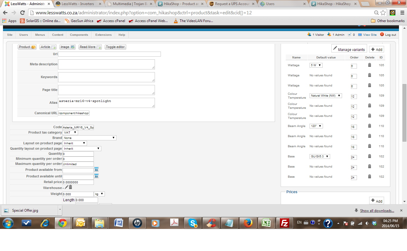

As for the characteristics, it is working now, but whenever I save a product, another complete set of characteristics gets added - see the attached screenshot.

12 years 2 months ago #160278
It's probably related to the fact that the variant table was missing.
Try again with the debug mode of the Joomla configuration turned on. Do you get some error ?
If you try with a new product, do you also have the problem ?

I checked your website backend queries and from what I can see, the problem is that the primary key on the columns variant_characteristic_id and variant_product_id has been removed from the table hikashop_variant in your database.
Because of that, the "replace" query that is done on that table duplicates the entries instead of replacing them when a product data is saved.
So it's not a bug but apparently that table has been tampered with in your database.
The best will be to drop the hikashop_variant table completely from the database via your phpmyadmin and add it back with that query that you can execute via your phpmyadmin too:
CREATE TABLE IF NOT EXISTS `j16_hikashop_variant` (
	`variant_characteristic_id` int(10) unsigned NOT NULL,
	`variant_product_id` int(10) unsigned NOT NULL,
	`ordering` int(10) unsigned NOT NULL DEFAULT '0',
	PRIMARY KEY (`variant_characteristic_id`,`variant_product_id`),
	KEY `variant_product_id` (`variant_product_id`)
) ENGINE=MyISAM
Then, you should not have that problem when adding characteristics to your products.
