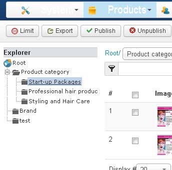

I am using hikashop business
I am also using the Template from Gavick pro - gkstorefront
I have set up a couple of categories and a couple of products.
My first problem is that there is a message under the categories listing on the front end saying "This listing style is currently not supported" I have searched this in your forum and can find no answer.
the categories listing on the front end shows it has 4 products.
I have added the category to the product in the product listing page - but when I click on the category it goes to another page for that category listing.
I have watched many tutorials now and feel that I have the structure right, maybe there is a setting that is wrong.
It just appears to me that the categories should be listed on the front end and then they should be clickable to the list of the products under that category then on to the desired product. I just cant seem to be able to make the last two happen.
Help would be appreciated.
Sandra
