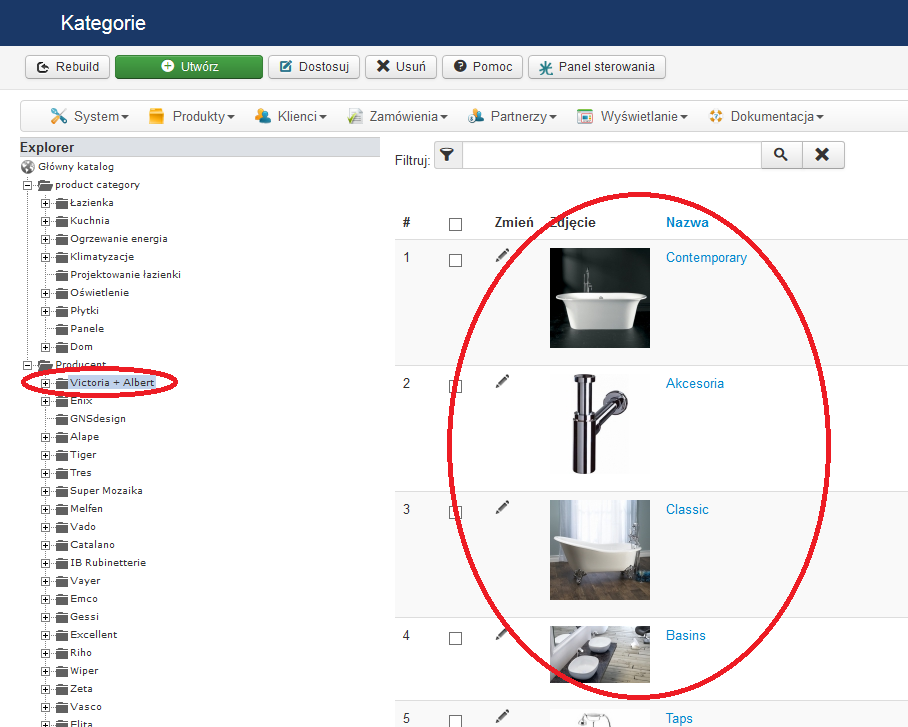

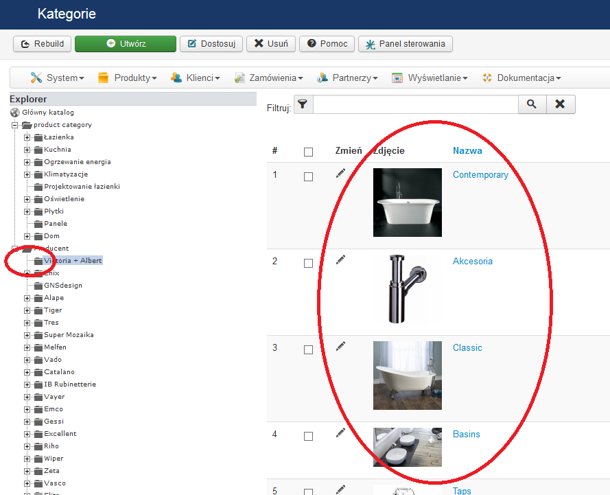

as you will see at prntscr one, I have many manufacturers created, manufacturers have series, so for example manufacturer tree looks like this:
manufacturers
- Some manufacturer name1
-- Some series name1
- some manufacturer name2
-- some series name2
and so on...

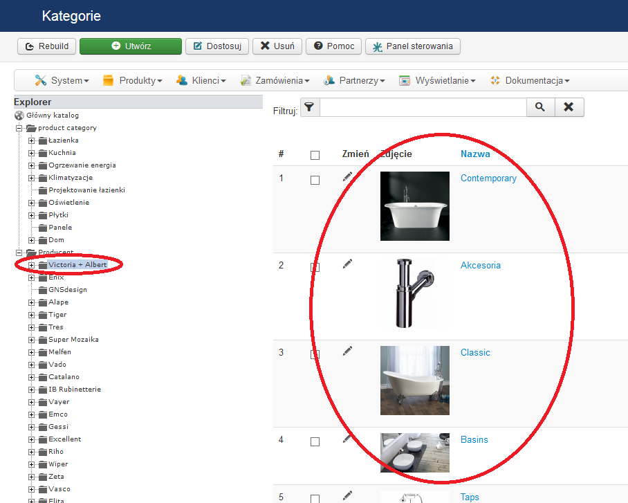

While browsing manufacturer tree (under explorer /left sidebar/) I have a plus sign [+] opposite to manufacturer name if it has series inside (print screen one) - that's ok.

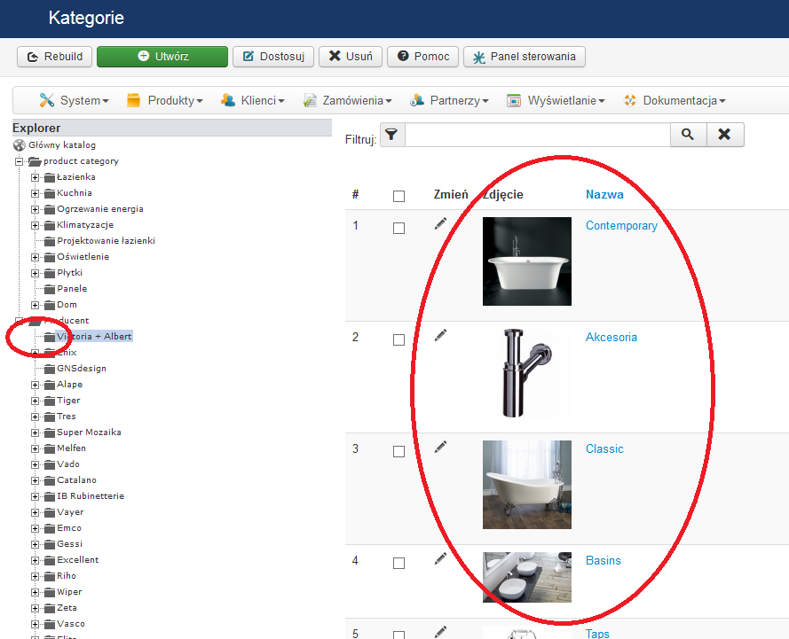

If I click that plus sign no series are appearing and plus sign is disappearing (print screen two) - that's not ok.

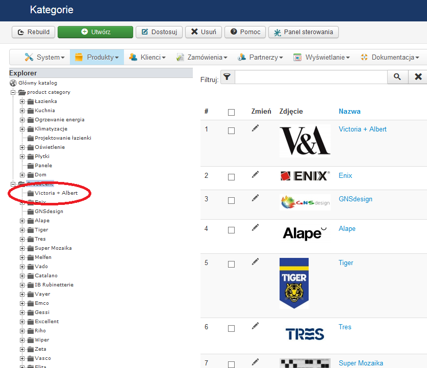

If I click on manufacturer name (not plus sign) you can see on the righ all series from this manufacturer /the plus sign is reappearing/ (print screen three).
Still while in manufacturer which has series inside, clicking on plus sign just hides it and no manufacturer categories from level2 are appearing.
For product category tree all plus signs are working fine.
What's wrong? :(

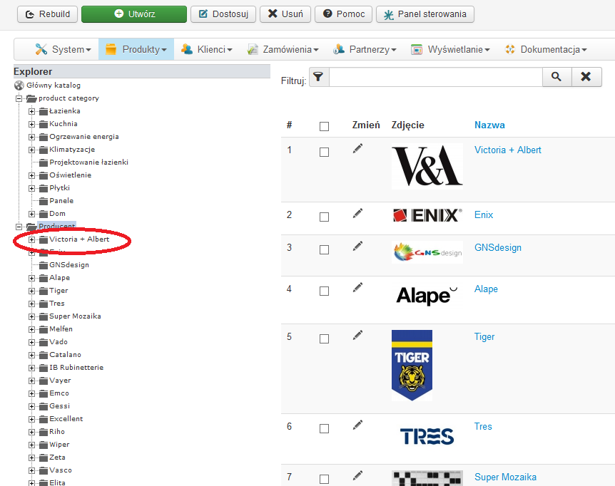

  • Posts: 42
10 years 11 months ago #209051
thanks to your codes explorer is working fine now, however still I can't add manufacturer to product (while crating product on backend), I have available only my series (level two of brand tree), there're no level 1 brands (manufacturers).
