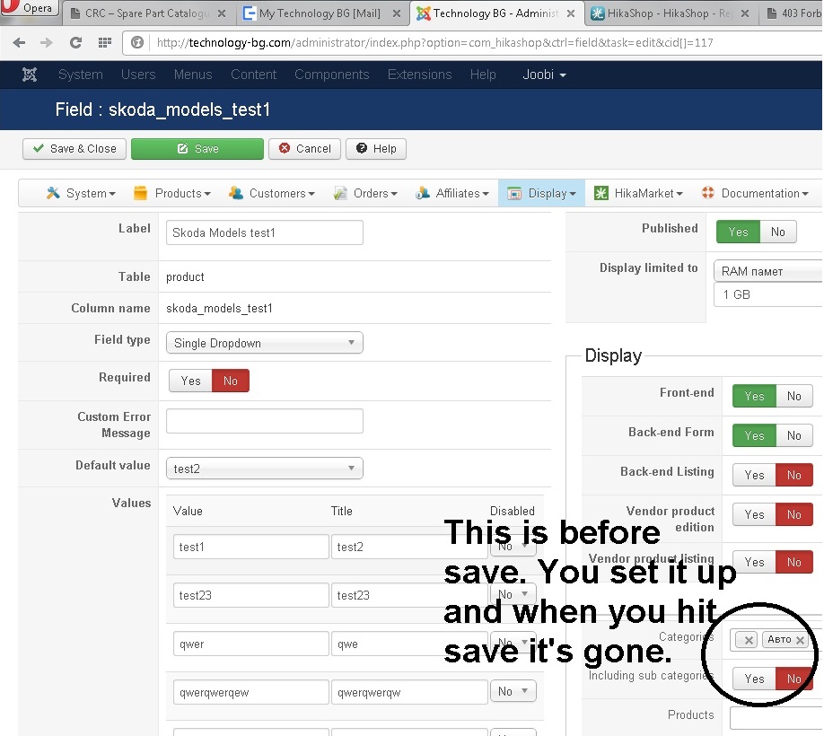

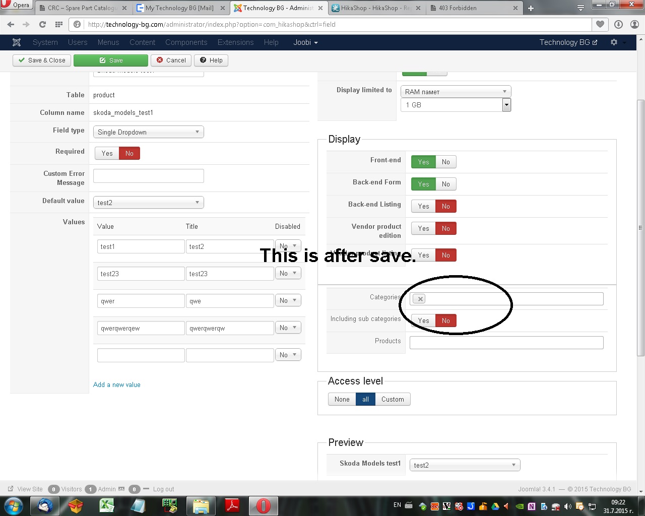

  • Posts: 14
10 years 11 months ago #210231
Hello ,
1. Attached is the screen shot of how the category looks after you give it some value and save it.
2. About your demo site i can't access the admin panel it's "You don't have permission to access /administrator on this server. " error 403.

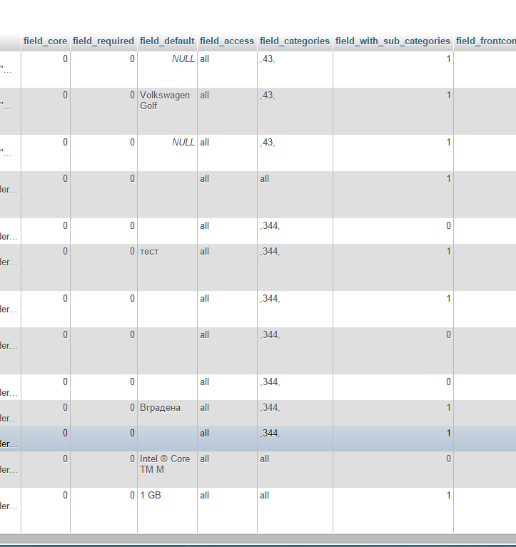

  • Posts: 14
10 years 11 months ago #210441
Hello ,
Attached is a screen shot of the data base and how the values look.
And the version is HikaShop [1507081626] .
Also i forgot to mention that this worked in the past, there are fields that were created with version 2.3.1 i thin and work but when we open them it's in the edit menu and save then the problem starts with them also.
Thanks in advance for all the help.
