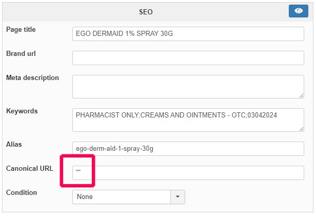

2 years 5 months ago #360178
this was working (i.e. replace with a string that is empty) but it's started including quotes in the canonical fields instead of a blank field. Can you check and let me know. Using the latest version as at today.

2 years 5 months ago #360180
More info. This only seems to be happening on our joomla3 site and not our joomla4 site.

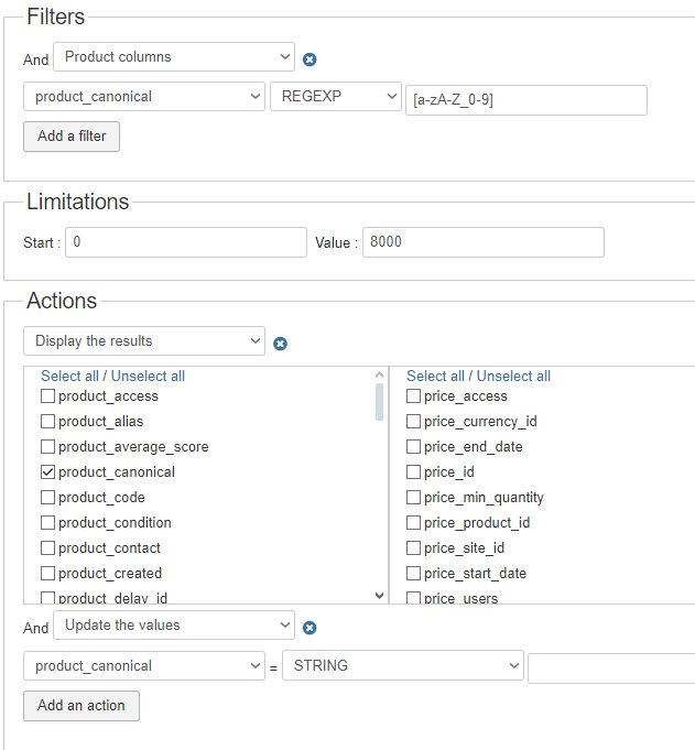

2 years 5 months ago #360182
Could you provide a screenshot of the mass action ?
  • Posts: 203
  • Thank you received: 16
2 years 5 months ago #360184
here's the mass action and the field in the product.
Thanks for taking a look,
Ian & Stu
  • Posts: 86183
2 years 5 months ago #360200
I'm not able to reproduce the issue. I tried on both Joomla 3 and Joomla 5 with the latest version of HikaShop, the 5.0.4, and I didn't had the issue.
So there must be something else to it.
Maybe another mass action ?
Or you're actually not on the 5.0.4 ?
