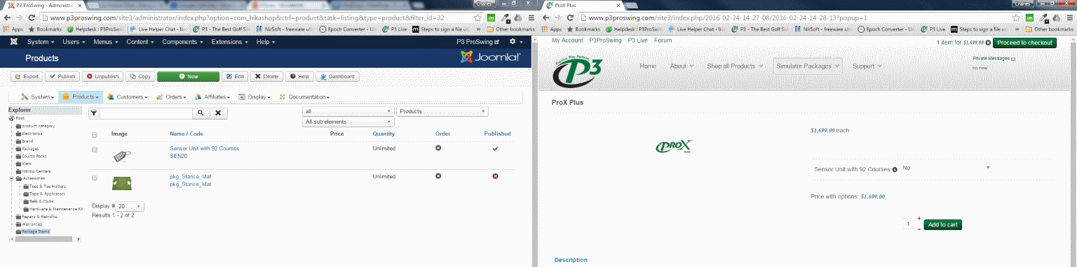

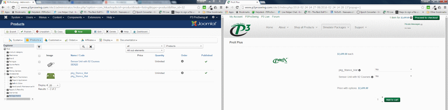

10 years 3 months ago #235030
Unpublished Image:
Published Image:
Note how when it is not published that it does not show as an option. My comment regarding customers being able to add it at $0.00 was just a question.

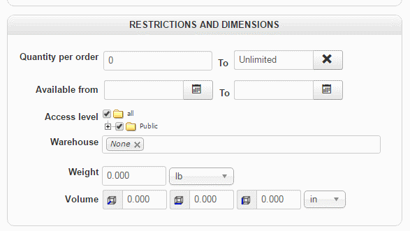

Couldn't you add a button to 'Add another box' in the Restrictions and Dimensions section?
Then if a Product had multiple boxes in it, you would have them on the product page and calculate shipping from that. It would be MUCH easier than having hidden options without a 'No' selection. By having the hidden options, I now cannot use the options on other products because the 'No' has been removed in the code.
