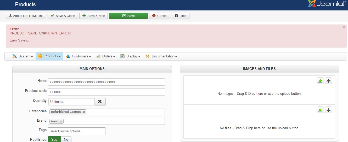

CANNOT ADD NEW PRODUCTS
  • Posts: 2
10 years 10 months ago #217437
-- Joomla version -- : 3.4.4
-- PHP version -- : 5.4.45
-- Error-message(debug-mod must be tuned on) -- : Error
PRODUCT_SAVE_UNKNOWN_ERROR
Error Saving
WHEN I ADD A NEW PRODUCT AND I TRY TO SAVE I RECEIVE THE ERROR:
Error
Error Saving
THE PROBLEM APPEARED AFTER UPGRADING TO HIKASHOP ESSENTIAL.

10 years 10 months ago #217438
Please go in the HikaShop configuration panel and click on the "check database" button.
It is possible that your database is not fully up-to-date which could explain the saving issue.
If it does not fix the issue ; it could be interesting to display the PHP error message and to activate temporally the Joomla debug mode (these two options are in the Joomla global configuration).
