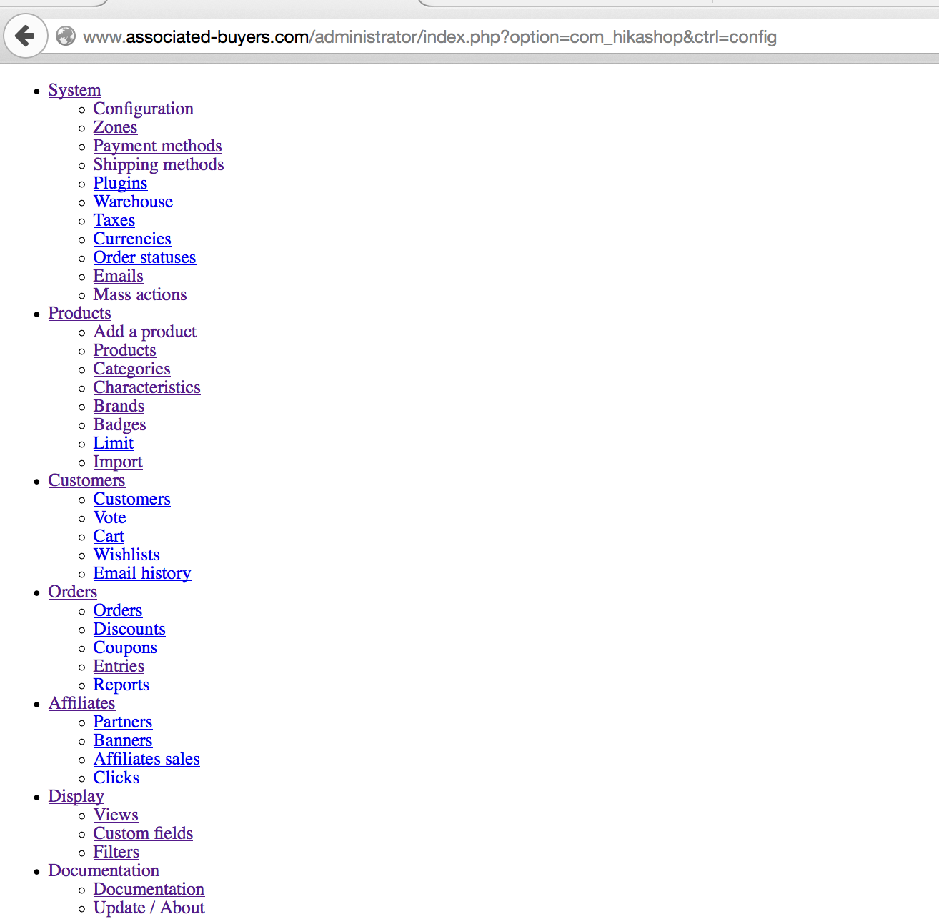

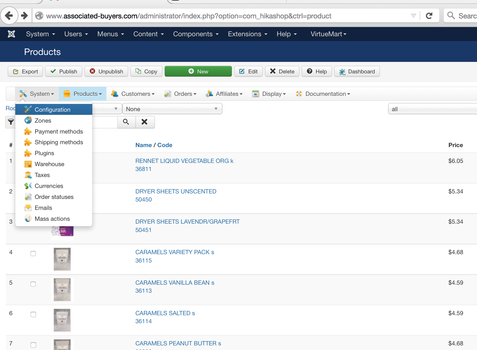

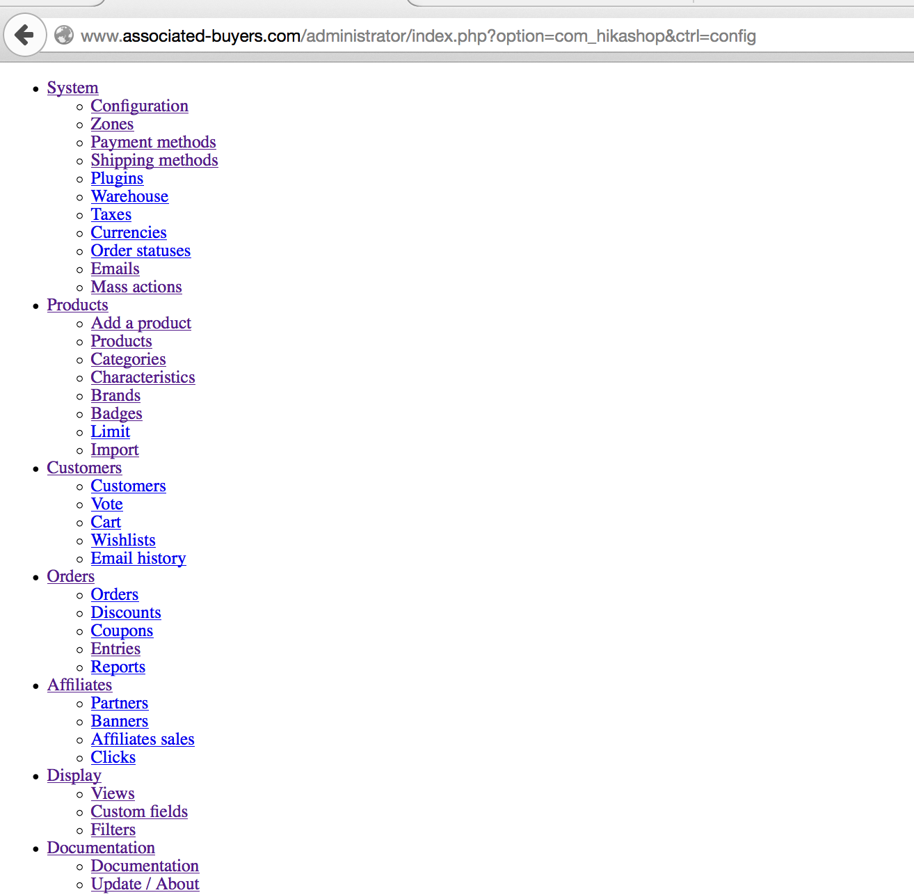

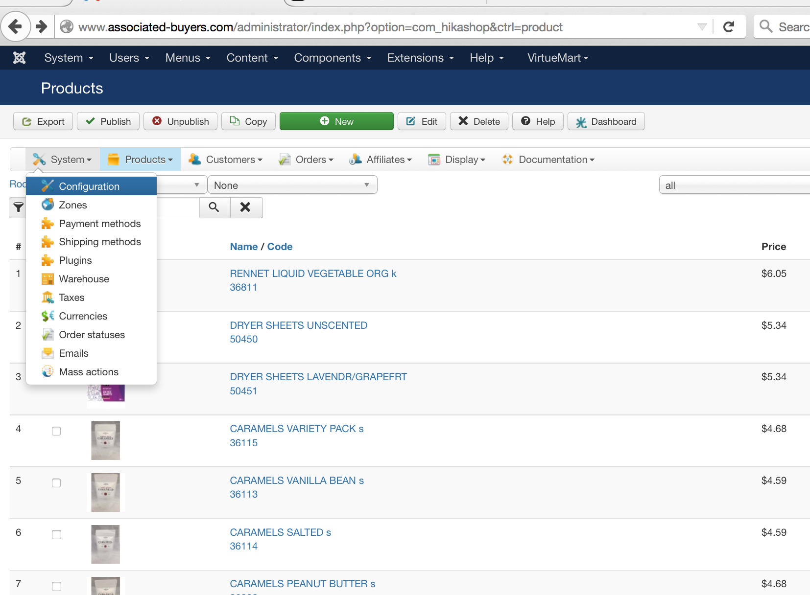

Somehow I made a change that has caused the config page to come up in list form.
Can you advise how to switch back.
Two screenshots attached, page I click to link - then config page.
Thank you.

Please check your PHP error log ; you have a PHP Fatal error in your configuration page (which is generated at the bottom of the page but might be not visible in the page).

The function "getNameboxData" is in the HikaShop Zone class since HikaShop 2.5.0
Are you sure that you right updated HikaShop ? That Joomla have write permission on all HikaShop files ?
That you do not have a class override for the HikaShop zone class (which does not extends from the original one...) or a system plugin which would re-define it ?
administrator/components/com_hikashop/classes/zone.php
