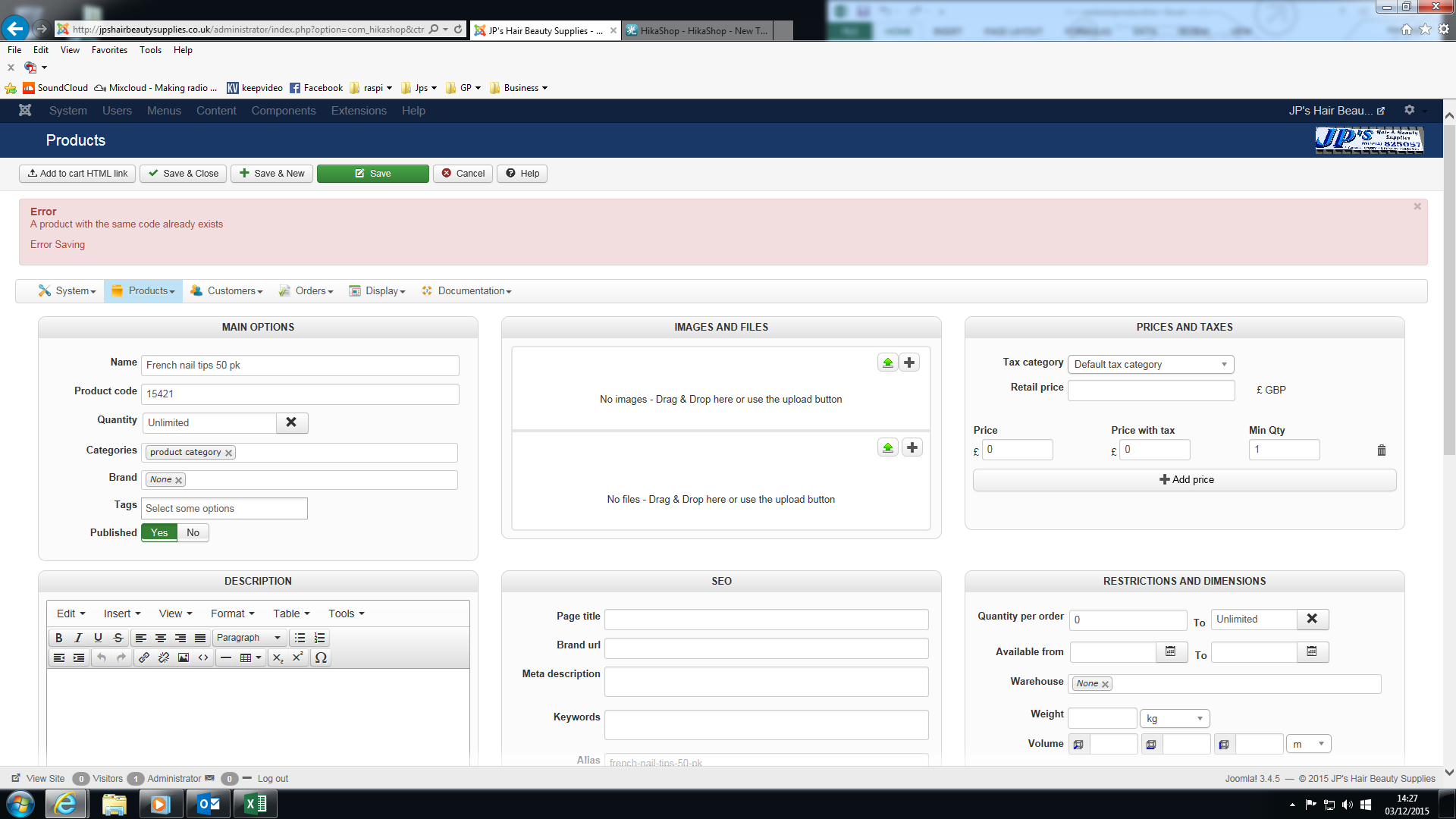

-- Joomla version -- : 3.4.5
-- PHP version -- : 5.6.16
-- Browser(s) name and version -- : All
-- Error-message(debug-mod must be tuned on) -- : Error

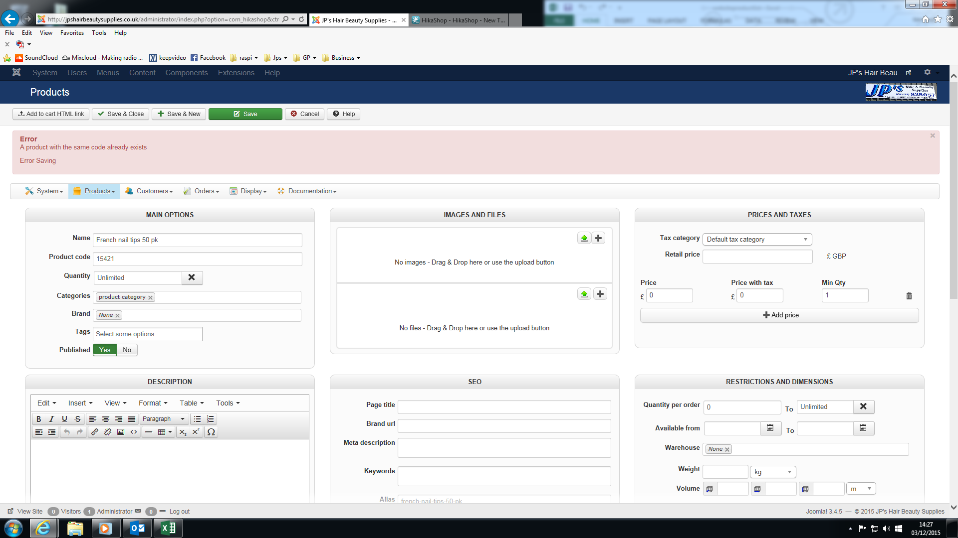

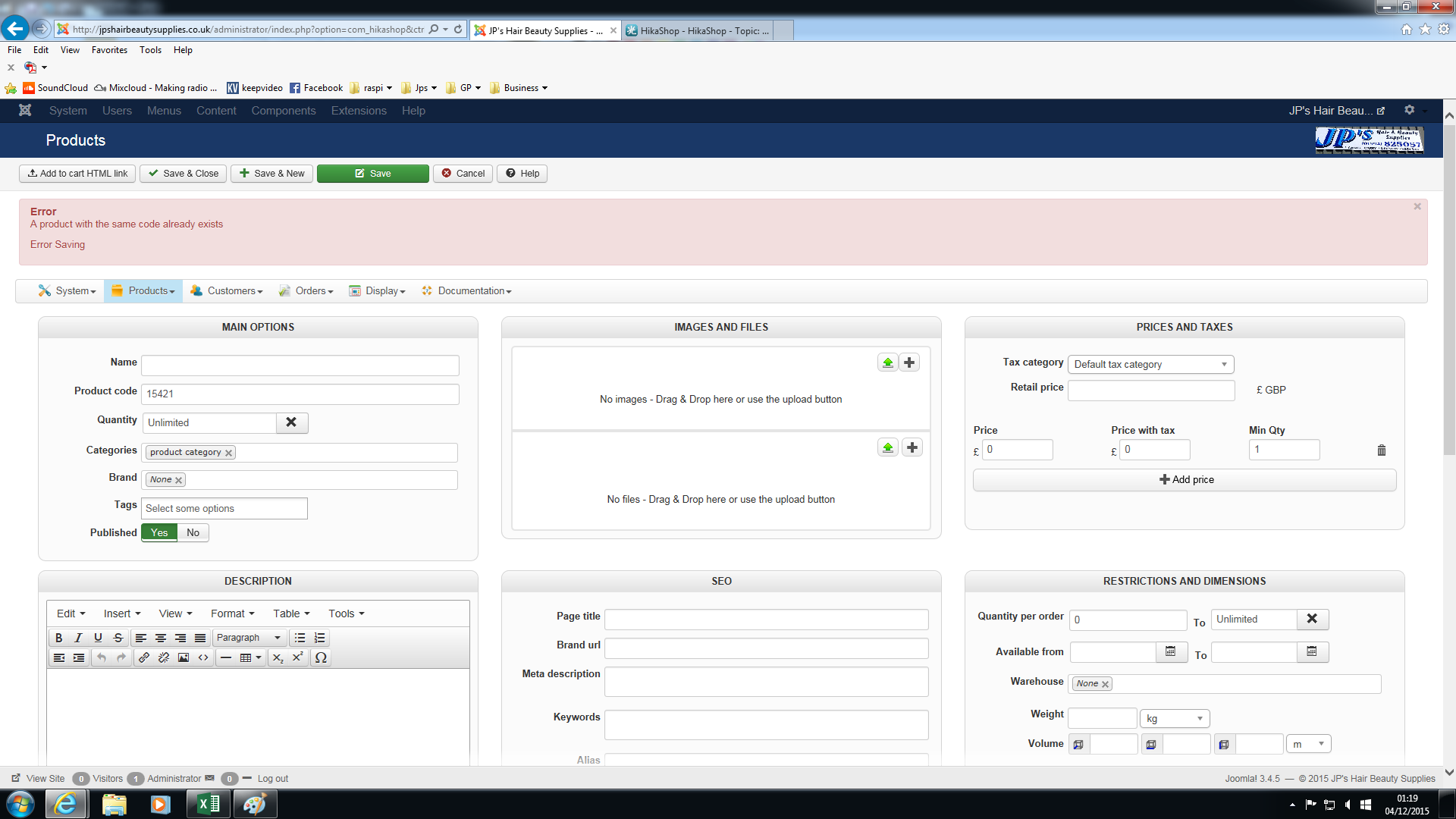

A product with the same code already exists
Error Saving
Message Error
Error Saving

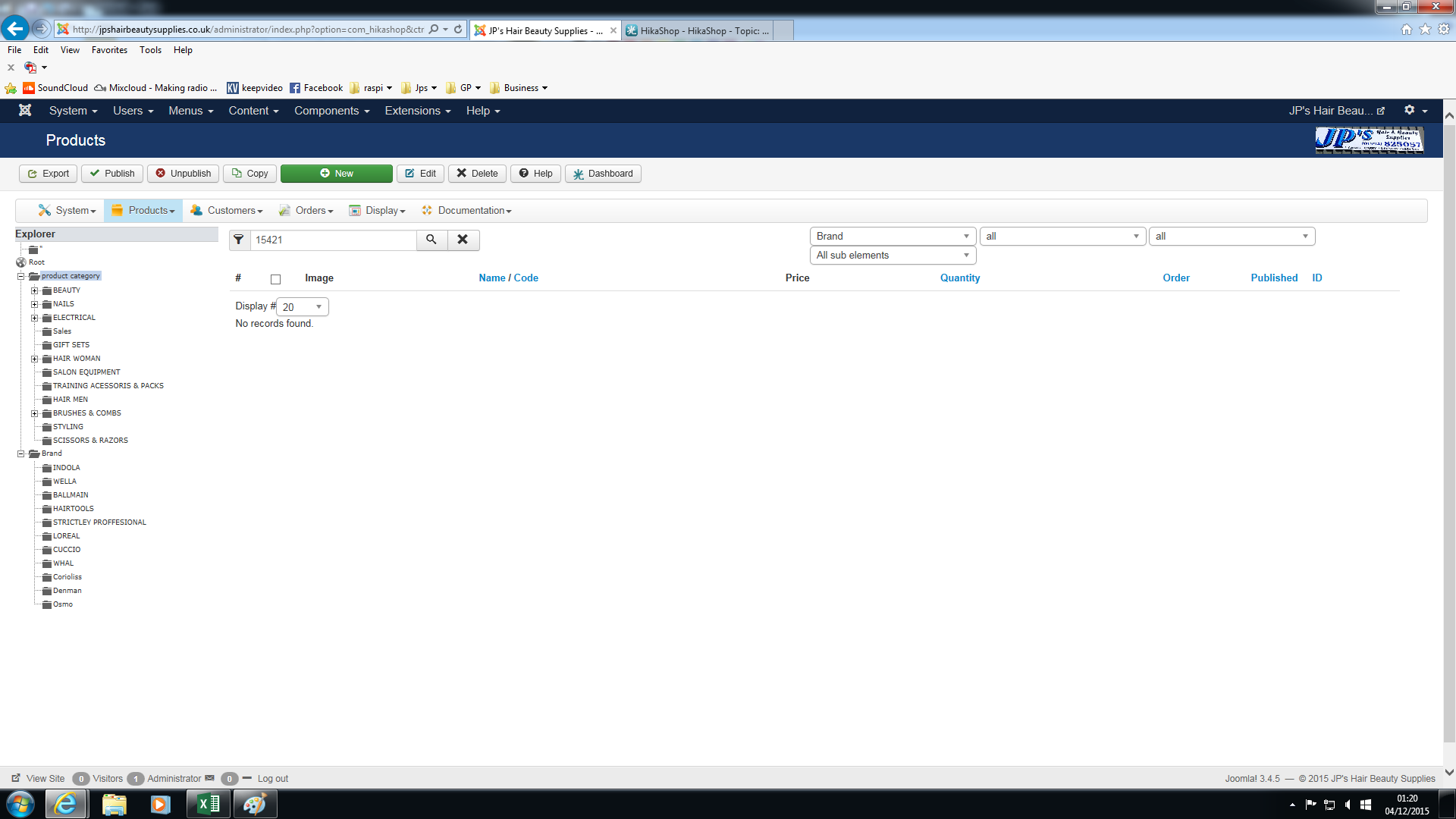

how ever the product is not in the product list ?
the code is not showing when searched for ?

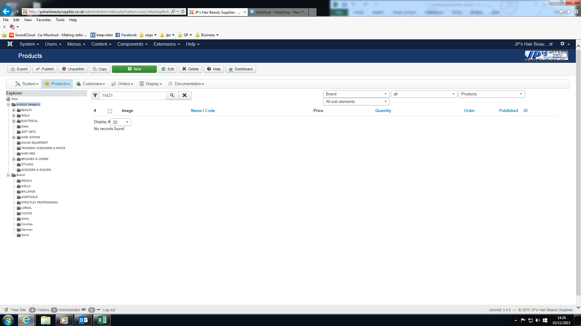

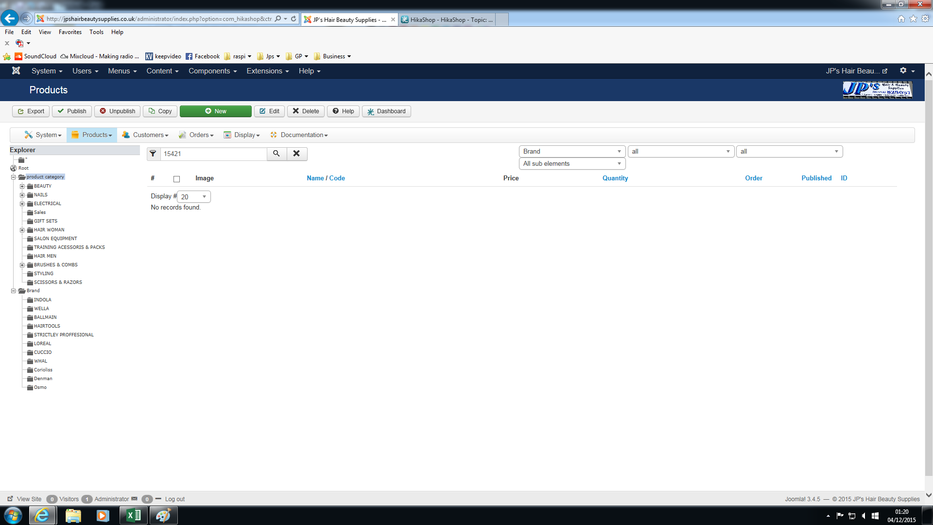

Change the "products" dropdown on the top right of the products listing to "all". That way you'll also see the variants on the products listing and if you search for the product code you'll probably find it used by a variant if it's not used by a product.

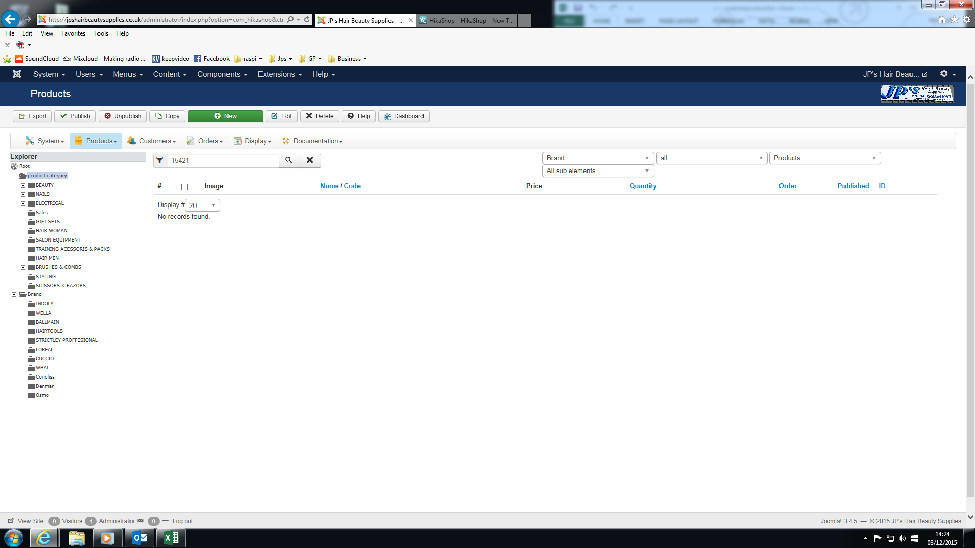

we have changed the selection to all
still not showing up and still saying product code already used.

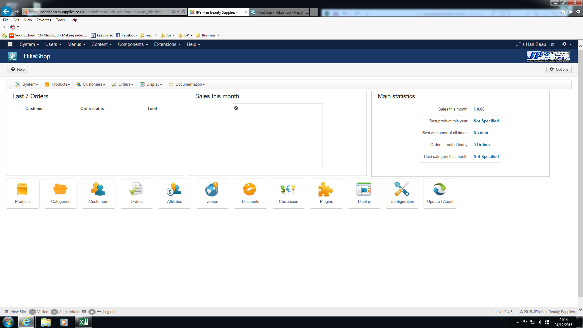

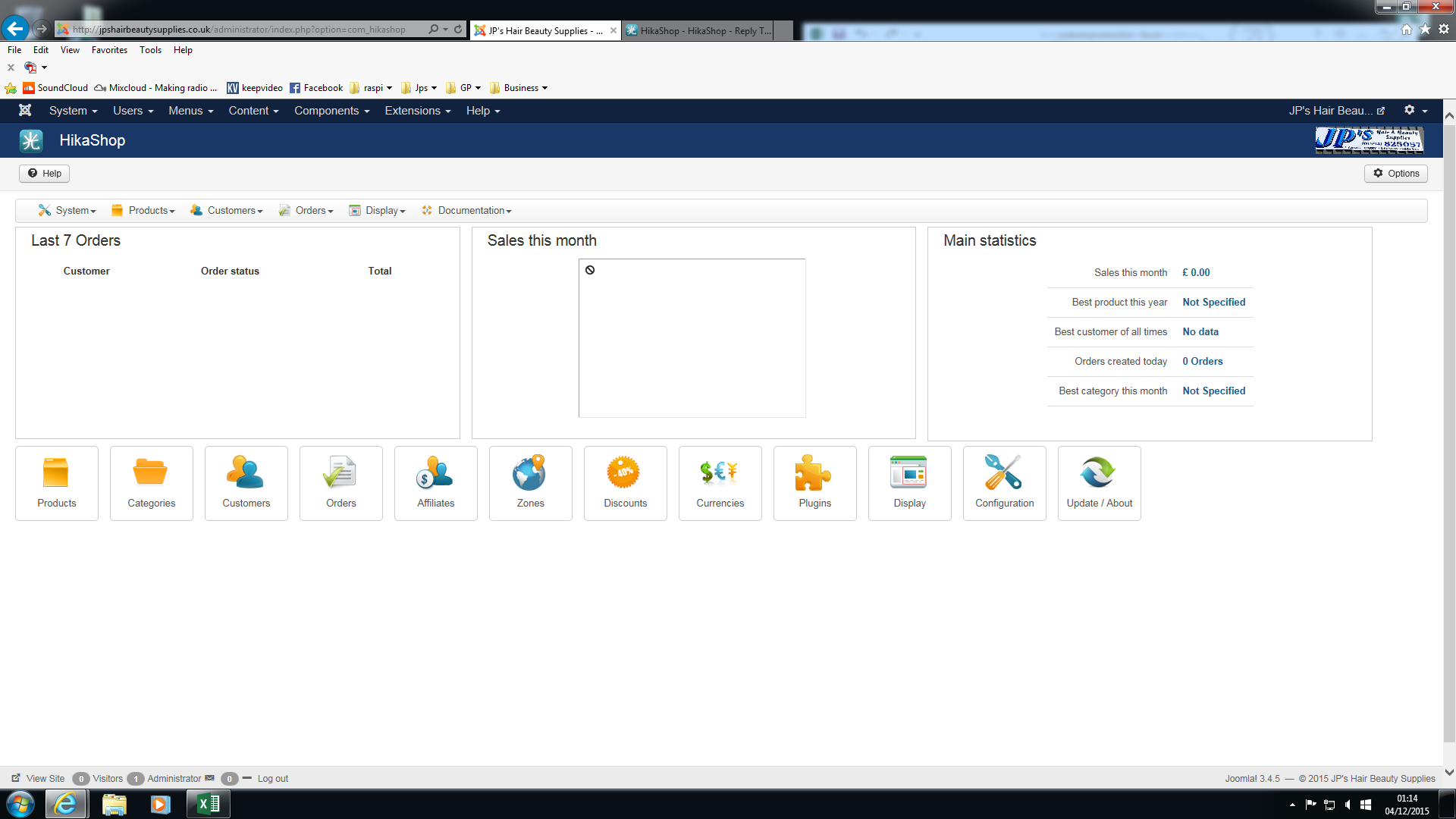

Also we have noticed we have lost the Sales this month from the dash board.
It all started when the website crashed about 2 days ago.
Does this mean we have lost 5 weeks of work and would have to start all over again.

then create a new mass action via the menu System>Mass action with a filter on the column "product_code" with your product code and an action "display the results". When you process it, that will display the entry with that product_code if any. If not, it really means that there is no product with such code.
Regarding the dashboard, it indeed seems that you removed all the orders data that you had.
