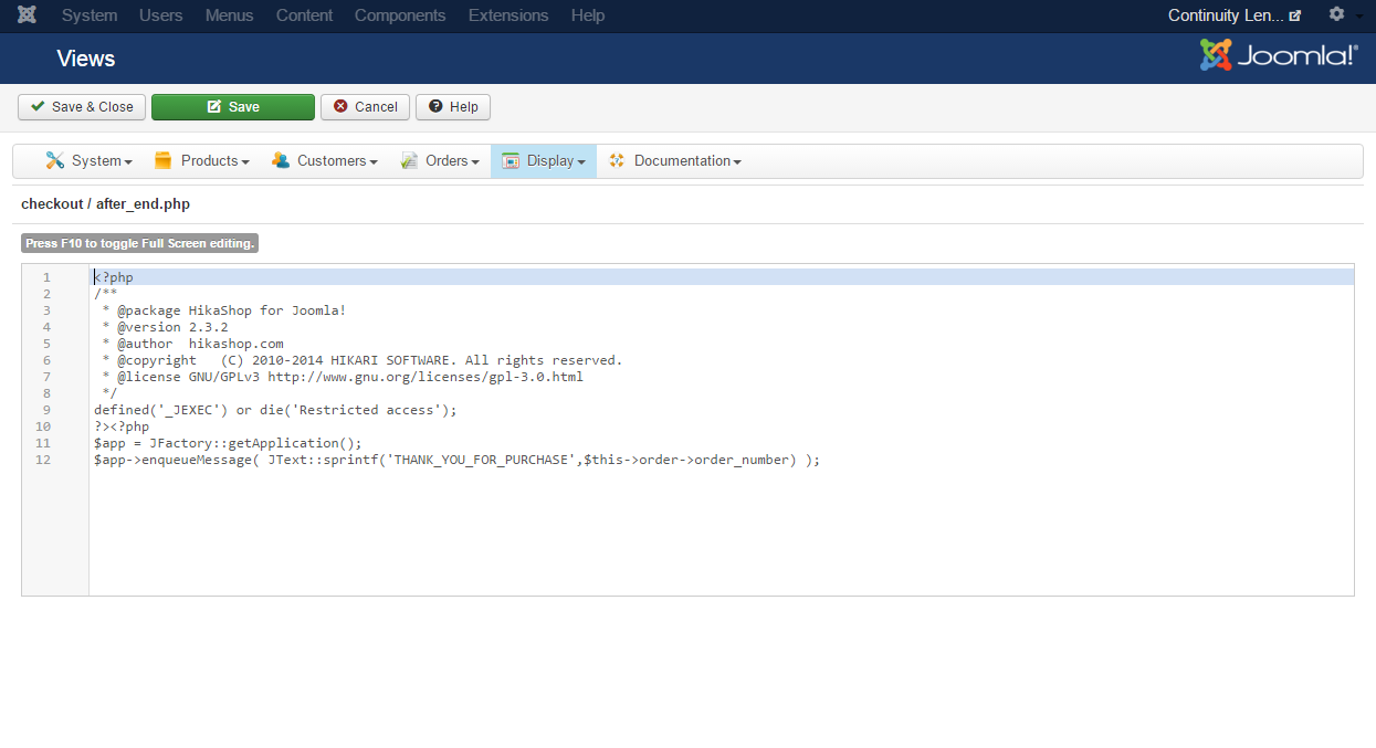

You need to edit the file "after_end" via the menu Display>Views.
There, you can easily display the order number with the code:
$app->enqueueMessage( JText::sprintf('THANK_YOU_FOR_PURCHASE',$this->order->order_number) );
Then you can add a %s in the translation override of that message.

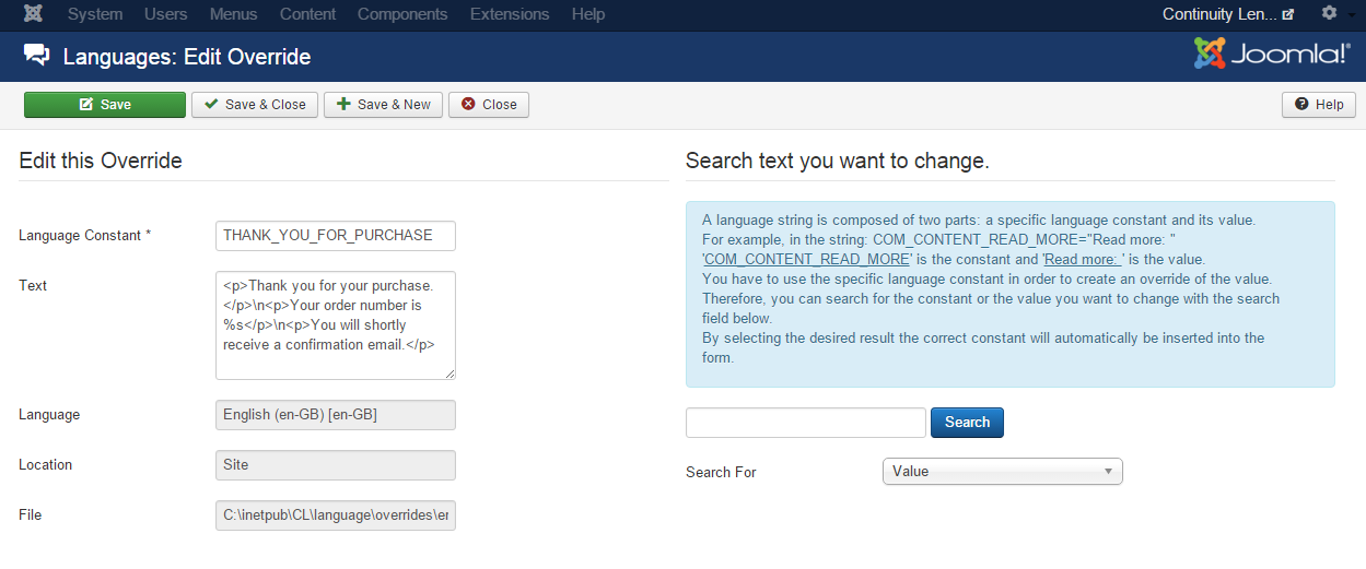

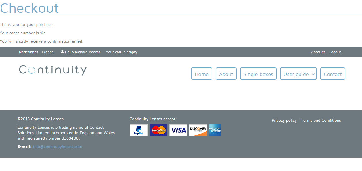

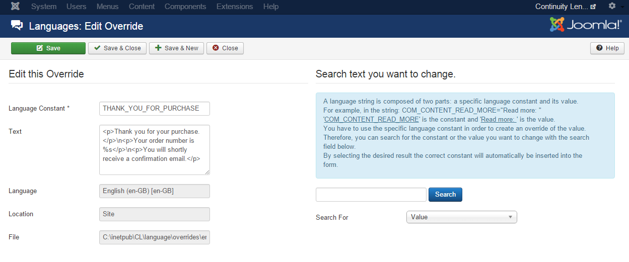

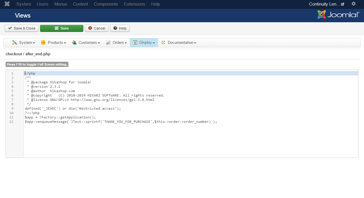

  • Posts: 35
10 years 6 months ago #230496
Hello Nicolas,
We've followed your guidance below (see screenshots - After_End PHP and Language Override).
Unfortunately, the override is not working (see screenshot language override - frontend) as we still see the %s (not the order number) in the message. Does everything look OK in the screenshots to you?

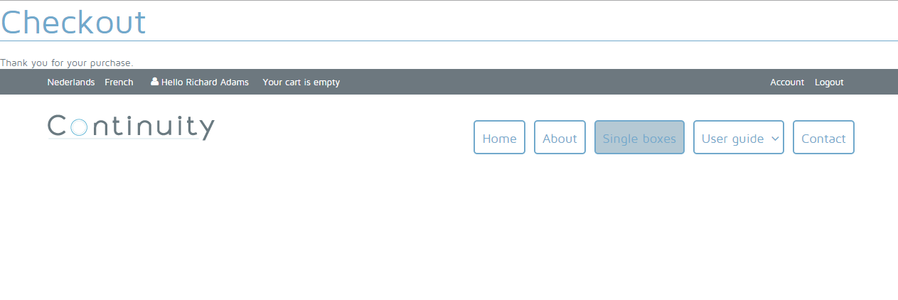

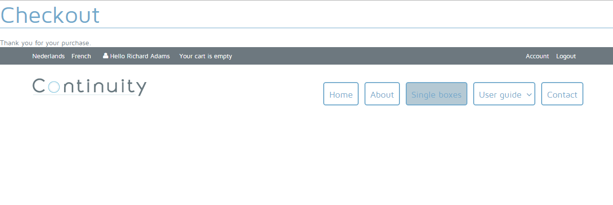

Interestingly, the THANK_YOU_FOR_PURCHASE override displays above the top bar which we do not want. We're not sure why this appears here and not in the main body of the page? Do you have any thoughts why this is happening?

  • Posts: 86101
  • Thank you received: 14203
10 years 6 months ago #230498
Then it means that you've edited the "after_end" view file for another template than the template you're using on your frontend.

  • Posts: 35
10 years 6 months ago #230620
Hello Nicolas,
We're pretty confident the changes have been made to the correct PHP file (see attached).
I have just processed a transaction but unfortunately the override is not working and the confirmation message appears above the main navigation (as per screenshot from previous message).
  • Posts: 86101
10 years 6 months ago #230627
I see but I don't see any other reason.
The JText::sprintf function if a Joomla function that is used all over the place and it works.
The override of the translation has been done properly too in the Joomla language manager as far I can see.
So the only reason I can see is that the file that is edited is not the correct one.
Try to remove everything from the view file. If you don't see any message anymore at the end of the checkout, you're in the good file. If you still see the same thing as before, it's definitely not the correct view file you're editing.

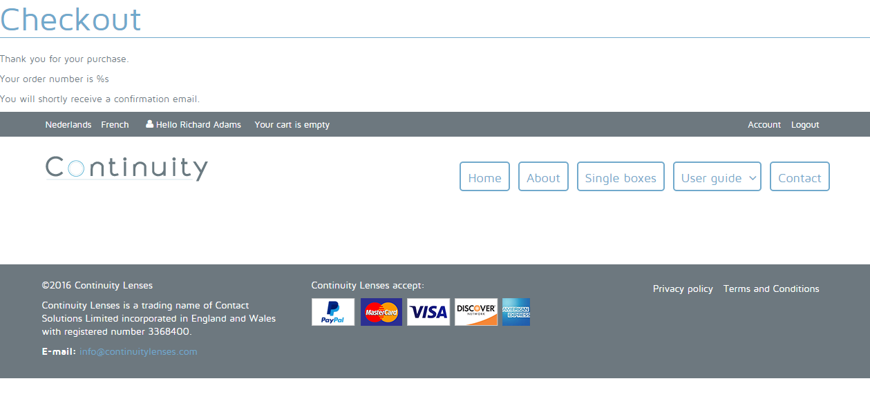

  • Posts: 35
10 years 6 months ago #231129
Hello Nicolas,
I've removed the customisation from the custom view file and deleted the language overrides.
I have processed an order and the THANK_YOU_FOR_PURCHASE message has changed so we know we're working in the correct file.
However, the message itself is still appearing outside of the template. Any thoughts on why this is happening?
Thanks,
Richard
  • Posts: 35
10 years 6 months ago #231184
I have just noticed this in the PHP error log at the same time though:
[24-Feb-2016 21:55:14 Europe/London] PHP Warning: Cannot modify header information - headers already sent by (output started at ...\libraries\legacy\view\legacy.php:216) in ...\plugins\system\jvframework\framework\extensions\layout\layout.php on line 42
Is that related?
10 years 6 months ago #231214
Yes that seems to be related on your jv template. It is integrating a framework modifying the header of the page.
So you should try with the default Joomla template, if no issues with the default one we recommend to contact your template provider for more information about that error.
