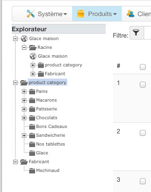

Hi, I need to remove a category that came ontop of my root. I wanted to modify a subcategory and accidently did not give it any parents... Now, it just lies ontop of my root and I just don't know how to remove it or remove the parenthood between my root and the category... The root category does not give me any parent to remove if I try to modify it.
Please help.

The category has been created before the root ? or right after root and next to the "product category" ?
If it is the second case, in the tree you can click on "root" and delete this category.

No, the category was created after the root but for some reasons, it came ontop of the root. when I click on the root to modify it, it doesn't give me any option to choose its parent and get back on the root level. see the attachment. I don't get it.

You'll have to go in your PHPMyAdmin and open the hikashop_category table. There, fix the category_parent_id of the categories:
0 for the root category, and the id of the parent category for the others.
Then, click on the "rebuild" button of the categories listing in the backend and that will fix the problem.

Suggestion was good.
We're back on track for that issue.
Thanks Nicolas
