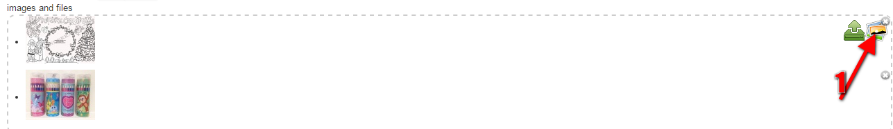

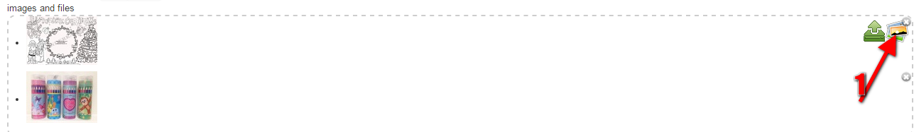

-- Joomla version -- : 3.5.1
-- PHP version -- : 5.6.20
After a update to 2.6.3 my backend is a little strange. As you can see on the image I am not able to upload new images to an existing product. When I want to click the button the hover state for deleting the image is activated. How can I fix this?

This indicates either a problem with the javascript, or with the css.
Make sure that you're using the "default" backend CSS file in the Display tab of the HikaShop configuration.
And for the javascript, make sure that the "popup mode" setting is set to "vex" in the same tab.

Problem solved by changing the backend CSS file to default. Thanks!
