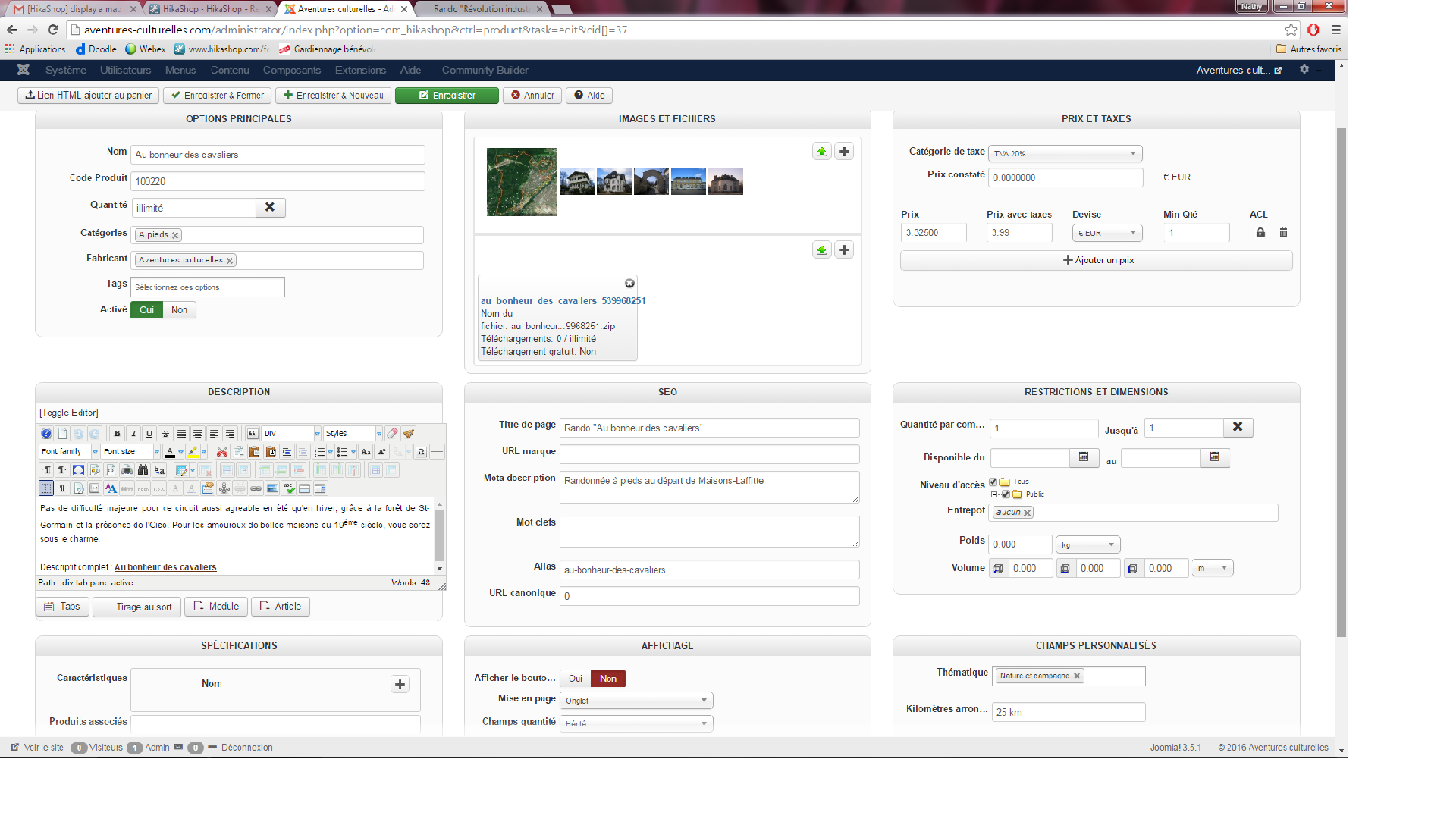

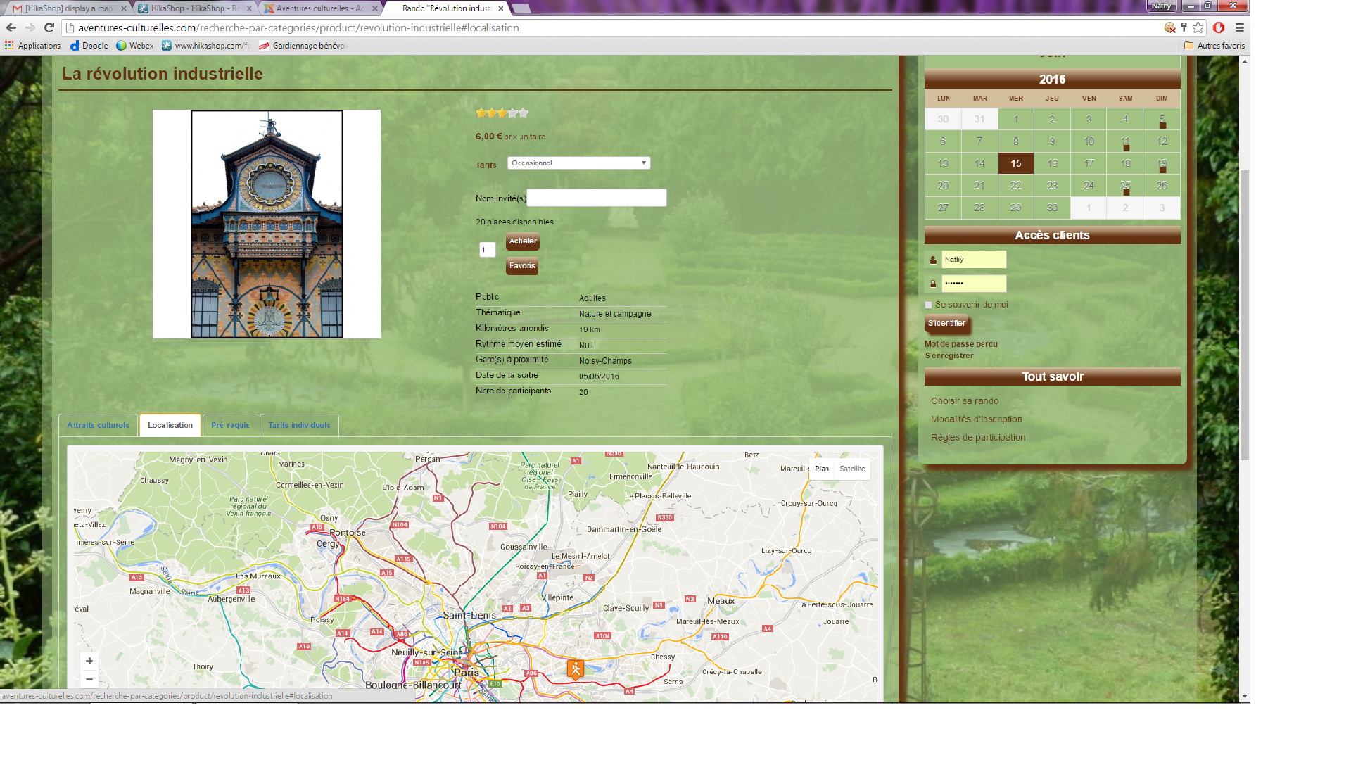

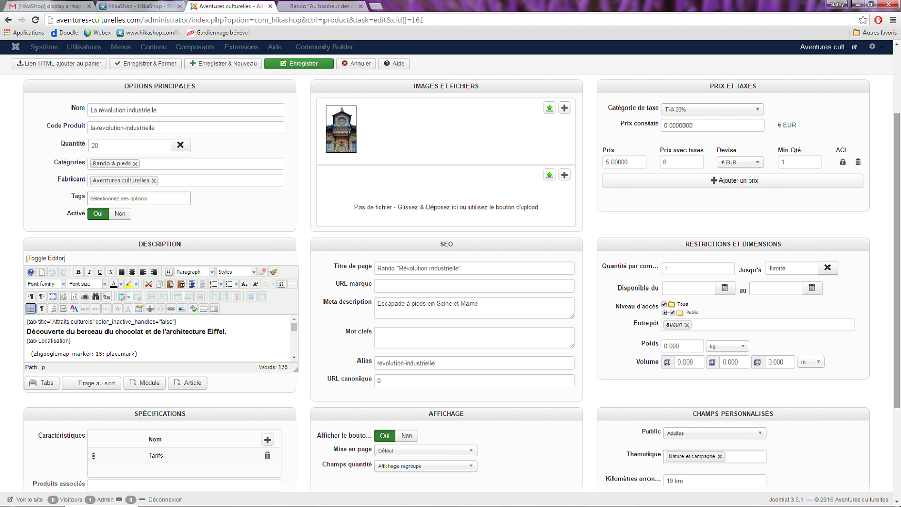

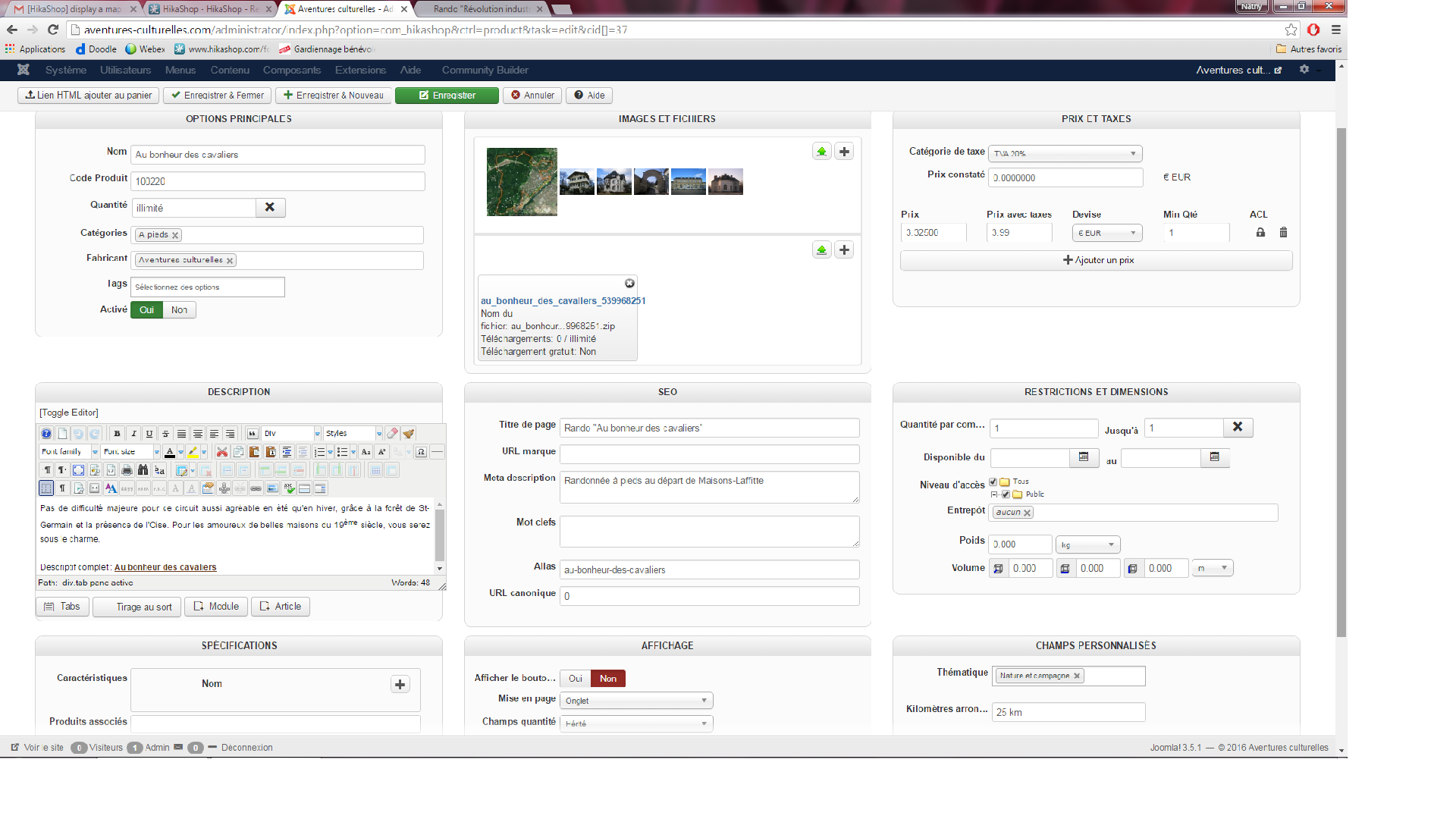

I tried different things but nothing works. Perhaps I wasn't clear enough and there is a misunderstanding. So I am going to explain what I mean in another way.
I use the plugin Zhgooglemap in Hikashop product through two ways :
1/ My product display with default custom. In product description, I manually add tabs. In one of them, I display the map I want (Let's see picture 1 for backend - picture 2 for frontend)

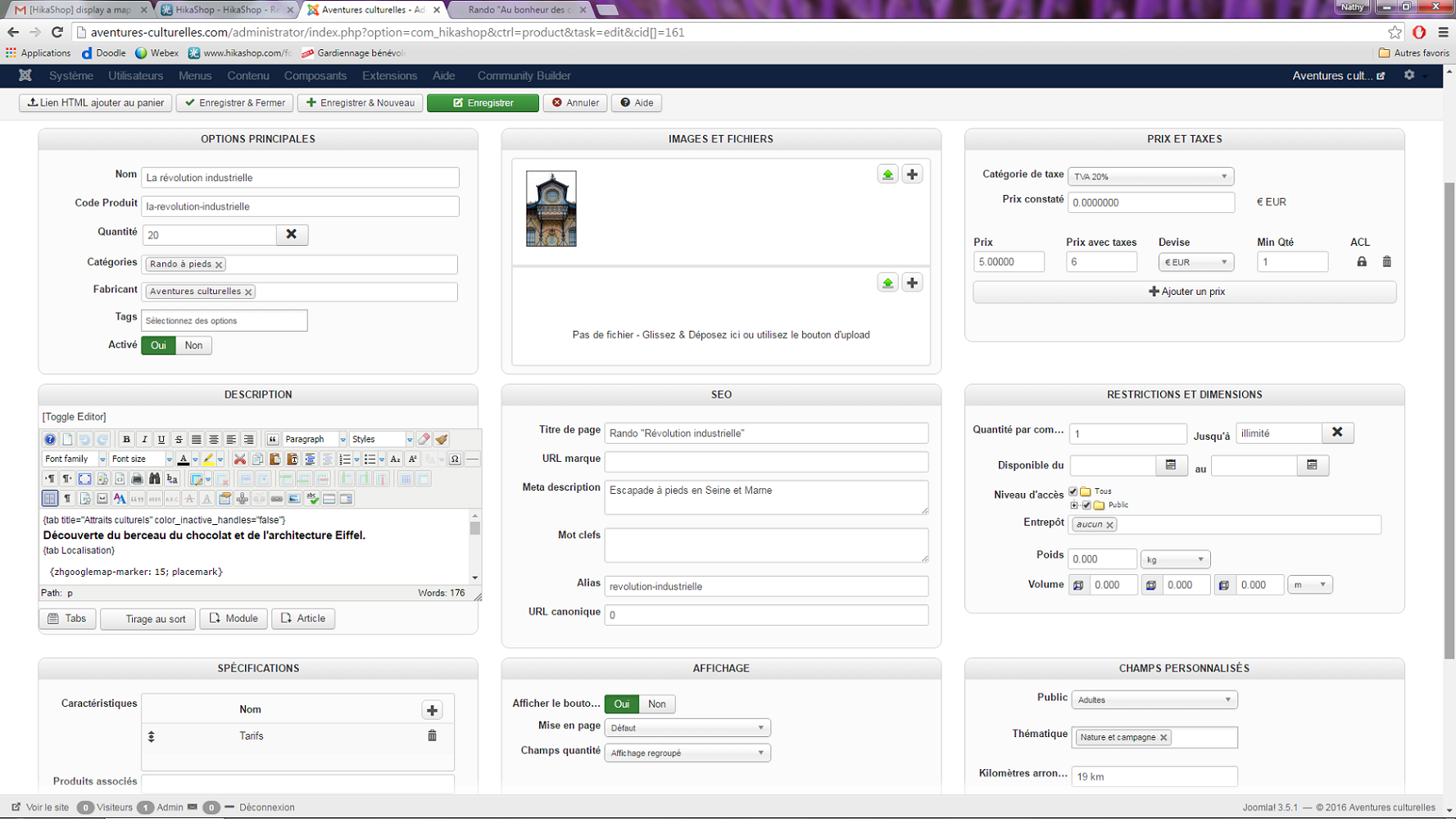

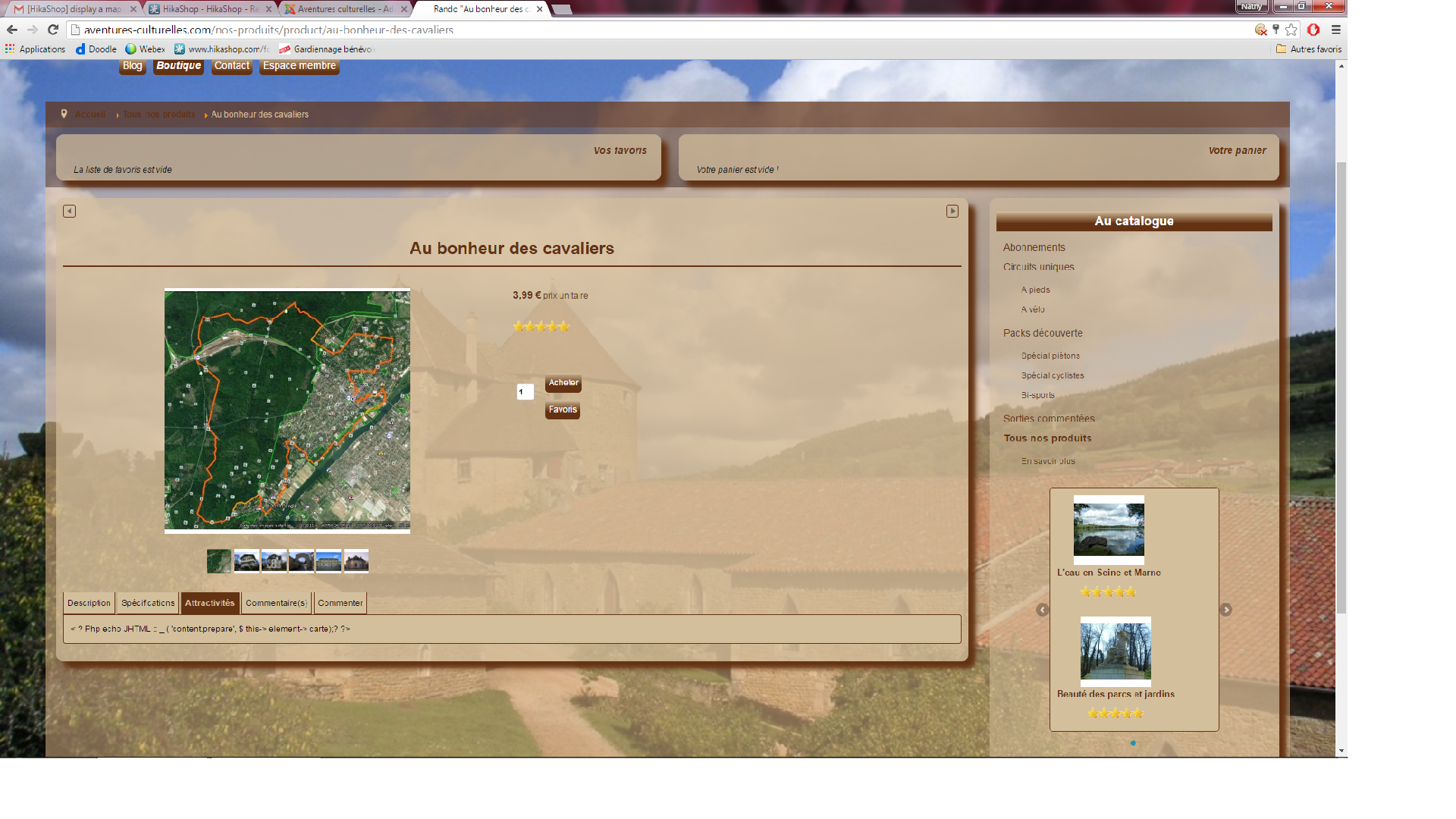

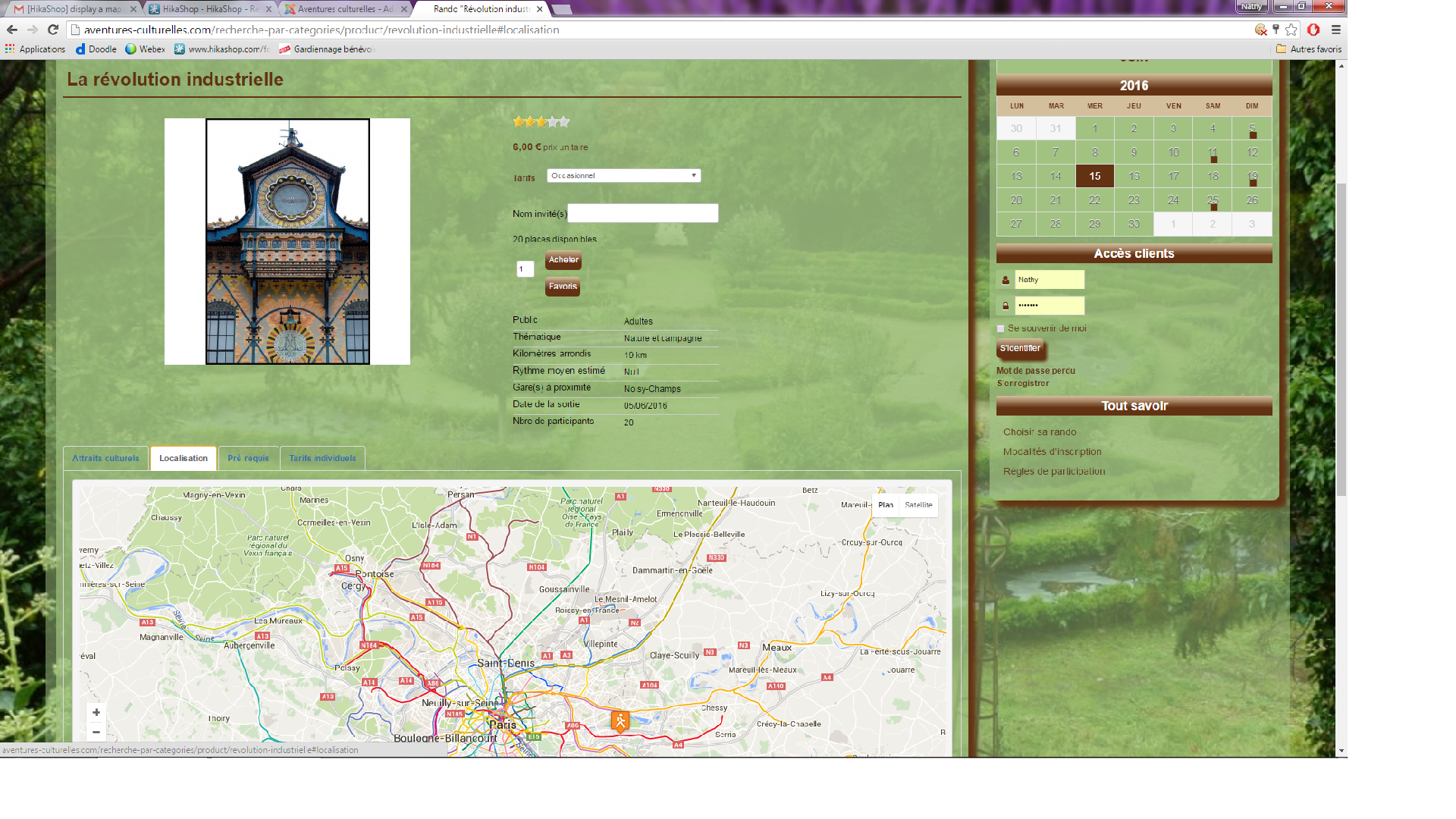

2/ My product display with show-tab custom. In the product, I have added personnalized fields (one for the map). In the view "show-tabular", I have added the code described hereunder to add a tab in between description and specifications.
In the view, if I replace
<?php echo $this->element->carte; ?>
with your code
<?php } ?>
      <input type="hidden" name="selected_tab" id="selected_tab" value="hikashop_show_tabular_description"/>
		<?php
		if(!empty($this->element->extraData->bottomEnd))
			echo implode("\r\n",$this->element->extraData->bottomEnd);
	</div>
	<div class="hikashop_tabs_content" id="hikashop_show_tabular_custom">[color=#bb0000]< ? Php echo JHTML :: _ ( 'content.prepare', $ this-> element-> carte);? ?>[/color]</div>
  	<?php if(!empty($this->element->carte)){ ?> <?php } ?>
  </div>
<script type="text/javascript">
	if(typeof(hkjQuery) == "undefined") window.hkjQuery = window.jQuery;
	window.hikashop.ready( function(){
		var selectedTab = hkjQuery( "#selected_tab" ).val();
		hkjQuery("#hikashop_tabs_div").children("div").css("display","none");
		hkjQuery("#"+selectedTab+"_li").addClass("hikashop_tabs_li_selected");
		hkjQuery("#"+selectedTab).css("display","inherit");
		hkjQuery("#hikashop_tabs_div .hikashop_tabs_ul li").click(function(){
			var currentLi = hkjQuery(this).attr("id");
			var currentDiv = currentLi.replace("_li","");
			hkjQuery("#hikashop_tabs_div").children("form").children("div").css("display","none");
			hkjQuery("#"+currentDiv).css("display","inherit");
			hkjQuery(".hikashop_tabs_li_selected" ).removeClass("hikashop_tabs_li_selected");
			hkjQuery("#"+currentLi).addClass("hikashop_tabs_li_selected");
</script>
it doesn't work. (See backend in picture 3 - frontend in picture 4). Did I do something wrong ?

  • Posts: 86101
  • Thank you received: 14203
10 years 2 months ago #243138
In your message, you say that you've added the code:
while I told you to add the code:
<?php echo JHTML::_('content.prepare',$this->element->carte); ?>
That's why it doesn't work.
