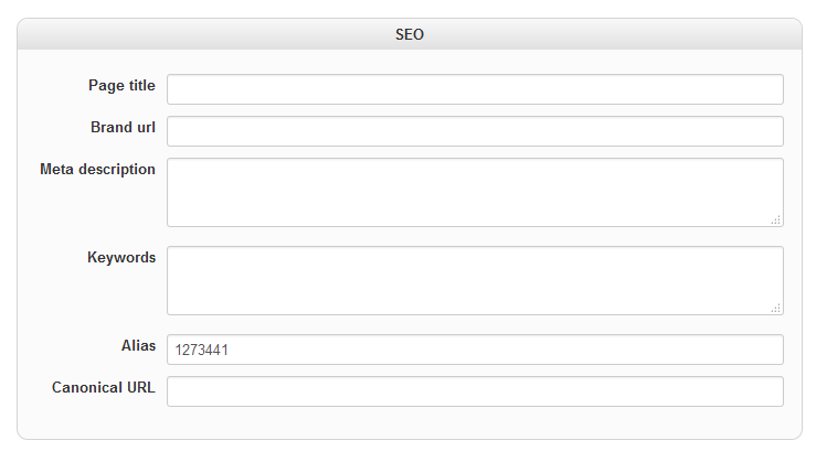

In Hikashop are over 8200 products. Aliases of all products are set like product id's over phpmyadmin. So, product with id 1273441 must have alias: 1273441
But as result, all products urls are generated wrong and caused 404 error.
Why hikashop add this "p" to product alias??? The right product url must be: viva.superhosting.bg/~indugqog/produkti/p/1273441

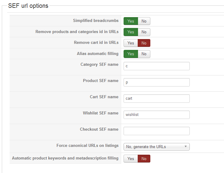

You can see Sef urls configuration on attached screens. Hikashop version is latest - just downloaded from your website and updated.

When the URL starts with a number, that number is the product ID.
If you are generating a SEF url and the alias is a number ; HikaShop must add an element so it won't mix-up between an alias and a product ID.
That is the reason why you have a "p".
If your alias is the product ID ; the best would be to remove the alias so the SEF url will start with the product ID.
