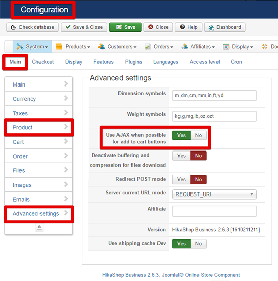

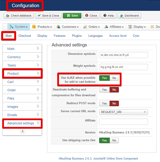

9 years 10 months ago #253801
can you try to switch on the "Use AJAX when possible for add to cart buttons" option to "Yes", see if that works ?
You can reach this option, in Components => HikaShop => Configuration, and in Main tab, go to Advanced settings to find this option.
Hope this will solve this point.
